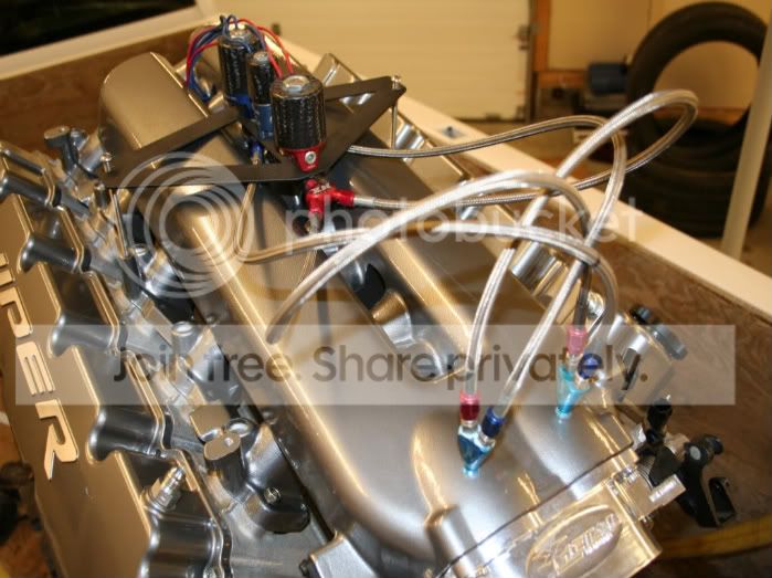

Heres my setup, Justin built it.

I'm sure you won't have any problems with Justins set up,he uses it himself! Very well made and looks killer when he is done!

Your going to want to research the system that I have, Im sure jbm can supply the parts but you will want to spray the propane vs 98 octain for the fuel.. 140octain and it flows as a gas vs a liquid, that way there is no starvation to the back cyl's and the angle of the intake and ports do not matter,, much much much safer than normal set up..
