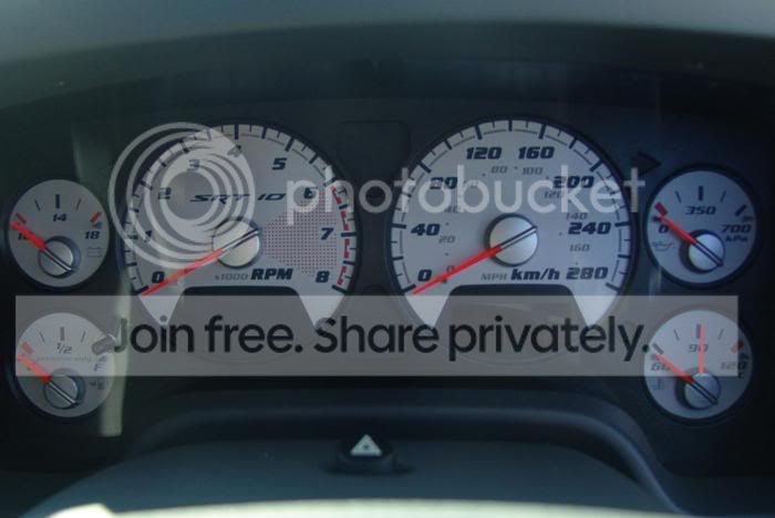

Holy crap, is it that bad!?! Yikes, OK then, well, my truck hasn't gotten that hot yet to pull timing. My gauge gets up to around the mark below, which I'm guessing is around 95c (ish) which is 203F. That's after around 20 minutes normal driving. I noticed the last time I was out that when I floored it (I wanted to see what it'd do at 200F) the temp actually dropped below 90/200F lol. I guess it forced the fan on harder? My truck will dip often below 90, around about 85c every now and then (185F) so it does get cooler at times.

Do you think it's like this because as several people have said in this thread and many others like it that our engines like the heat? :dontknow:
Aluminum engines tend to like more heat than an iron one. If the engineers said 220F thermostat was needed then so be it. What matters to me is the fact my cooling system can't maintain a steady temp under many conditions. Conditions that I feel are not too extreme.
Granted Phx is a bit extreme. At a track day last summer after lunch break ambient temp was 112F. Asphalt via my IR measured 162F. Air temp at 5ft level was nearly 130F. But I can push my truck in far less extreme temps and get the water temp moving up quickly. I will admit that the ECU has only pulled timing when it was hot even by Phx measurements.
