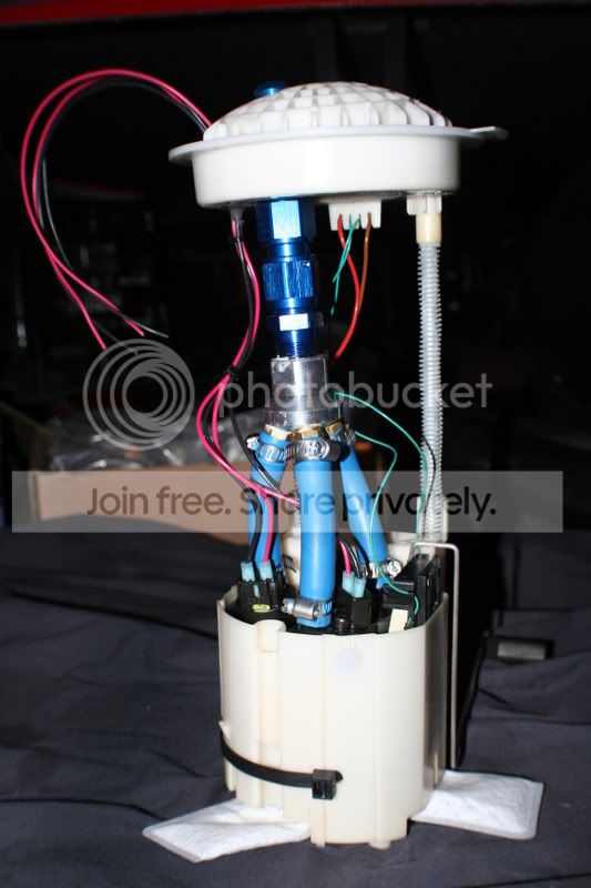

I can do the same thing if I can fit the pumps in the basket, I have not seen a basket from a durango to know. The SRT4's that I mod all the time can only hold one pump without a custom hanger.

i think ram from hell said he had a 2 or 3 pump in tank setup
Yeah. Had one done up by PBJ, and all three were wired in reverse polarity (they blew instead of sucked). Once I rewired accordingly, they worked fine. No problems yet with running low on fuel, since these pick up where the factory pump did. Also routed my return line carefully (sprays toward the front of the tank after the pickups), so as not to aerate the fuel when it comes back into the tank.
Once you have installed the triple pump does the MPG in the overhead display still work? It doesn't have to be 100% accurate I just like watching mine drop from 18MPG to 2MPG when I bring on the BOOST.

yes it still works :burnout:
