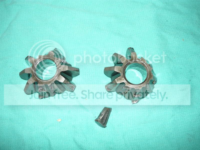

This picture is of the top and bottom spider gears after running at the track with slicks. Some thing for all of you DIY'ers out there. To remove the rear axles you will need to remove wheels, calipers, rotors, and expand the e-brake to be able to slide the axle in far enough to be able to remove the c-claps holding the axles in place. To be totally honest with you guys I really don't know how I was able to drive the truck home in this condition.
