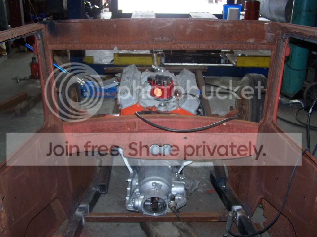

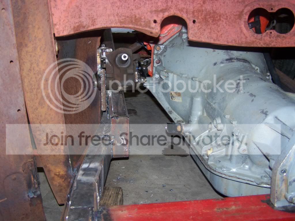

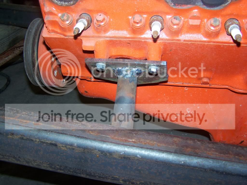

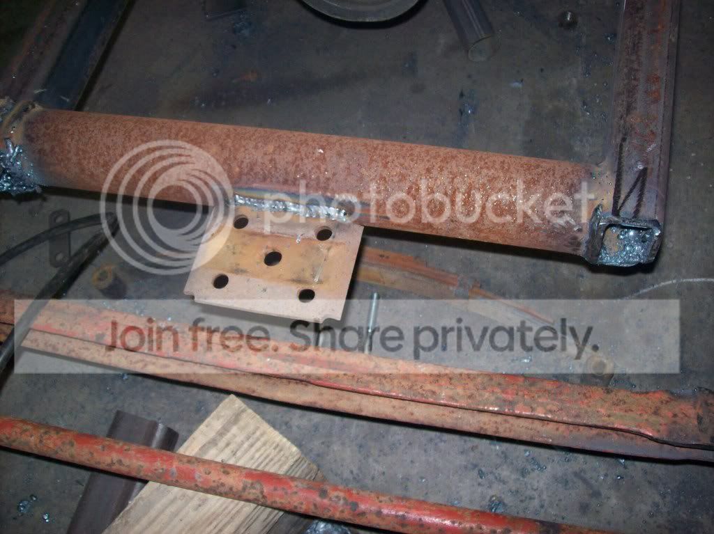

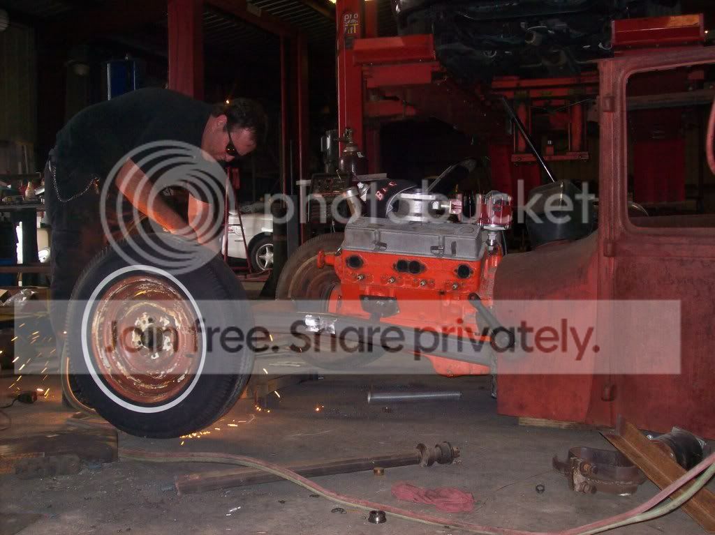

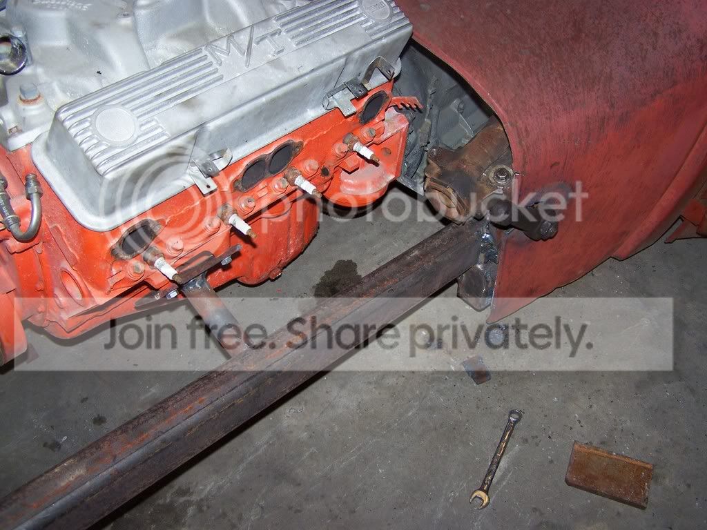

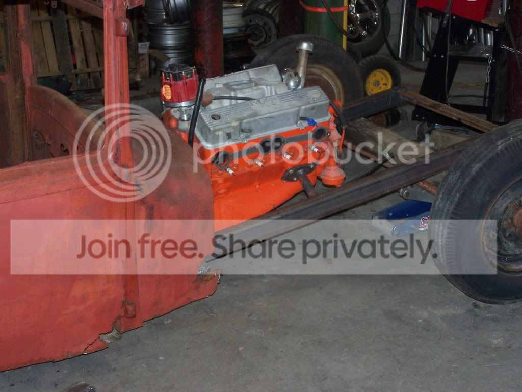

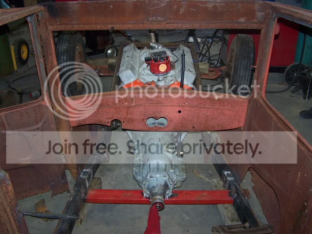

A little progress. Mounted the steering box, welded the motor mounts in place, built a transmission cross member, and welded and boxed in the front frame rails. Enough for one day!

will the motor be "OK" with the mounts welded in place...shouldnt you get some poly's to give it some wiggle room? for the engine to wiggle???

my friends who build these things pretty much all day long at "GasMonkey0" they also use solid mounts for their motors... not sure why? only thing i can see goin wrong with them being solid would be a HIgh HP motor twisting the frame
Yeah I am definintely going with some wide white walls. The car shouldn't have all that much HP. Plus I am not going to be driving it more than 10 or 15 miles at the time. I like the "put a bunch crap laying around the shop together and drive it" look.

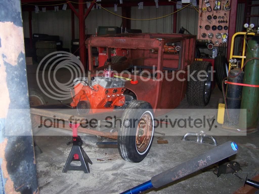

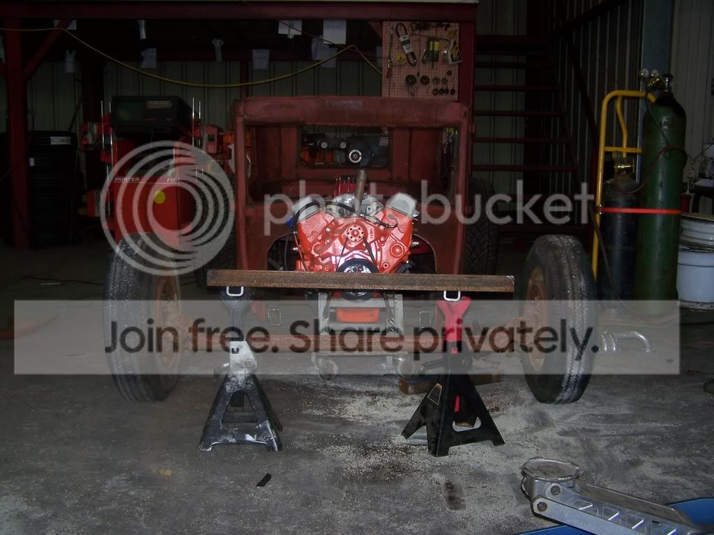

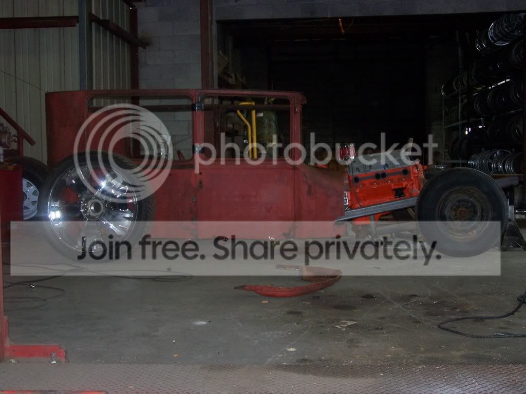

Almost got the thing rolling around today. Worked about 5 hours on it and here's what we accomplished.
This is what it looked like when we started working today....
And here is our stopping point.....

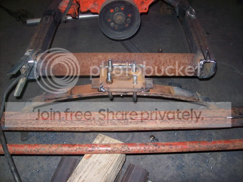

Just ran out of time to attach the leaf springs to the axle. And add the trailing arms from the axle to the frame.

yeah thats how i always looked at them, how are you gonna do the driveshaft? i would think you;d need at least 2 shafts? not sure one would be able to work at such an angle. i'm wanting to build one too been lookin at an old chevy grain truck thinking of a way to cut it up...
Dad says a couple of constant velocity u-joints will take care of it. We'll see in a couple of weeks.
