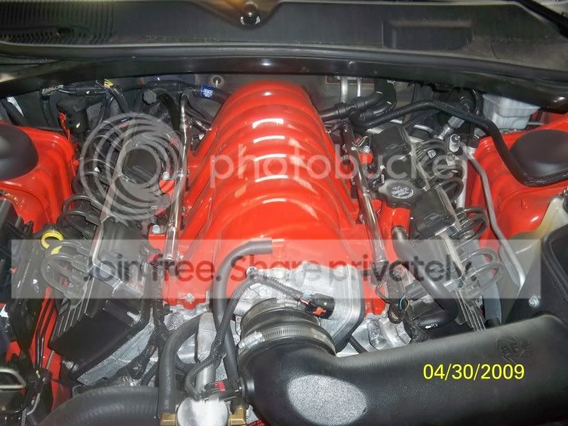

What do you think about this. The other day I watched a 426 Hemi Callenger get on a dyno after a drive from Louisiana. He got right on it and made a dyno pull at 460HP. The builder of the car asked me to rest my hand on the intake. I could have kept it there all day.......... it was warm but not hot. It has a polydyne or something coating. A coating on the inside to keep heat out and a coating on the outside to disapate the heat.
I did this on my SRT-8, same intake with out this coating and I could only keep my hand there for a few seconds.......
On the Roe, after 15 mins with the blower on it, it was still HOTTER then my stock srt8 manifold after a 20 min drive............ The roe heatsoaks more then the srt8, and 8's are known for heatsoak problems.
What would you think about, along with your cooler having the intakes coated for heat????? Hit both sides of the problem, cool it and keep it from getting hot.
If you are interested I will get the info........ I'm in crisis mode to find my horsepower :)
