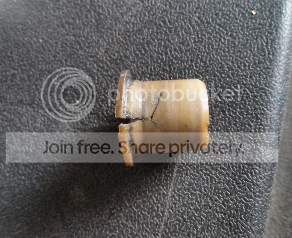

never had a shifter do that chanic, ever, it honestly shouldn't be in the shifter, it could, but I have never had that honestly, to me it almost sounds like the bushing in the trans mount lever, its down in the trans, check the ball part on the lower half of the shifter, in the trans there is a bushing that it sits in, check both of those and let me know

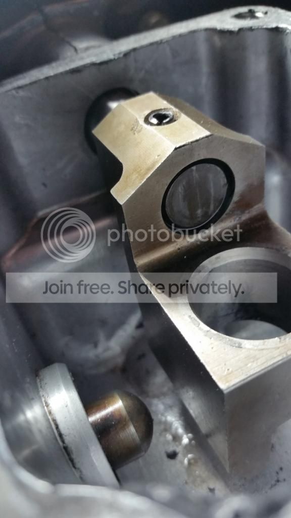

Throw the B&M in there and see what it does. Get video of the bottom of the shifter that's in it and the opening in the transmission, while you are in there.
Thats what i'm gonna do. Will post the video and pictures tomorrow.
That would make sense Tony. When i was installing the shifter i think i noticed a little crack in this bushing. Will double check it tomorrow. I hope that's what it is. Thanks for keeping my hopes high.. :)
Finally got into it. Here's what i found.
Nothing but the cub/isolator is broken or cracked. Found some oil on the bottom...don't know if its normal or not
upgrade to the bronze bushing while you're in there.
