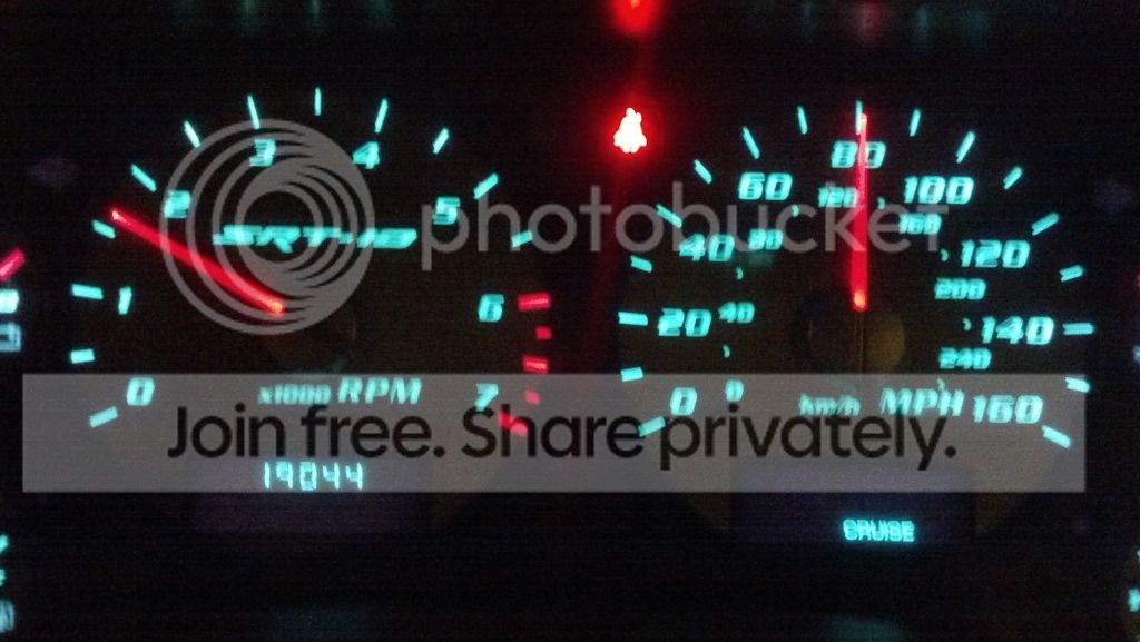

My truck has stock size tires (305-40R22's)
I was out today and I got 1950 rpm @ 80 mph. I was going to post on your thread for yor info.

everyway i do the math on your truck cody it says it has 3.73 for a rear end
Me too, Cody. Check your RPM in 4th gear for a couple different speeds and I bet the numbers work out for a 4.10 though.
