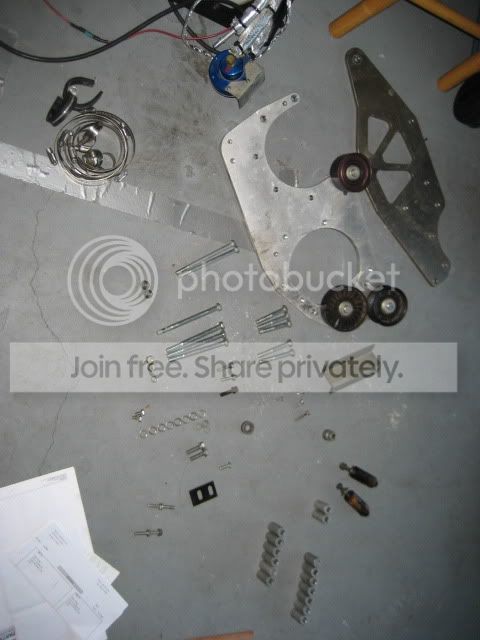

Well I laid everything out today and it looks like the main components are there. But just in the blower mounting bracket, there are about 10 bolts missing and a couple of spacers. All the parts for the oil feed and oil return, are missing.And I'm sure I'll probably find a few more missing as the install continues. Now before everyone starts jumping on Gregg for stating that the kit included "every nut and bolt". I truely believe he thought it included every nut and bolt. But he didn't install the kit, so he really had no way of knowing.:dontknow: I figured I might as well post some pics showing the progress, in case someone else installs a used paxton. Maybe it'l help.
Here are pics of the kit laid out. Go ahead and chime in if you see something missing. The kit did include the fuel pumps, FMU and split second controller. I'm not using them, so I didn't include them in the pics.

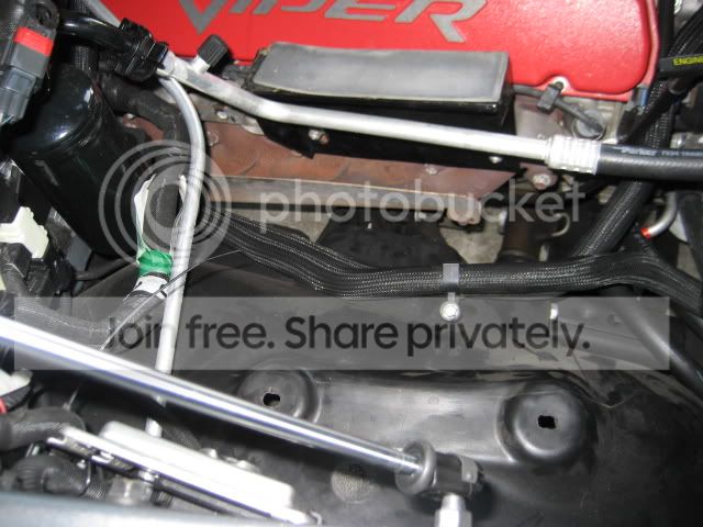

And here's my progress today. Battery box removed, air deflector removed, water box mounting bracket installed and colder spark plugs installed.
