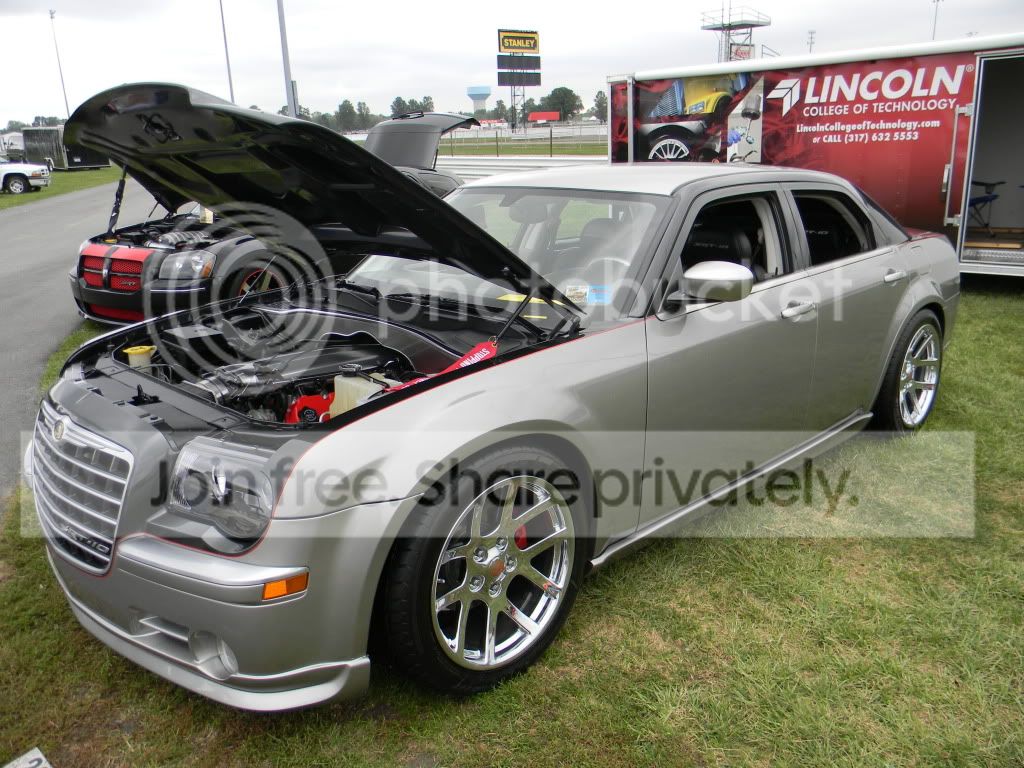

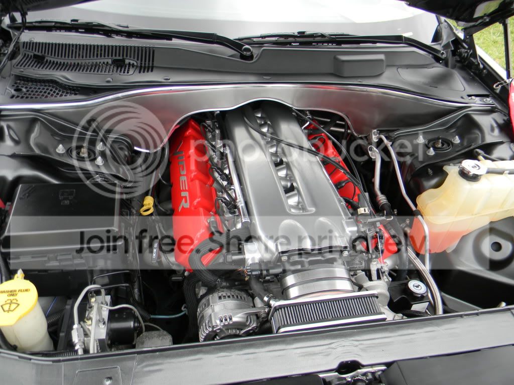

The gen III does look sweet inside an LX platform....
The funny thing is there's way more room on the sides of the engine than with the Hemi lol. Part of why I am doing that instead of a hemi swap into my Van! :)
