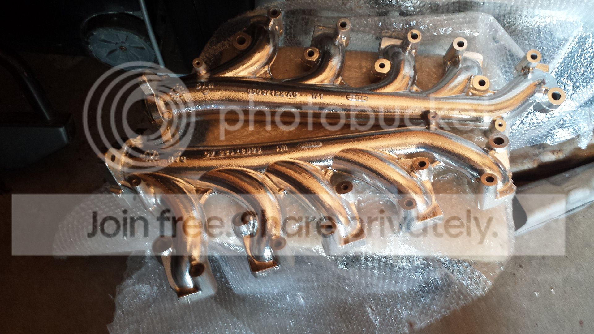

First up - ceramic coated OE manifolds
[URL=http://s1219.photobucket.com/user/cdarnell1975/media/SRT10/20150925_154908_zpseuofrs0s.jpg.html][/URL]

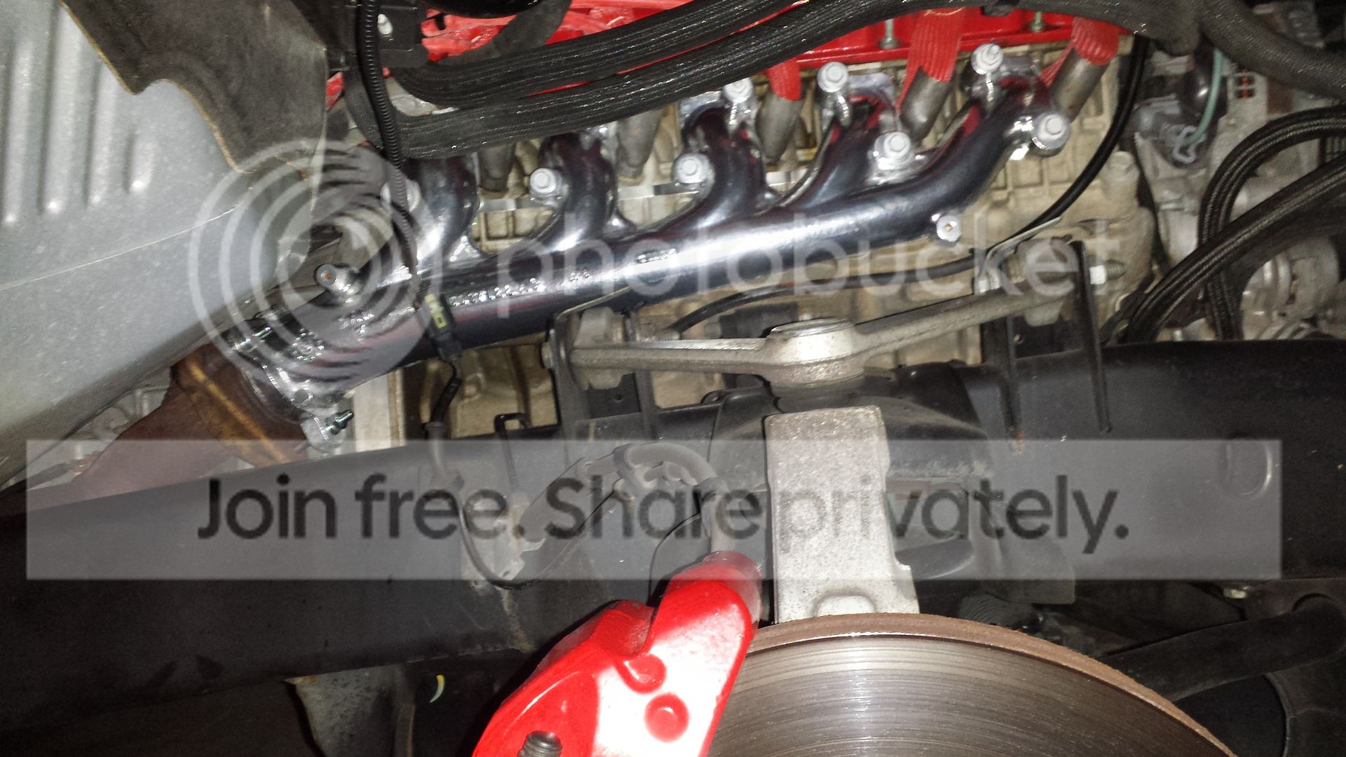

BTW...cage nuts suck. I ended up cutting most of the flange bolts off
[URL=http://s1219.photobucket.com/user/cdarnell1975/media/SRT10/20151010_185119_zpsvylzt6no.jpg.html][/URL]
[URL=http://s1219.photobucket.com/user/cdarnell1975/media/SRT10/20151015_111755_zpslarrsawc.jpg.html][/URL]

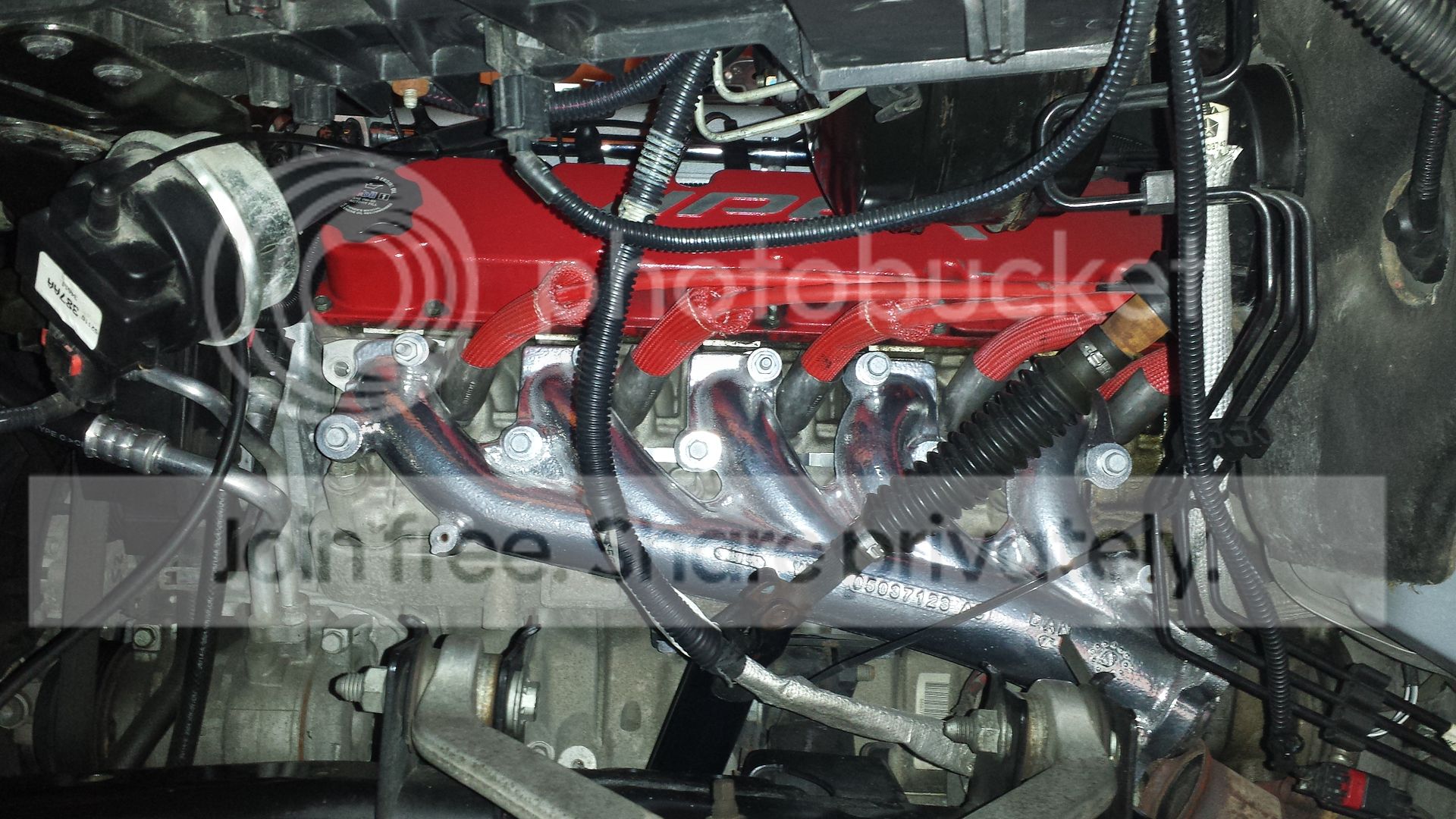

With that finished, moving on to the engine bay.

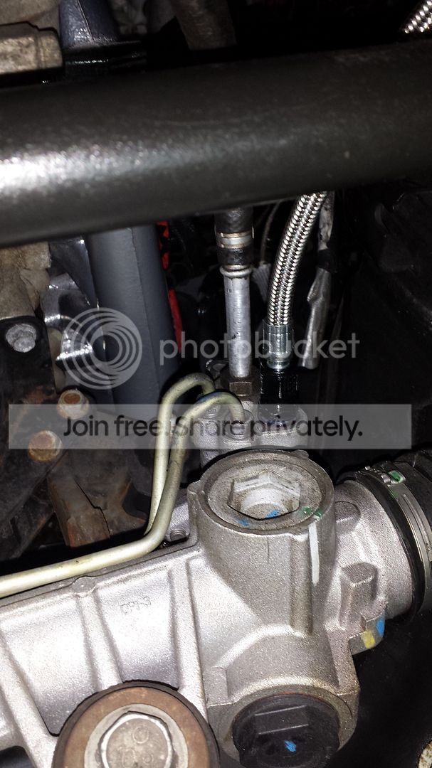

So i got home from work today and it was really beautiful out. My wife really wanted to go out to the park for a walk, but i said f**k that! I'm changing power steering lines!
My new best friend...seriously.
[URL=http://s1219.photobucket.com/user/cdarnell1975/media/SRT10/20151104_184114_zpsahf4xn5b.jpg.html][/URL]
Whoever said you need a crowsfoot and a breaker to do this definitely wasn't lying.
I did the work with the truck on jack stands, and was afraid i was going to break the fan shroud getting the pump side fittings loose.
A little careful heat and they came right out though.
New fittings went in like butter.
And I've now proven to myself that i am physically incapable of not scratching the shit out of anodized A/N fittings...
[URL=http://s1219.photobucket.com/user/cdarnell1975/media/SRT10/20151104_192726_zpsju7ywf9c.jpg.html][/URL]
[URL=http://s1219.photobucket.com/user/cdarnell1975/media/SRT10/20151104_191132_zpsyjkpqvkk.jpg.html][/URL]
[URL=http://s1219.photobucket.com/user/cdarnell1975/media/SRT10/20151104_192749_zps7xwmbj5b.jpg.html][/URL]

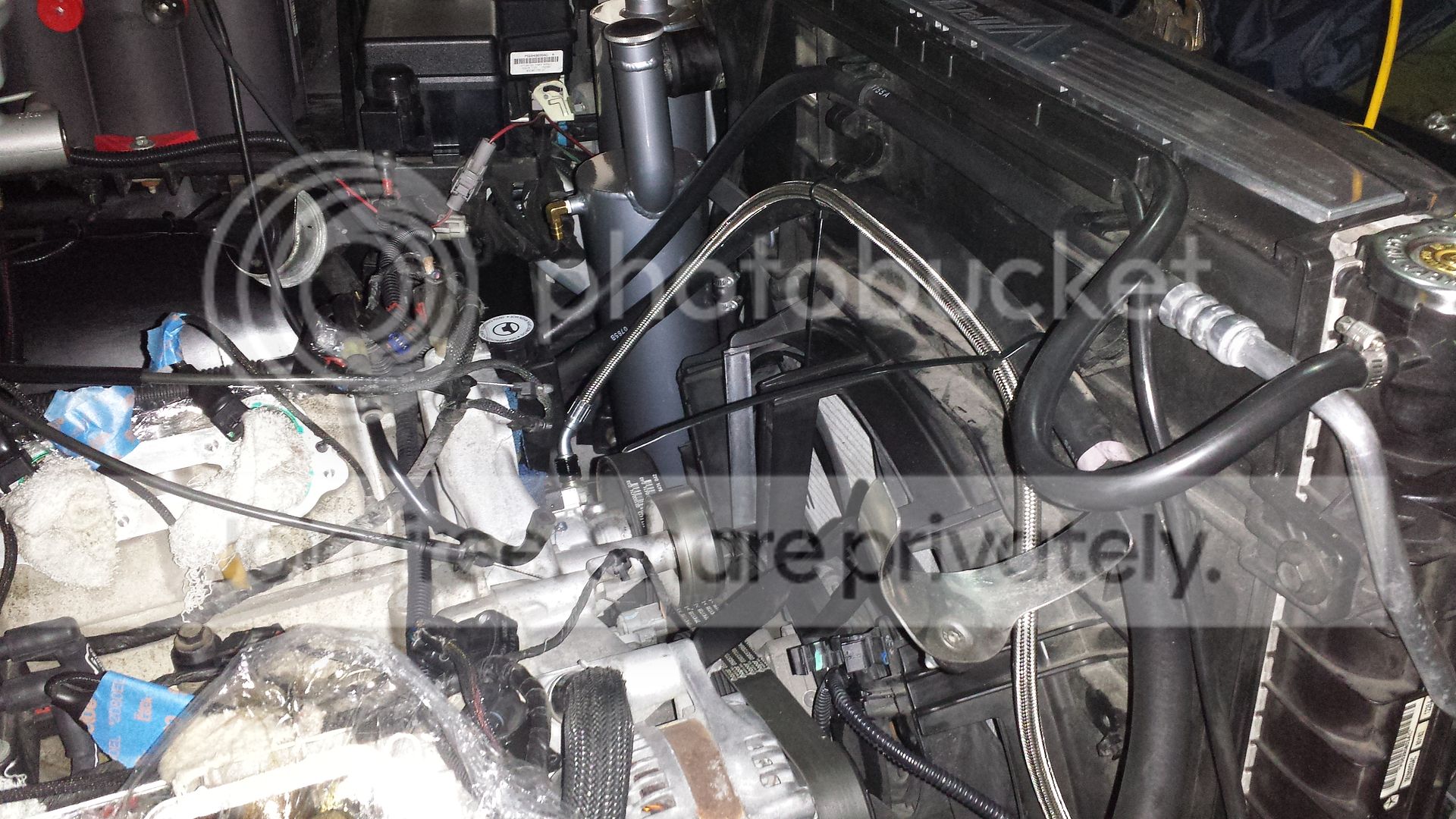

Still have to do the final routing of the hose, any suggestions? I may drill holes in the fan shroud to secure it with zip ties.
[URL=http://s1219.photobucket.com/user/cdarnell1975/media/SRT10/20151104_195346_zpsznsuzra2.jpg.html][/URL]
Only part that really stinks is that i can't bleed and test until i get the engine back together.
I'm not worried though, the spring and plunger are in, and Tony's kit is primo quality ;-)

So about the lines...
Drain the reservoir
Start at the bottom with the rack.
Bring an oil tray with you down there and some rags.
Disconnect the hose from the rack
After you drain the ps fluid from the old hose, spin the fan by hand for a minute or so and it'll pump out more fluid
Then disconnect the other side of the hose from the fan.
Put your fittings in and tighten, then put the new hose on.
If you don't have a crowsfoot, stop here till you get one.
Pop open the hard line retainers with a screwdriver on the pump side hose.
Remove the pump side fitting from the fan.
Mine was REALLY on there, so i broke out the propane torch and VERY CAREFULLY heated it up, trying as hard as possible to not cook the fan shroud or the belt. Its do-able. After that it broke loose with the help of a crowsfoot, an extension, and a breaker bar. (There will be oil oozing out of this one)
Now go topside and use the crowsfoot to take off the fitting from the pump.
Again, mine wasn't going anywhere, so i broke out the torch. Heat this one with a few seconds on, then try it. Keep going till it breaks loose...don't melt you reservoir obviously.
After its off, have fun getting the line out without spilling fluid all over the place :)
Put the new fitting in with a socket and a u-joint on an extension (i used a 1/2 inch drive, deep enough for the fitting, but still cleared ok. I doubt a deep socket would fit in there)
Make sure the plunger and spring are still in the pump after you take the old fitting out, otherwise the system won't purge later.
It's pretty easy. Took me only a couple hours by myself.
