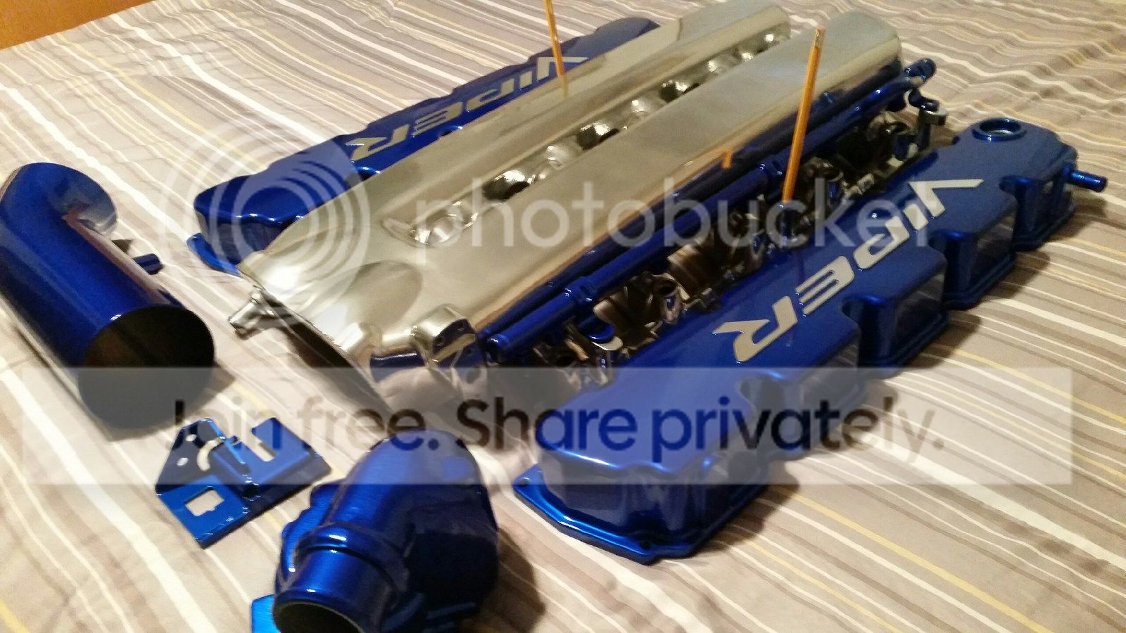

Still working on the alternator project, but along came a nice surprise!
[URL=http://s1219.photobucket.com/user/cdarnell1975/media/SRT10/20151120_164035_zpsdgipb11j.jpg.html][/URL]
[URL=http://s1219.photobucket.com/user/cdarnell1975/media/SRT10/20151120_164133_zpsy9c2rn2o.jpg.html][/URL]
Let me just say, i am SO glad i used Justin for the powder coating. Everything is beautiful, no cleanup work to do, no excessive sandblasting, no media residue. Everything is ready to bolt back on.
Looks amazing too. You could probably swim in the finish!
Thanks Justin!
