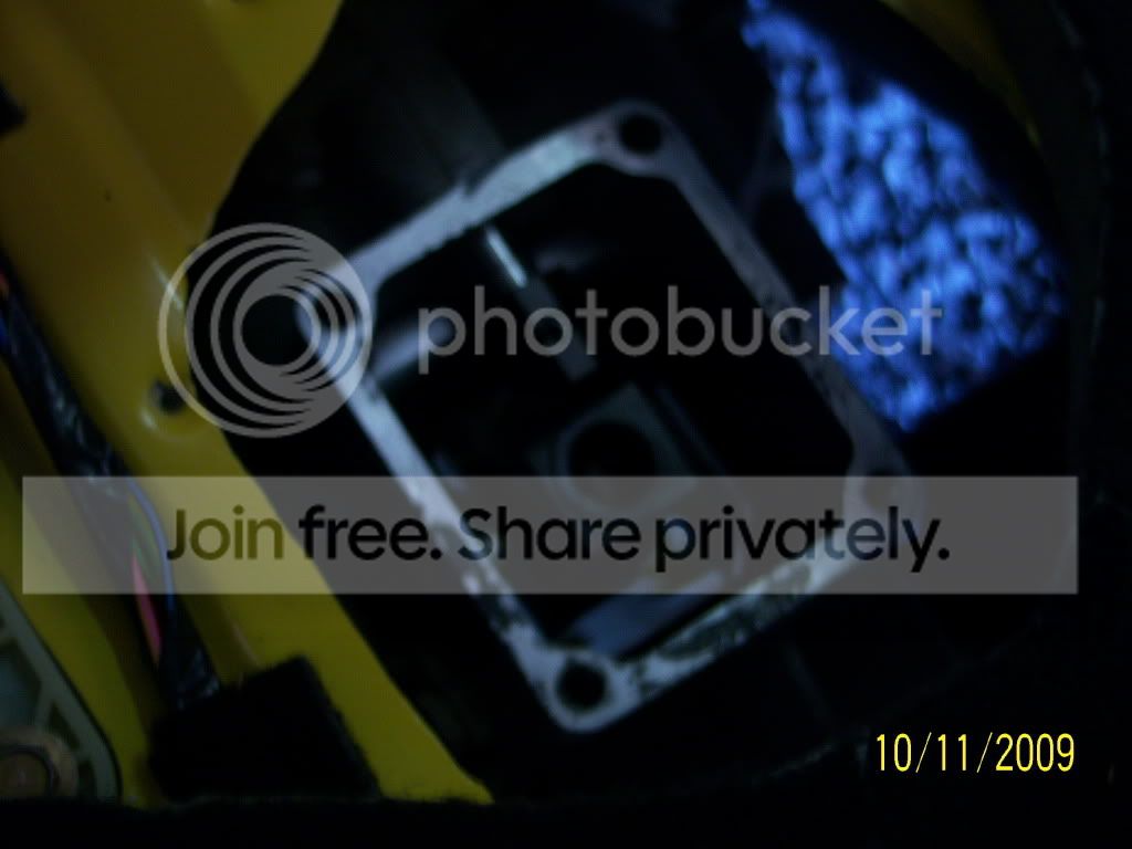

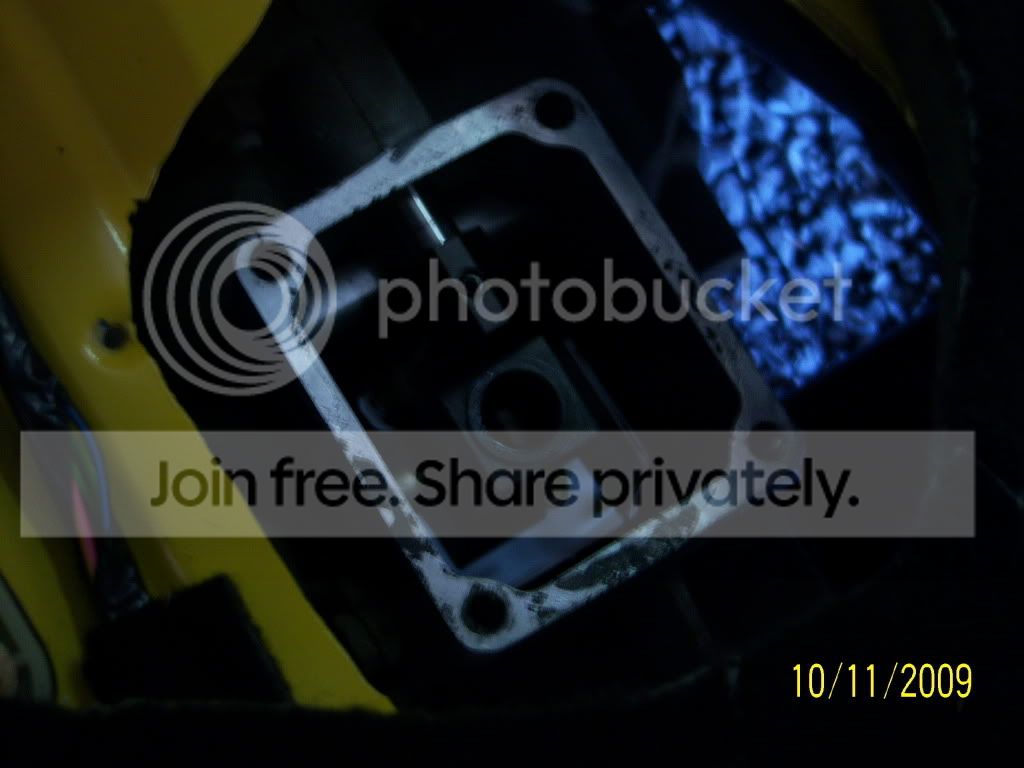

i removed the shifter and tooks some pictures :) there uploading now will post in a min
Check the bottom of your stock shifter, mine was white plastic peice that went in that hole. Unless someone put the bronze bushing in.
there was nuthin on the bottom of the shifter - i bought the truck new, and this is the 1st time i removed the shifter :)
let me walk out to the GAR and look around maybe it fell off :)
Put the shifter in the hole if it is snug then that is it. I think I know whats messin with you is the play in the twist, when you put it in gear the play is in that bearing, not that its bad it is wierd to get used to.

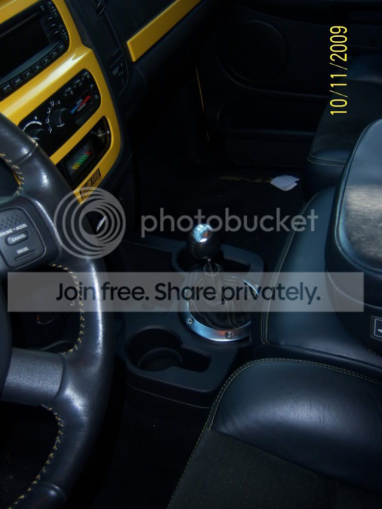

installed :)
x-metal Shifter installed :D :D :D :D :D
i took it out on a test drive - and w0w wat a diff. :) NEVER missed 3rd and smoked " killed " a new corvette

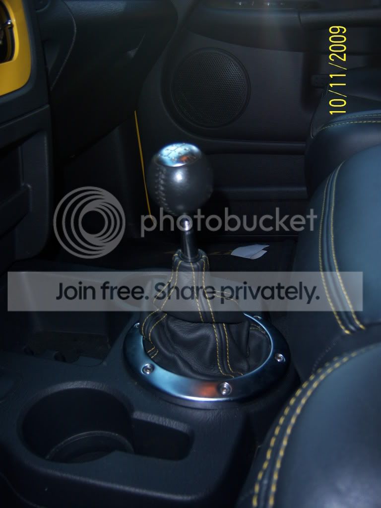

now just need the New handle :rock: :rock: :rock: :rock: :rock:
lmao - i mod'ed the Xmetal Design ;)
took 6hrs but gotta her done and it DONT " pivot " ne more and is a really tight shift ! ;)
oh and no more ' wiggle ' or play in the shifter :D :D :D :D :D :D
Awsome I have a pistol grip that would work perfect with that, now that is a short throw shifter:rock: You maybe on to something:burnout:
