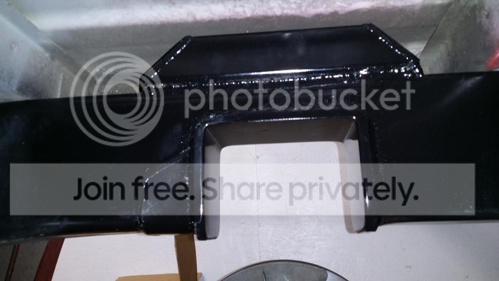

Did somebody say C-notch?
Also keep in mind, when my truck was C-Notched you have the tire hitting the bed issue as well.. So you will need to do something to fix that as well..
