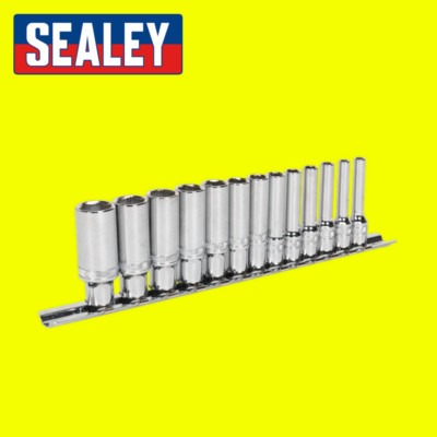

Has anybody ever used these sockets to remove a rounded bolt ?
I thinking of trying them to remove a rounded tight ask lug nut . So tight it actually started and slightly bent my 4 way lug wrench !
I’m also trying to find the size of the trucks wings bolts and possibly using the same type of socket ,, the heads are rusted and have flaked to crap . No idea if metric or not !
If all else fails then I’m pulling out the C4sucks that I’ll only ever have to use these socket sets or if I can get a single socket for 1 time ever use !
Sealey AK2747 13pc 1/4"Sq Drive Deep Lock-On Socket Set Rounded Nut Remover | eBay
Model No: AK2747. Fully polished mirror finish for resistance to corrosion. Features specially machined flutes in the walls of the socket which enable use on up to 85% rounded fasteners. Includes knurled ring for extra grip with oily fingers.www.ebay.com

Haven't used those. Have seen some with a bunch of pins in them. A 6 point socket hammered on usually does the trick with an impact wrench. I'm guessing the stud will pop if it's that tight. Anti seize new setup once you get it offHas anybody ever used these sockets to remove a rounded bolt ?

Heck c4 is faster that shipping hahahaI can't say if those (black ones) are the exact ones I used, but very similar and they did work.

I saw those , just not sure if there strong enough to get the lug nut off .. My impact gun is worthless for removing lug nuts hahaha , damn thing was only used a few times years ago . Still trying to find my breaker bar hahaha ! From what I’ve found out the socket need is a 17mm and it’s recommended the socket to use is an impact socket .Haven't used those. Have seen some with a bunch of pins in them. A 6 point socket hammered on usually does the trick with an impact wrench. I'm guessing the stud will pop if it's that tight. Anti seize new setup once you get it off
Yes the black and impact sockets seem to be recommended..I can't say if those (black ones) are the exact ones I used, but very similar and they did work.
