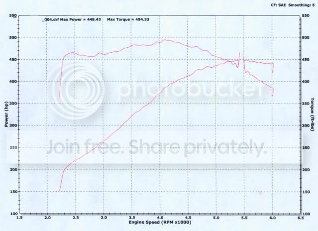

Then there's the dyno results...
Does this look like the curve of an engine with increased compression (10.5:1 ?)and a "Comp" 270 cam?

get the spec sheet and cross check the build, the numbers dont look terrible, what type of dyno.
A.R.T.'s dyno, at the TX GTG Dyno Day.
I have a another dyno sheet with another members stock truck on it with mine & they are almost identical.
