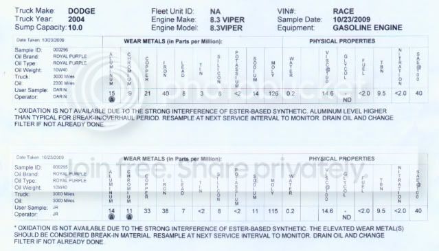

Here's the UOA I had done today...
Also did some more test on vibration, it's only in 5th gear & starts @5k rpm.
