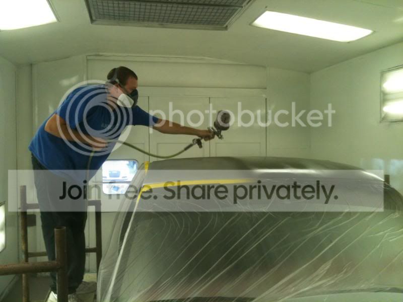

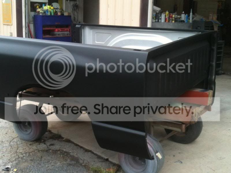

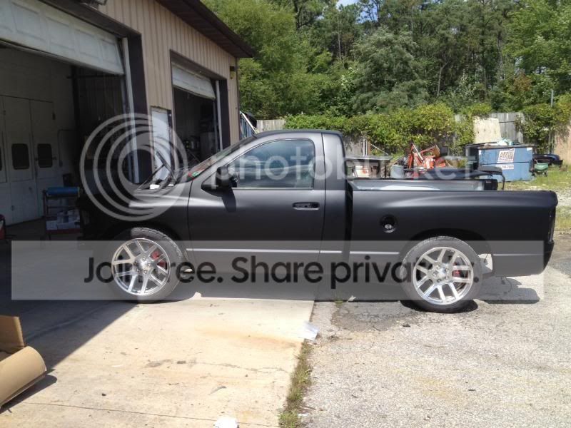

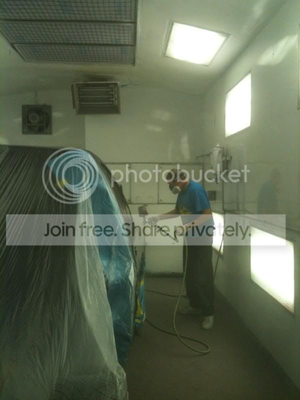

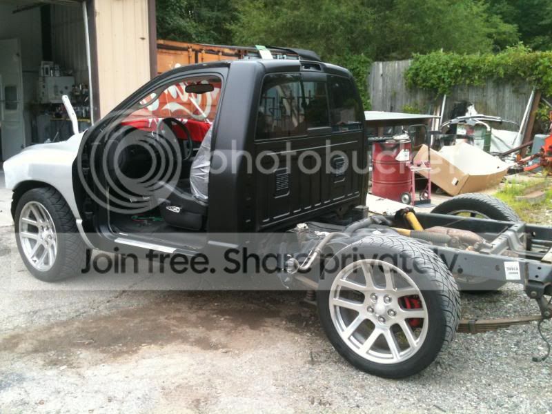

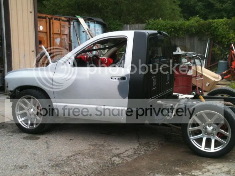

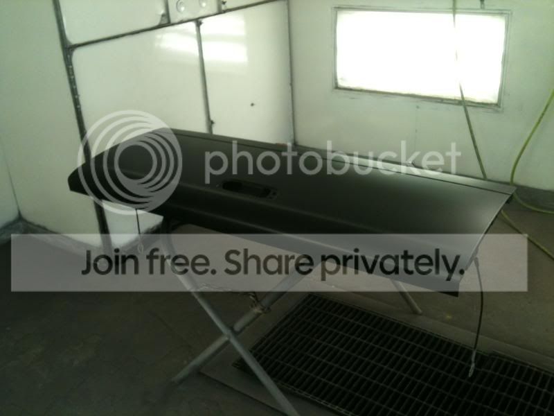

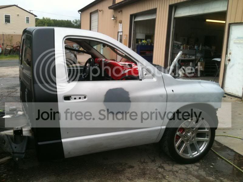

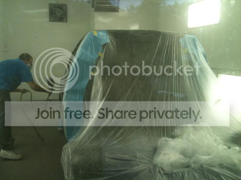

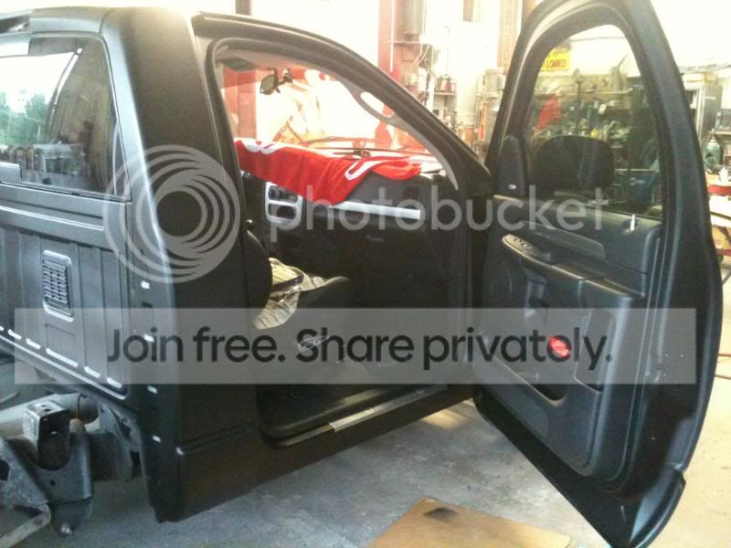

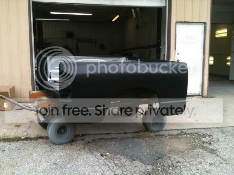

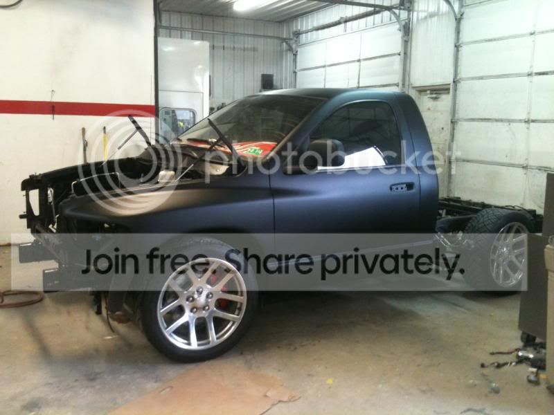

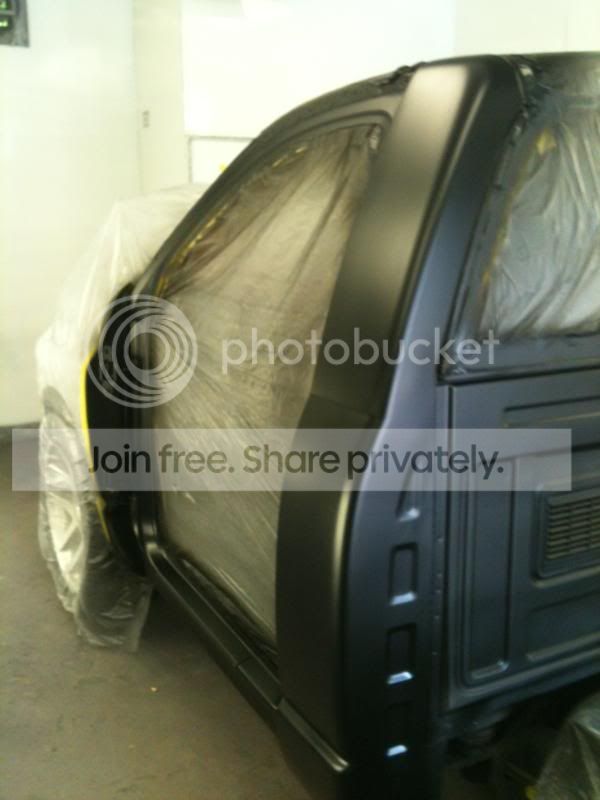

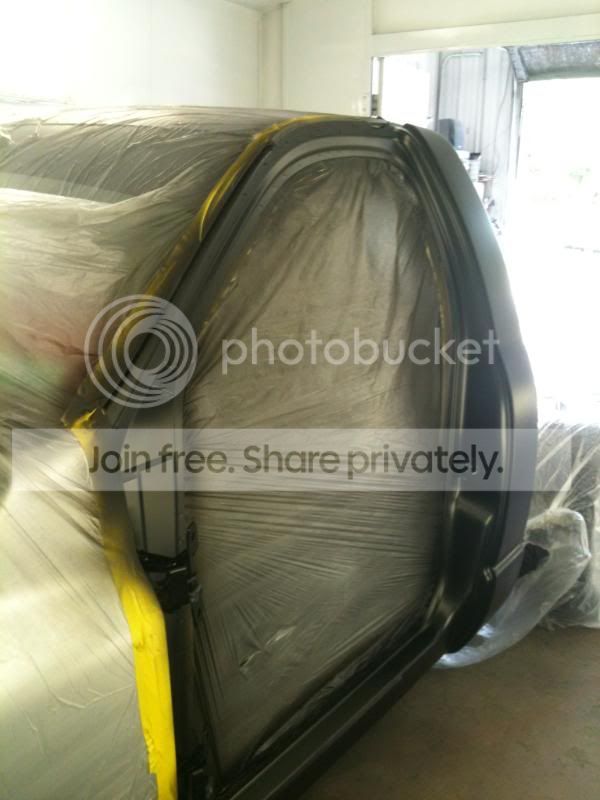

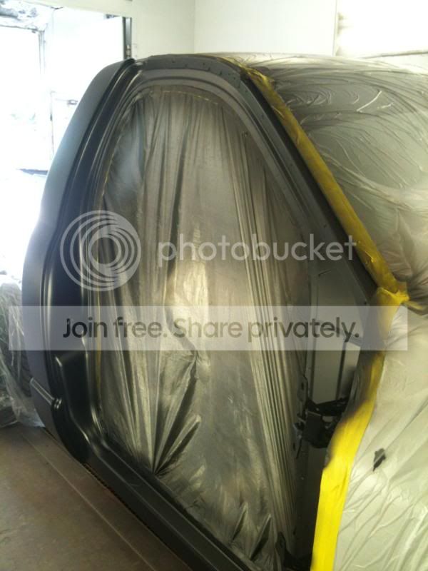

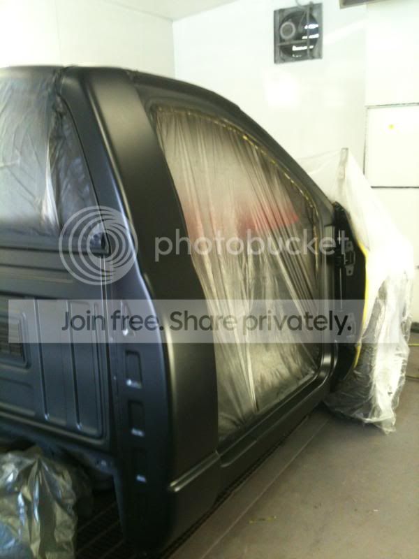

I prepped a good bit at the house and then flat bedded it to a buddy's shop and finished all the prep work in 2 days and got busy laying some PPG Satin Black.

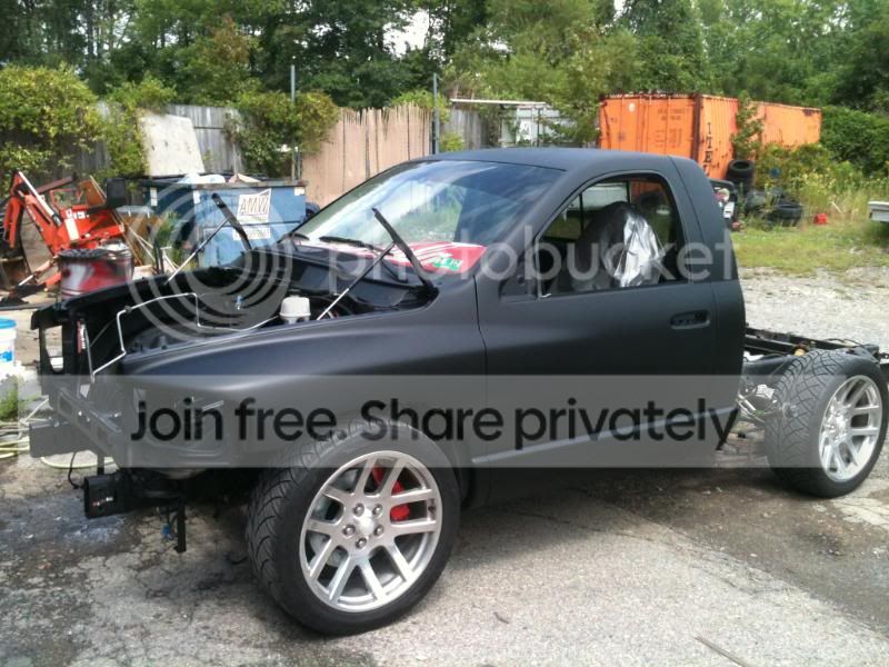

Got the interior back in.

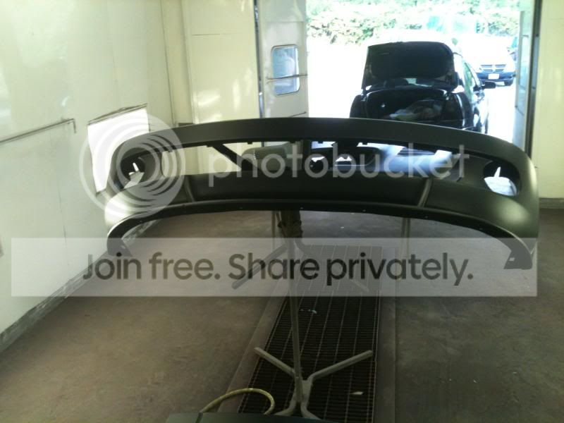

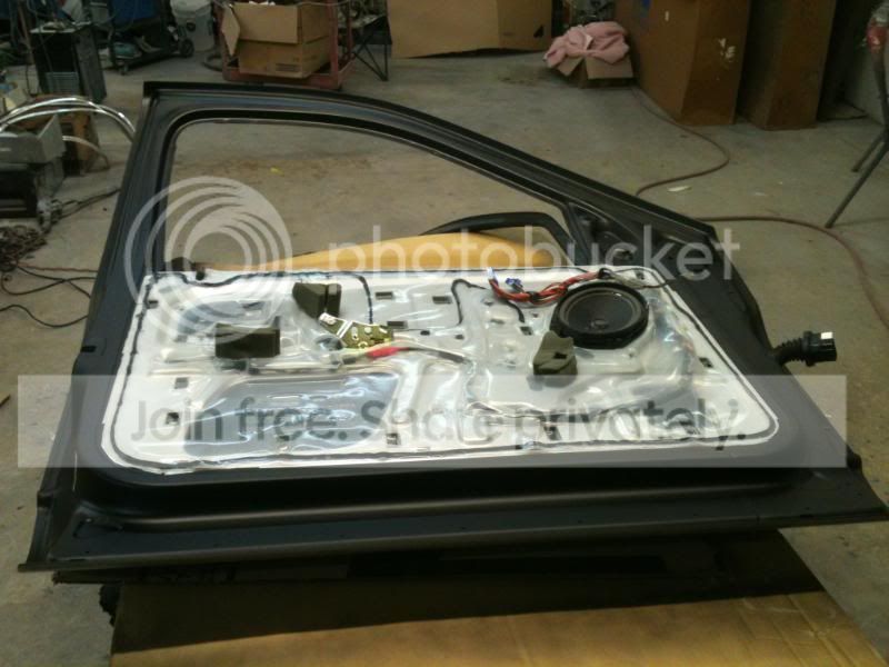

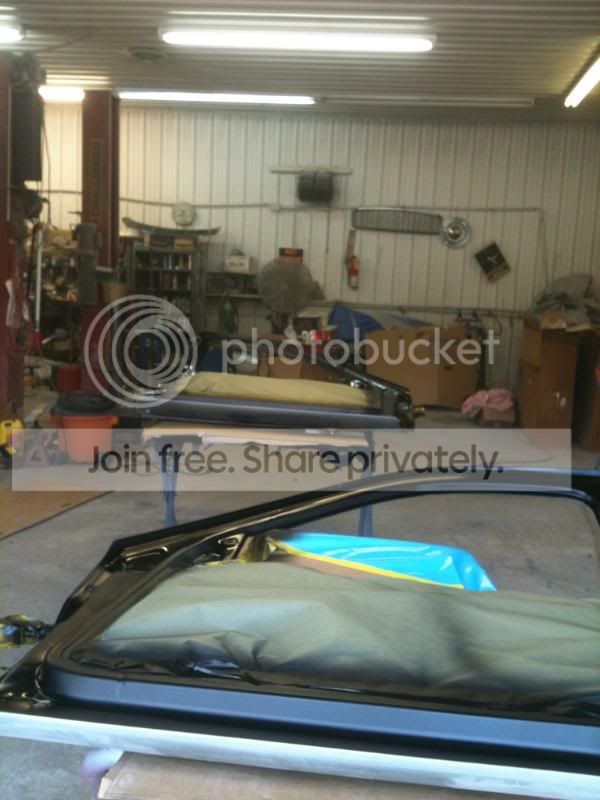

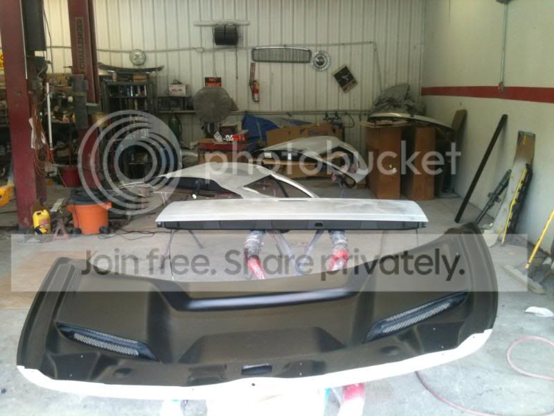

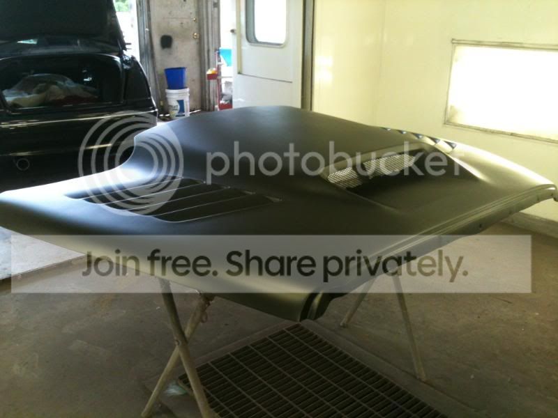

I scuffed up all the lights with a red 3m pad and and prepsoled them and thew a couple drops of black paint in some clear and sprayed all the lights and front badge. I still gotta knock out the fog lights when I get back.There not as dark outside in the day light.

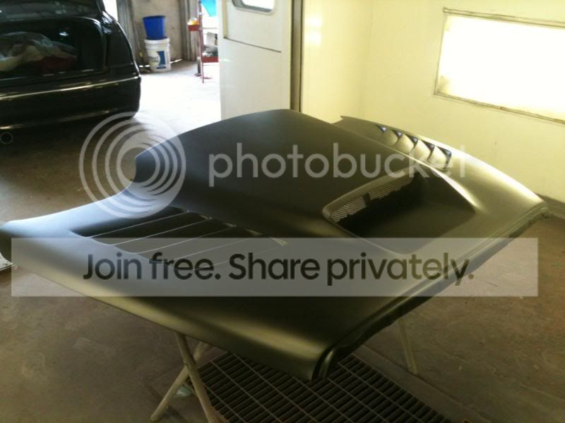

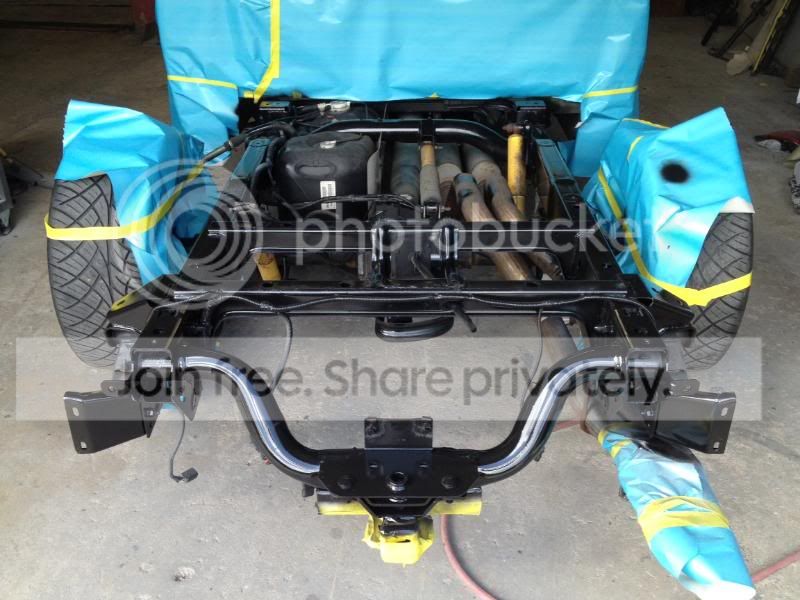

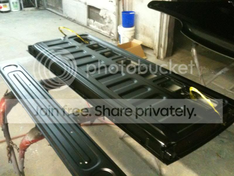

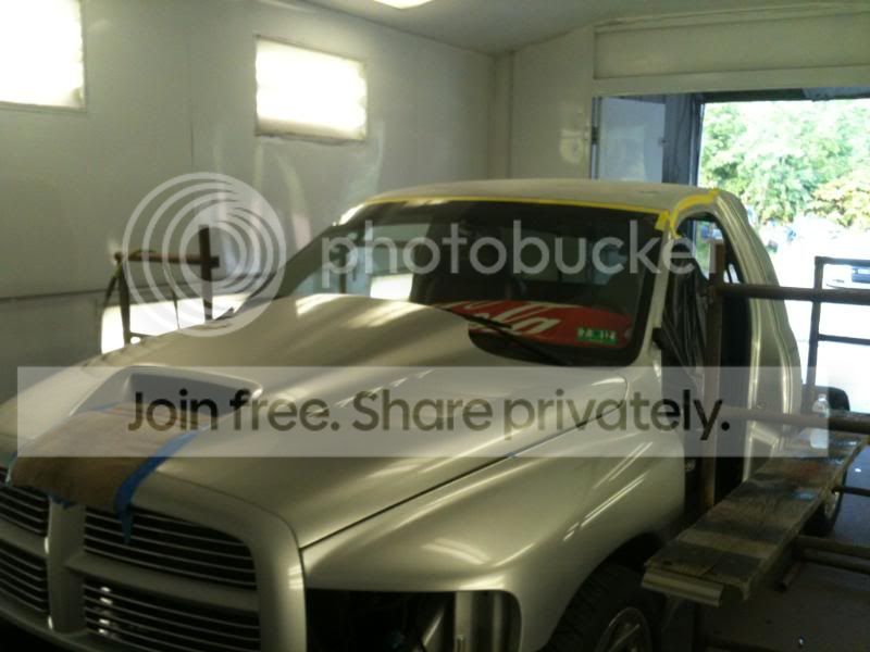

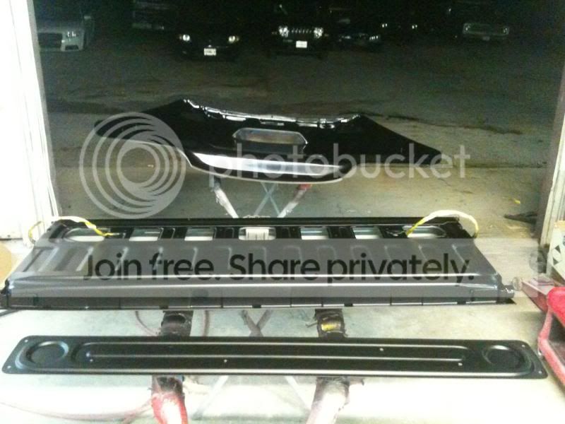

Sprayed all the handles, mirrors, antenna base,antenna, grill,wing and tonnue cover before I headed out . I still need to spray all front grills gloss black when I get back. Extra set of wheels will be black too until I build or buy a set of 2 or 3 piece wheels.

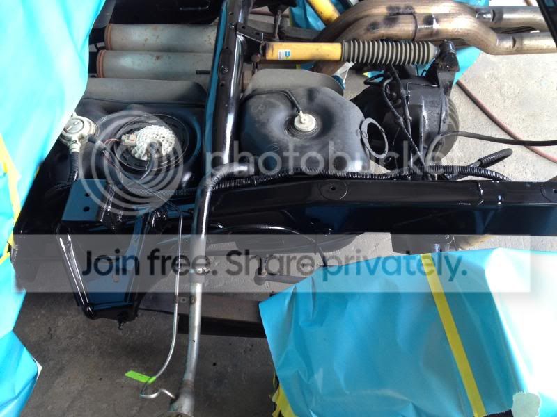

At the moment I dropped a bunch of stuff off to get powder coated gloss black so it will be done by the time I return. Then its time to get the engine bay straight. Weld up all holes not being used and cut off the stand off's im not using and do a little grinding and then reshoot the bay. And then get the wire tuck in order so Its all ready for a fresh forged motor ;-)
Looks great in satin black, but the silver guys are going to be MAD at you!!!
