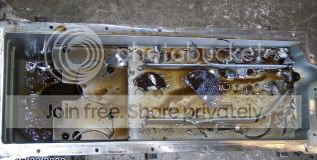

My bottom end went @ 610 whp w/ a Roe Kit. Motor's built now and back in the truck as of this week and should have it tuned sometime in the next two weeks. My pops bottom end went running a 150 shot, after building his w/a Paxton @ 11 lbs he's making 717 rwhp on pump. I'll update once I get mine back and see how it does. Roe vs Paxton

Thx for the welcome fellas. My pops was spraying his for a couple years, it held up well for several K miles. Beat the hell out of it too, definelty got his $$'s worth before it went. Mine ran ok for a 5k miles, I started getting blow back out the valve cover filters and exhaust, then i retuned it then two days later it went. I'll get pictures up soon, here's a video of my pops dyno.

I lost a ring land on a stock engine running a ROE at 590HP, but it could be blamed on the VEC III I was using.
Now 16k into the engine and 11k later into a Procharger, it's been bullet proof so far. Final tune will be done in two weeks.
Detonation kills our engines. The 1st piston ring land is so close to the top of the piston that the detonation may crack the top ring land causing premature engine damage. The cast pistons and rods are also really weak and should not push north of 650HP even with a safe tune NA or supercharged. A few Roe guys like Prof unknowingly had cracked ring lands before they went to forged and built internals.
