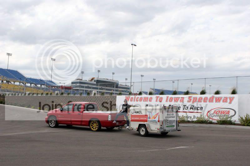

But you can drive cross country in this.:p I say drive it with the spare on. At least they will all be the same color:rock: ;) :D

RedSrt007 said:
Yellow Wheel, White Bed Cover, Clear Taillights, Uhaul, and to top it off Mullet.
:D :D
And he's got his foot on the bumper. I've not seen a clearer case of truck abuse.:eek:
:D :D
Stop it already my nuts are loose from laughing. My friend Pete still has the Mullet. I'm too bald to have a Mullet and am working on the extra weight as well. People just don't appreciate the Mustard and Ketchup look anymore.:confused: :dontknow: I guess my intended future yellow stripes with yellow wheels are just screaming cheeseburger.:D My wife put a quick end to that color scheme. She didn't want Elementary kids asking her for fries.:D :D I'll never live that color combo down.
BTW that grey bed cover set the world record for fastest bed cover on a Srt10.

Sorry to pee in the cheerios but he set with factory cover/wing setup:D :D
