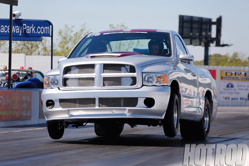

Ive drove Doms with everything from 3.55-4.10, I also swapped mine to 4.10's from the factory 4.56 as soon as I added nitrous. IMO I would never go above (numerically) a 4.10 in anything that makes a few hundred HP over stock unless you are running a very tall tire (32-33"+), even then Id rather have the 4.10. I think the 4.10 works good to around 900-1000whp then I would drop to a 3.73 especially in a 6 speed truck. 4.10's with T56 is 10.9:1 in first gear, thats steep! Doms on about 900whp with 8.80 1st gear ratio (and 32" tire):
