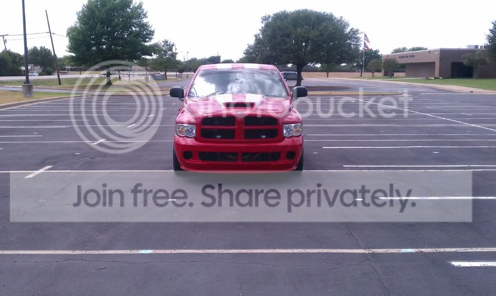

here is a picture of how the bumper fits with out the steel under it, still have to put my fog lights back in and find a way to block off the lower grills so it's more areodynamic

All i am saying is that I would not cut mine up, what you guys do... is well whatever you want it's your truck.
