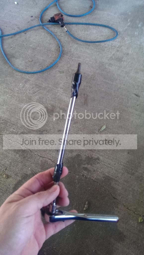

Sure I have, 1/4 drive T27(I think) on some 1/4 extensions will fit thru the top of the intake. Wrap some electrical tape around the joints so you don't drop it under the intake.
I actually slip an 11mm through the side if intake on pen magnet and feed ratchet/extension through top. Voila :burnout:

First time removing the intake was a PITA. Now its fast.

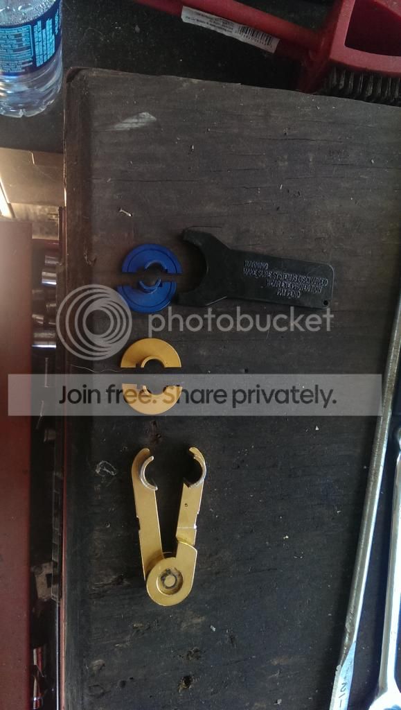

Hey guys.... what are you all using to perform the quick release on the supply for the fuel rails? I did it once, it was a PITA.
Thanks!
A metal fuel line remover tool. Comes with 4 sizes I believe. Right tool makes life easier. :burnout:
Thanks!
The two piece ones are made for late model Chevys, I like them because they're a little easier to get in tight spots.
