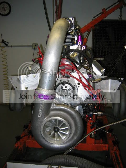

Hey Ike why dont you just go with something like this:D
