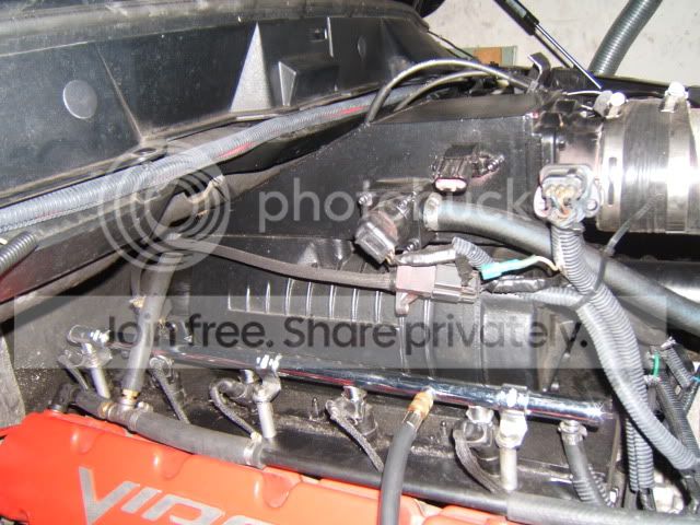

Does anyone know the part number for the 2.0 bar map sensor, and how to hook it up? The kit I bought was a vec kit, I'm running SCT. Thanks.
I don't have the part number but hook the map up to the vacuum port on the passenger rear of the intake DO NOT use the map on top of the supercharger.

Thanks, i guess i just run a tube to the sensor? I capped off the port up top already.

Hmmm...maybe I missed something along the way...can we talk more about the MAP sensor Dawg....I was told just to replace MAP with a 2005 SRT4 MAP sensor....just had to file it a little and it plugged right into the top of the SC.....what is the deal running back to that back???:dontknow:

That's where I tapped into for my map sensor. When I take it apart again. I'm gonna tap it out and mount it up front. I left the old map sensor in as a plug.

So you are going to put it back where it mounts up top??..
The 2bar has to be after the sc to be able to read boost and vaccum. If you have the vec then you plug a 2 bar for over 8psi I think.

No in front under the pulley drive. If you have an sct how are you running it up top. I was told only with the vec:confused:

This is something new...nobody ever mentioned that....where did you hear it?...might explain small issue I am having.........and why are you moving it from back to front?...
How old is your Roe:p Sean told me he didnt even make them like mine anymore and thats what I had to do to get the 2bar for the sct. And your reading boost good from there?

Just so there is not so much wiring now I can finish up and start to make her look pretty. Ok dont quote me because my memory sucks and it's been a while.
When I first installed my ROE I had the instructions for install with a vec so I had no clue about the 2bar (another story that Im sure sean wanted to choke me for a while:vollkommenauf: :D ) so I ran it and it ran like shiiiit and thru all kind of codes. Sean finally decoded my jibberish and told me the vec can use the original map sensor because you tap another line for boost reading. I asked him about putting it up where the original map sensor and He told me no because you can not read boost right at the TB it had to be after the S/C so I just put a 4 way in where the original port was, boost gauge 2bar, FMU, and shit cant remember the other one.
