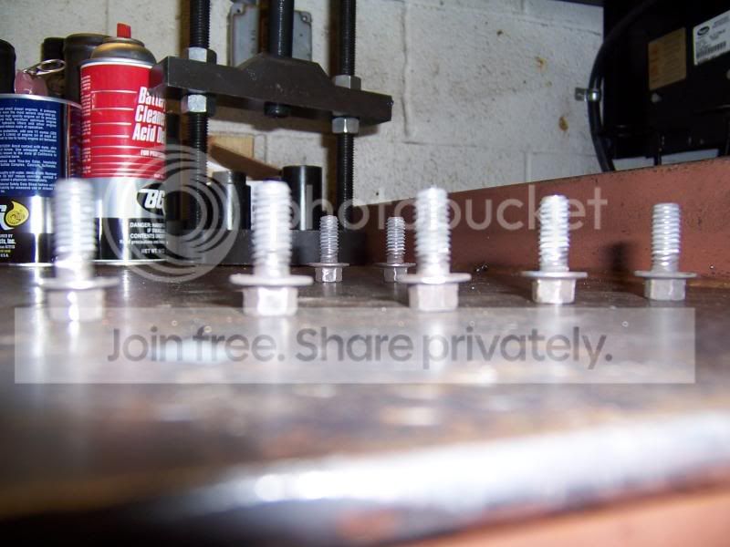

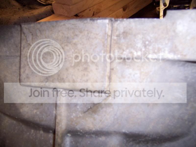

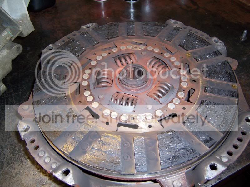

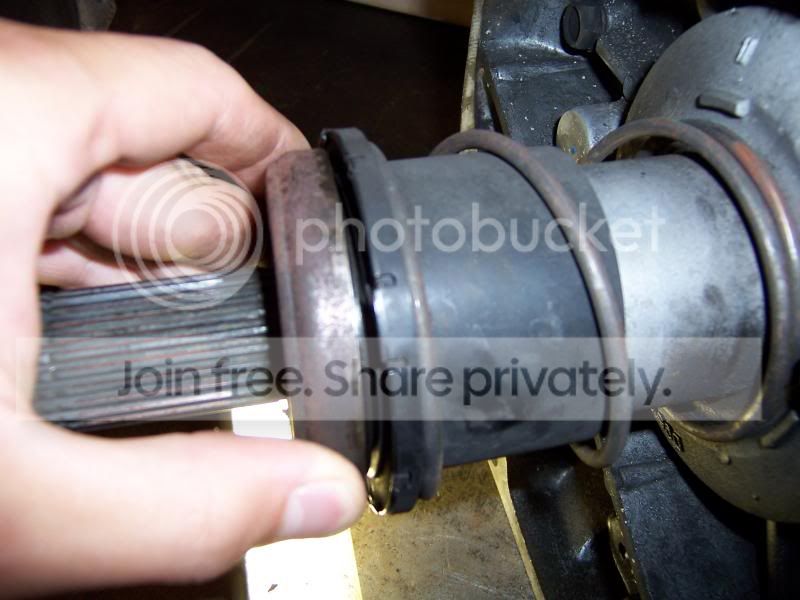

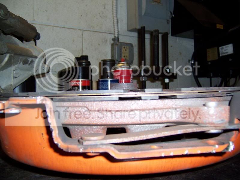

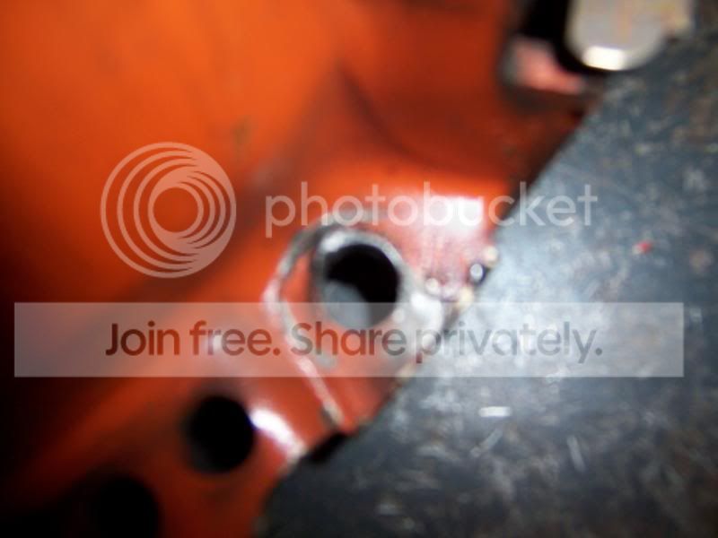

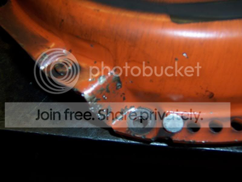

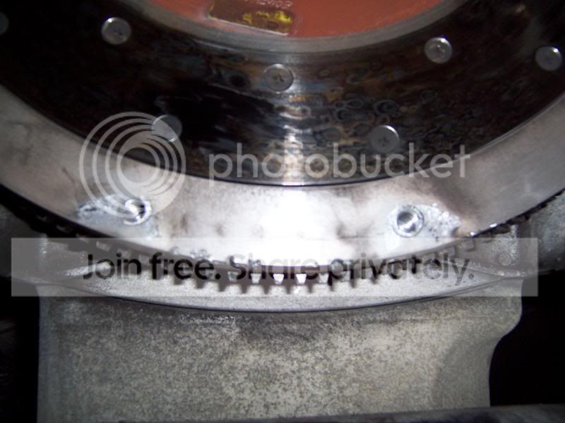

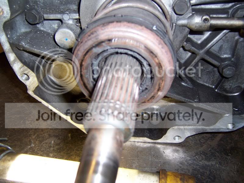

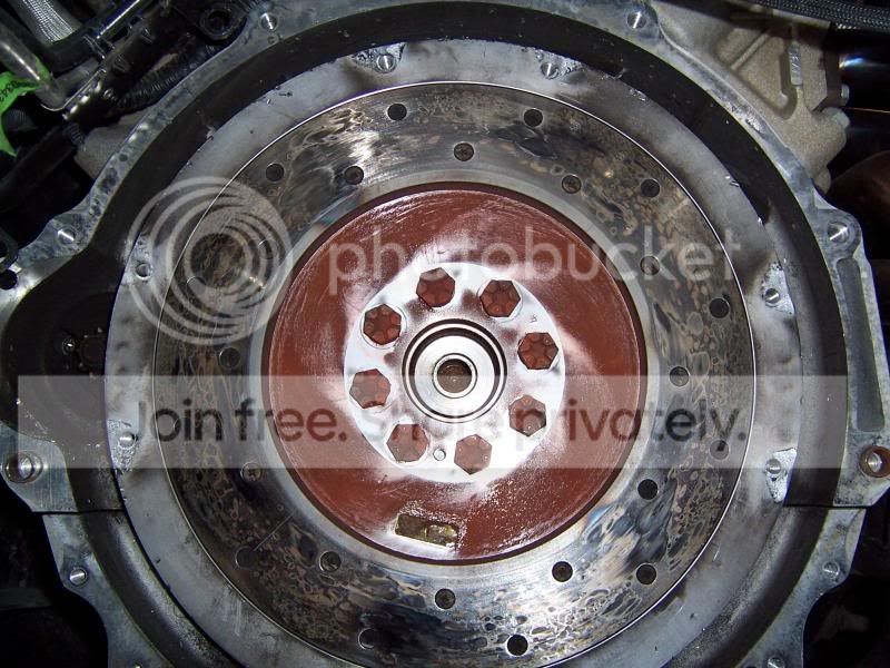

After dropping the transmission Dwayne (The Viper Tech) came and got
me and showed me the damage.
From the pictures above you can deduct that yes, there is broken bolt
in the flywheel, and yes the head flew around inside the bellhousing scraping
everything to hell and eventually cracking the bellhousing on it's exit
through the inspection plate. The flywheel is chipped up on it's outer
circumference and apparently the other bolts were barely screwed in.
The bolts that didn't break had bottlenecked. Unfortunately the dealership
that put this is in is now out of business. But just to put it out there
DON'T GO TO LEESBURG DODGE!
