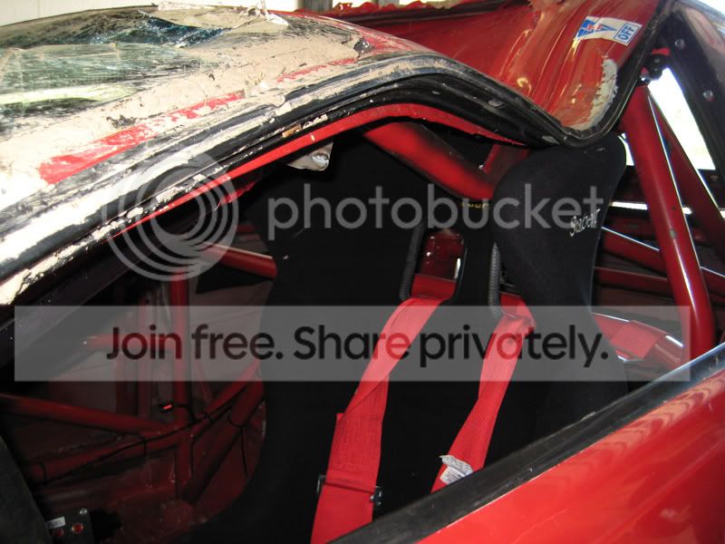

i agree to a point, a crappy roll bar or cage can be dangerous. However judging by the pic i can guarantee that if that bar was not there that roof would be crushed well below the doors. I just strongly feel that the cab is very weak and once the truck ends up upside down the cab crushes like a paper box. Maybe not a sub 11.5 cert rollbar/cage but one that will give an extra degree of safety, allow for 5 point harness, camera mount, fire exting, and oh yeah keep the cab from collapsing in... Now If was trapping well past 110+ in the quarter then i strongly agree on welded cage..
