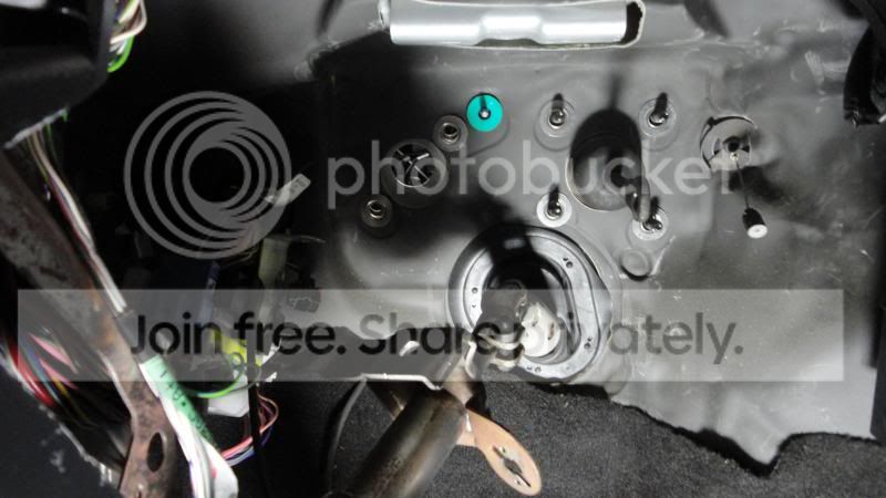

First off… MY BACK IS KILLING ME! From being all twisted up under the dash for 2 hours!

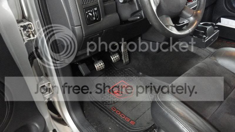

I was able to get the auto pedal assembly out without removing the steering column completely, but couldn't get the 6-speed assembly installed without removing it. Took 20 minutes to figure that one out and several expletives later I just removed it. It was a lot easier to install the assembly by unbolting the power pedal motor and the gas pedal. One hang up that happened is I had this weird slack in the throttle cable. Like there was no tension. I thought something was hung up so I removed the throttle cable. Big mistake. I couldn't get the grommet back in the firewall for the life of me. I had to cut some of it off and shove as much in as I could…. Seems to work ok….
The other issue is that the brake pedal has a lot of play Like the cylinder that it slides on wiggles quite a bit. I am not too sure what to do about that.
Also, the clutch pedal is hard as a rock. Is that normal? The master cylinder isn't connected to a transmission but I thought the pedal should at least be able to move or something…

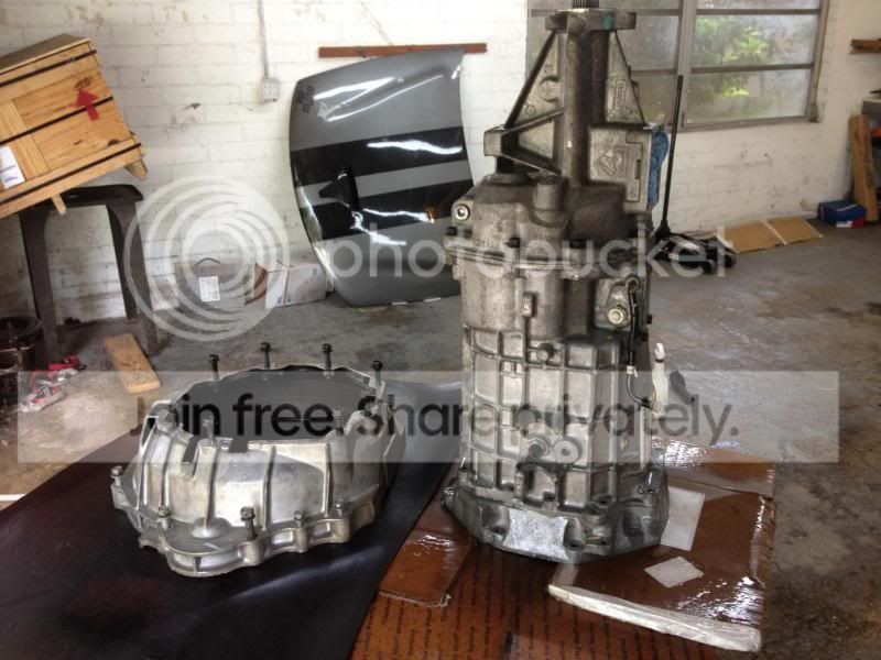

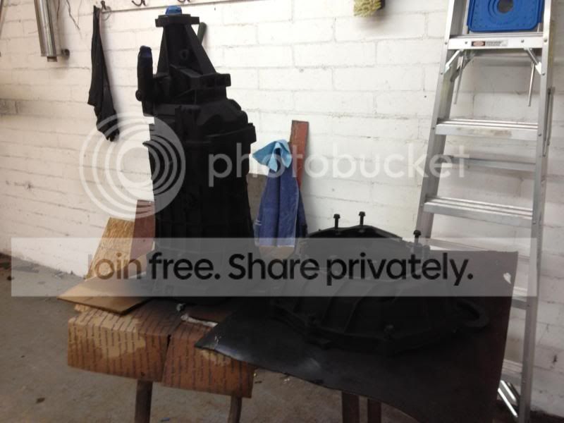

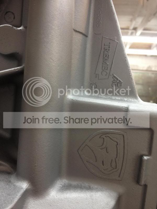

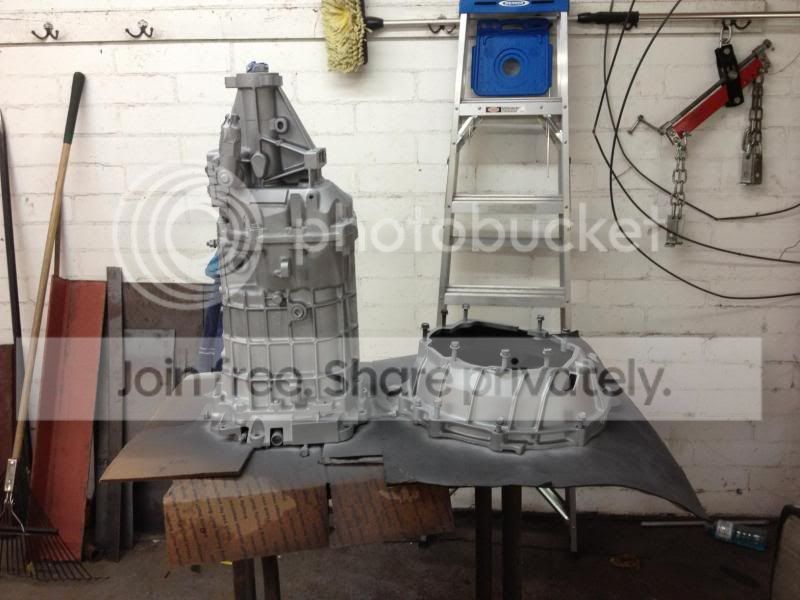

Also cleaned up the transmission and the bell housing. I like header paint. It just seems like really durable stuff. I had some black header paint lying around and gave them abase coat after I cleaned them up. Then applied 2 heavy coats of silver. Should look quite nice under the truck.
The clutch pedal shouldn't be hard to push and how did you swap the pedals? All I did was unpinned them from the aluminum plate under the dash and put the new pedals in my factory aluminum housing,and as for the brake pedal check and see where the play is at,did you make sure the plastic bushings were good in all the pedals where they pin into the housing

yes is normal for the clutch pedal to be solid like a rock. As soon as you connect a slave you'll be able to push it in. Its a sealed system. you can buy a new plastic sleeve kit from the dealer to fix the pedals its like 50 bucks
Are the plastic sleeves interchangeable? I could remove one from my automatic brake assembly and install in the manual one I suppose. I'll see how hard it is to take it apart.

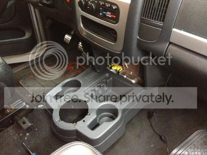

There is a rubber block off plate that goes over shifter and seals dirt, noise, and heat from cab. It's black and I'll see if I have one still extra.
Your clutch pedal will not move until you connect to slave sir. Think.... The end of your clutch line at disconnect has a valve that won't let fluid out until connected to slave line. That's why it's hard as you're pressing against a closed valve.
Thanks for the info. Thinking about my other build... You right. There isn't anything pressing against the slave to push it back. Its all the way out right now. There's no where for it to go.

Much to my dismay… I didn't know I needed to be so specific with X2Builders about the center console. I removed the cup holders. I'll have to find the piece that goes in its place.

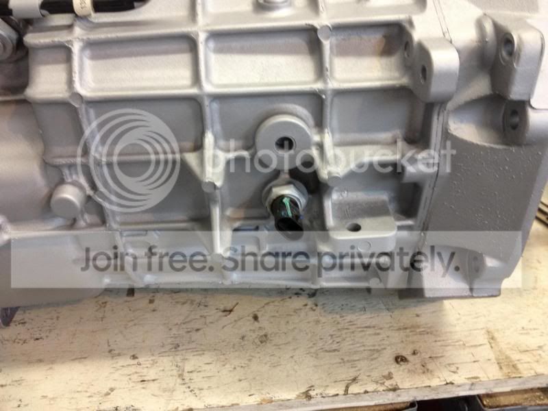

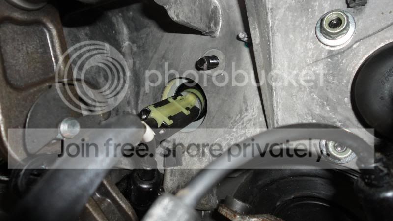

Also, What does this plug do, and how do I wire it up?

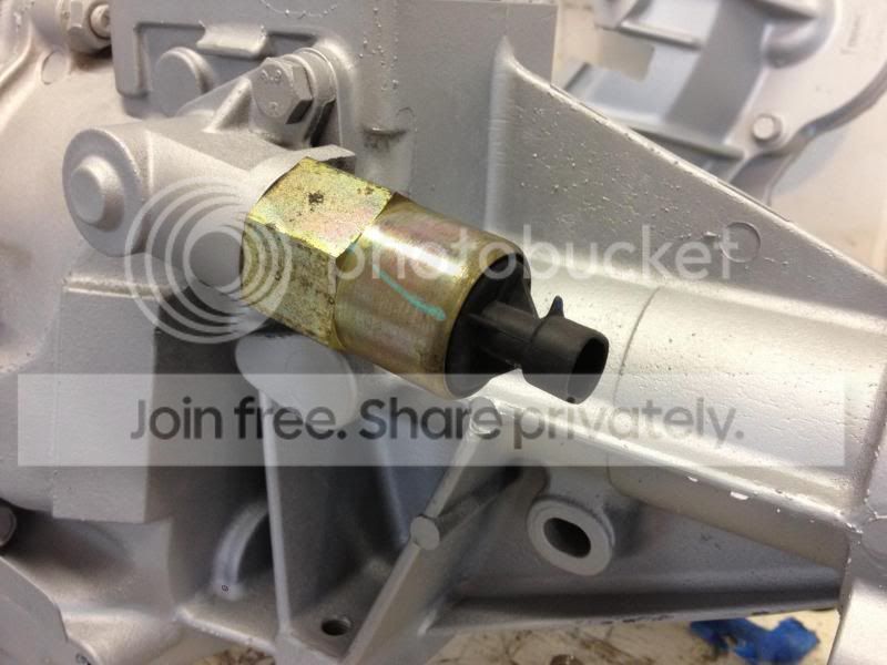

And this plug also… Both are on the T56

First pic in order is your reverse lockout solenoid and next pic is reverse switch. Lizard I have no idea :)
Mine has never used reverse lockout and likely wont. It keeps you from hitting reverse while moving if you miss 5th gear by a long shot. Lol:D
