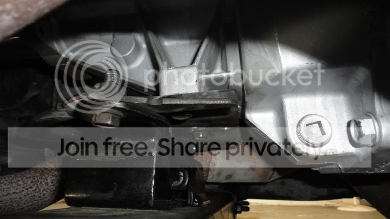

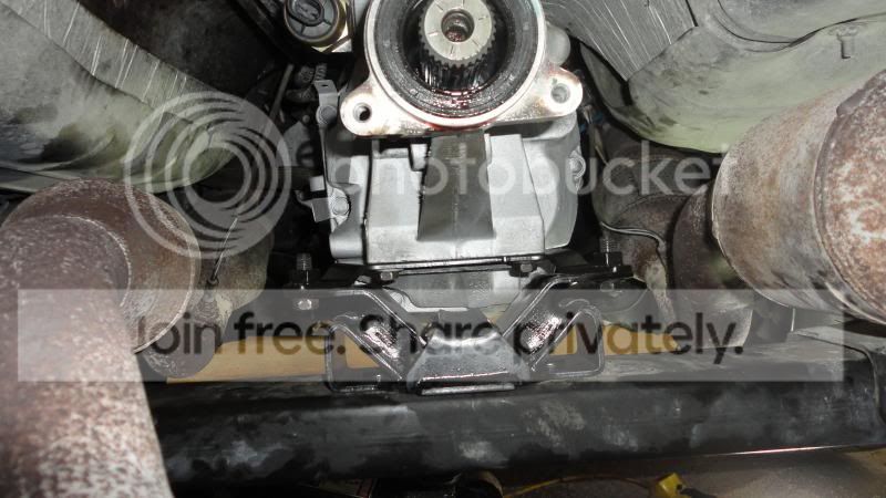

So if I am missing a bracket it would be nice if someone could show me a picture of what I am missing...
Anyone have pics of this bracket?

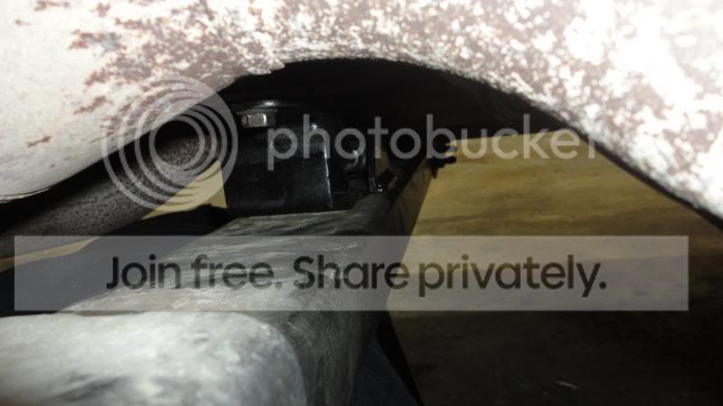

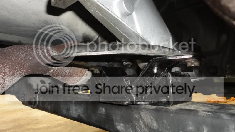

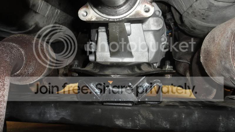

Just went out in the pourin rain for this pic. Hope it helps. Hard to get without laying under it.

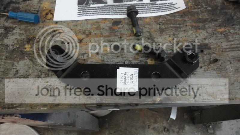

Just got a fax from the dodge dealer with the mount and bracket pics. It's a very small bracket. 1/8" thick steel should do fine.. I'll just make one on Wednesday.

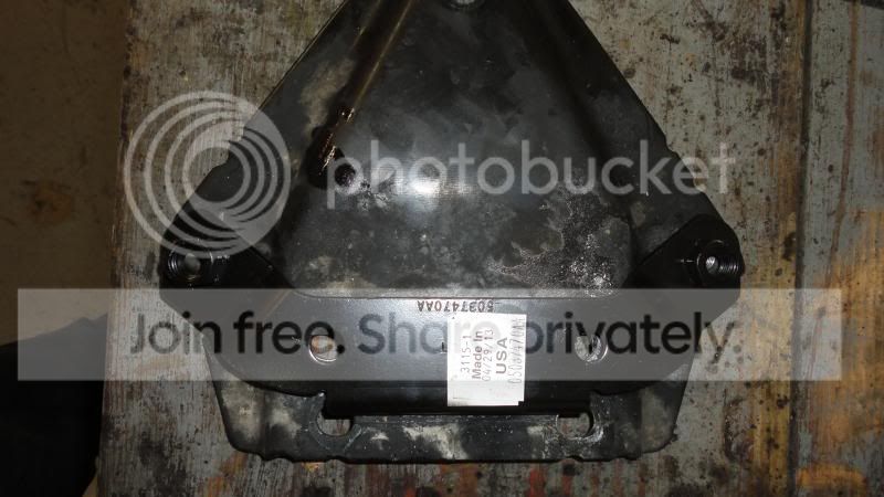

Removed the driveshafts and the yoke.
The is how I used the transmission mount and bracket. You can see where I drilled the two holes. From the looks of the bracket, it look like the automatic bracket actually pushes the transmission up 1/2 " HIGHER than the manual bracket would. So that is unlikely the cause of my problem. I am thinking that my issue is 100% my fault. I should not have forced those driveshafts together. i should have stripped that damn blue paint off the custom half shaft.

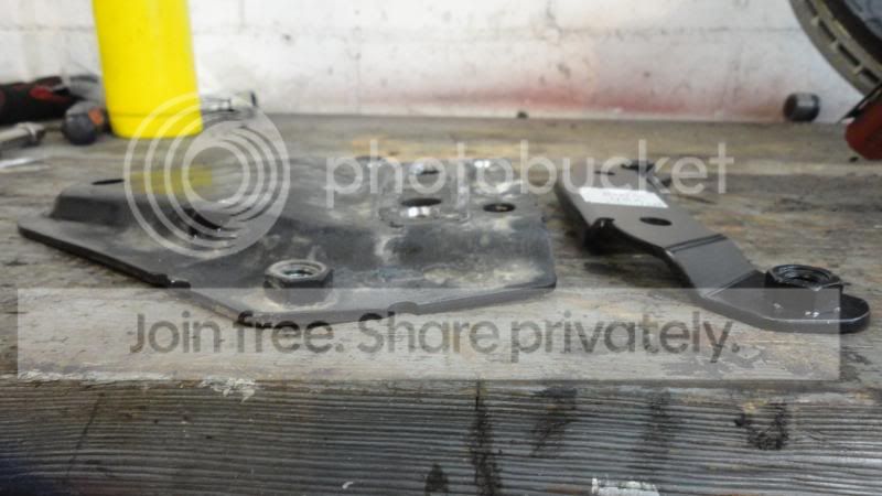

Swapped out the automatic transmission mount bracket for the manual bracket. My findings? They are exactly the same height. Buying the manual transmission bracket is not needed for this swap. One merely needs to drill a couple of holes and there you go.
It only makes sense.
From the very front of the crank to the tail of the transmission is one straight line. No difference between an automatic viper truck or a manual viper truck. So why then would there be a height difference in the motor mounts/ transmission brackets? There isn't one. The 48re doesn't mount higher or lower than a T56.
So, it wasn't the angle that killed that rubber in the carrier bearing. It was my forcefulness.
