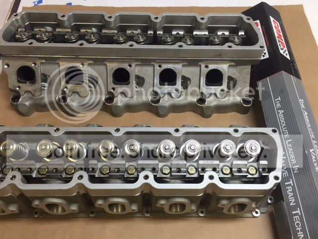

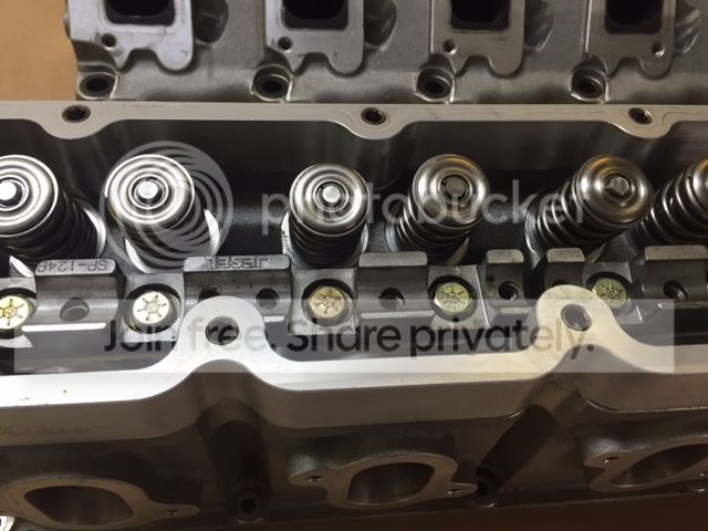

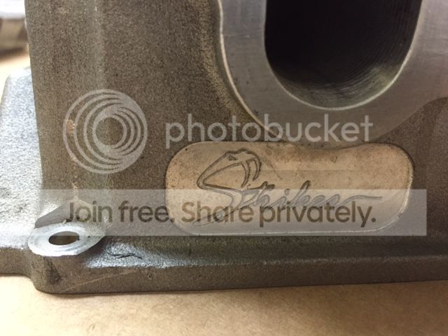

Here's the pics, if you want any other pics just lemme know!

They will, but there is an issue with the PS pump (it needs to attach to the D.S. head with a "spacer"). And header mounting will require a spacer/adapter as the bolt patterns are reversed.
Your temp sensor will also have to go somewhere else.
Not impossible obstacles to overcome.
PS The required custom Roller Rockers are still available from Jesel.
I'm not sure about availability of the T&D rockers.

Proper Lifter preload IS CRITICAL on these heads for best results.
Rocker gear also HAS TO BE SEALED properly.
