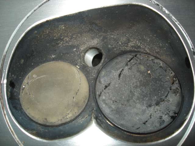

Ronnie, this is where I am with wet flow on a Gen 3 head. This set of heads was done about 5 years ago, and I took this pic on a freshen up last year(?). I wish I had taken a pic before I cleaned the deck surface. It completely carbons the entire chamber, and there isn't any streaking in the exhaust ports from wet fuel being pumped out of the cylinder. It looks like most of the fuel is getting burned inside the cylinder.
ETA: The pic was taken after I washed the heads in my Varsol tank with a plastic scrub brush. A lot of heads will have carbon that wipes off easily with a shop towel. This stuff is burned in real hard and would have required a wire brush in a die grinder to remove. That's the kind of carbon I like to see. When it's burned in good like that the combustion is good and the fuel is being turned into BTU's of heat.

The photo you sent me of a combustion chamber shows a chamber that appears to be burning well. However, I am at a disadvantage as I can’t possibly know the myriad of factors that end with a photo of this particular chamber.
