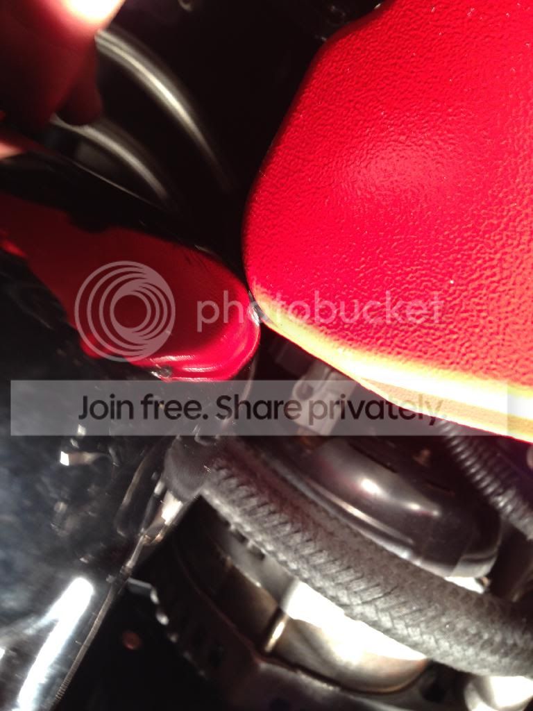

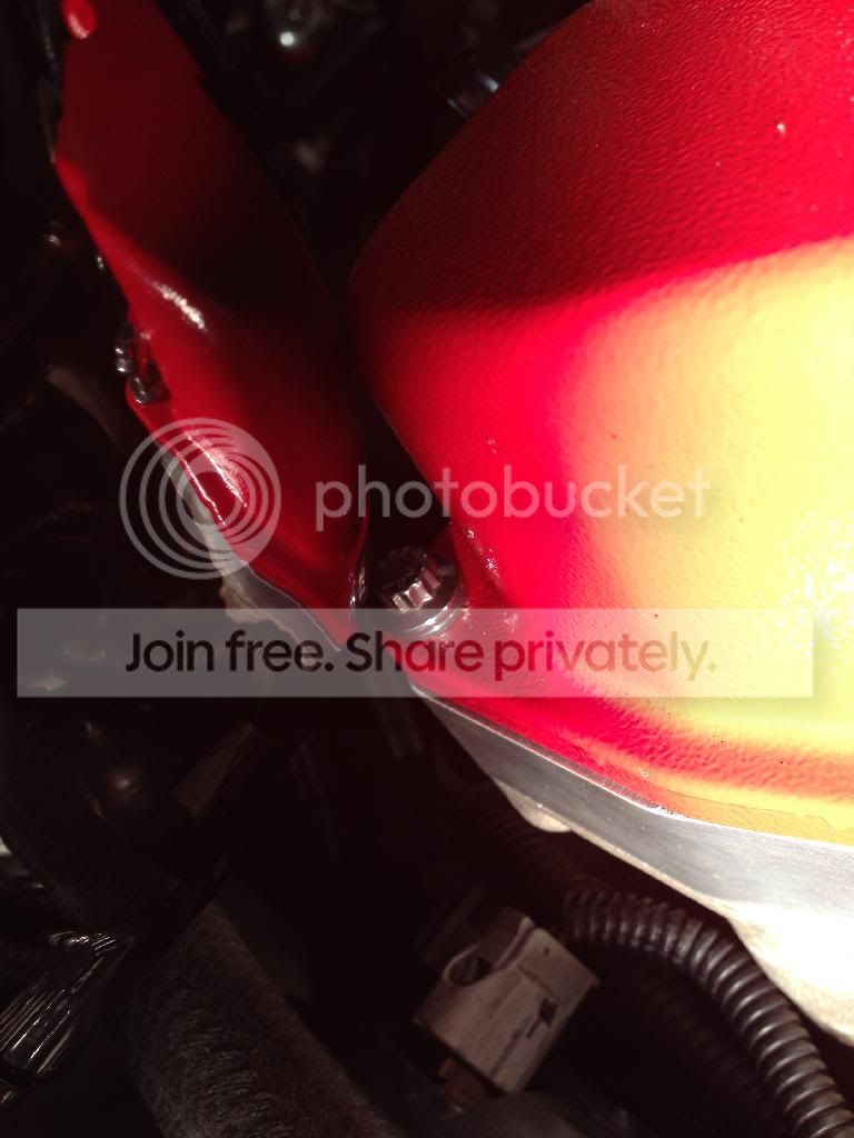

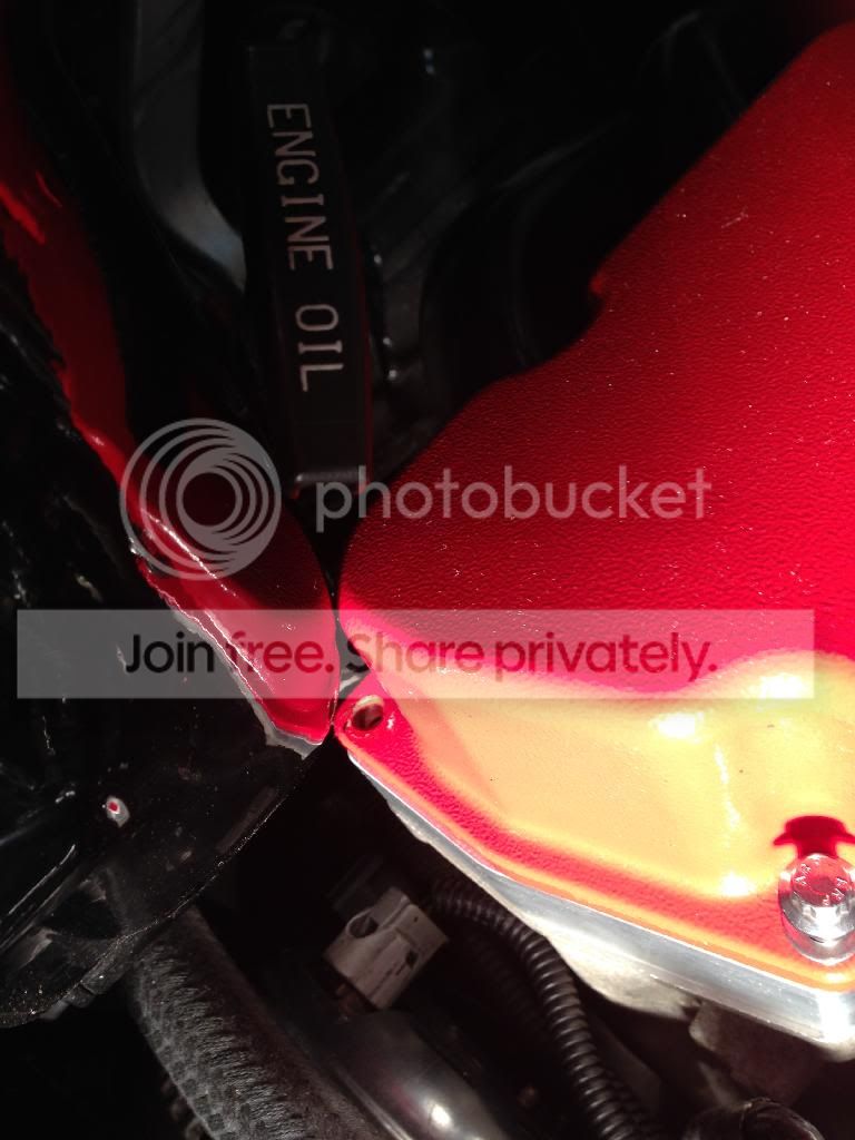

It was a little PITA to install the valve cover spacers & valve covers with the Paxton installed. I ended up removing most of the mount bolts from the supercharger and rotating it towards the passenger side fender which gave me enough room to get the last arp bolt on the corner of the valve cover and tighten it with a wrench. I also used some Loctite on all the valve cover hardware since I've used it on everything other bolt on the motor. Then I tightened all the S/c bolts and put the belt back on.

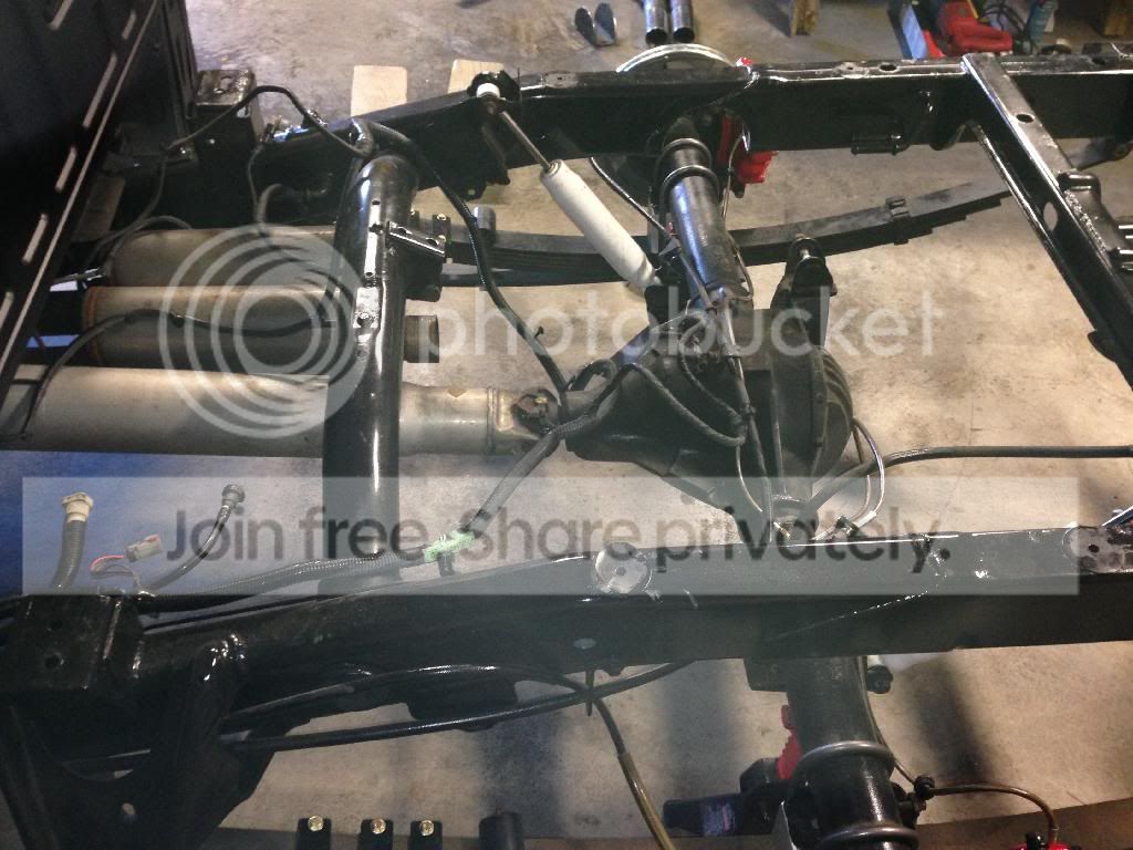

removed the gas tank today and the wiring that goes back to the tail lights and bumper bezels. Now I just need to cut the bracket off that holds the brake line and I'll be ready for Mark to come over with his plaza cutter and welder next weekend to get the rest of the C notch knocked out.

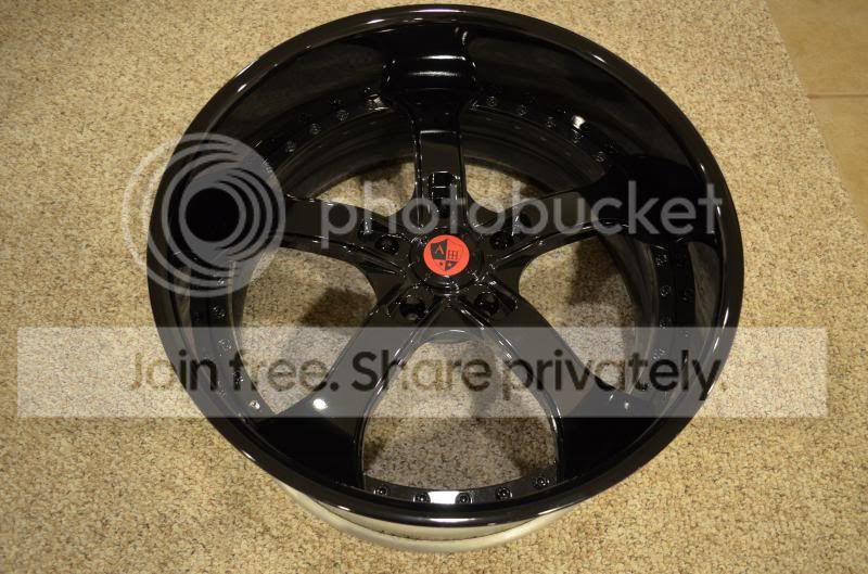

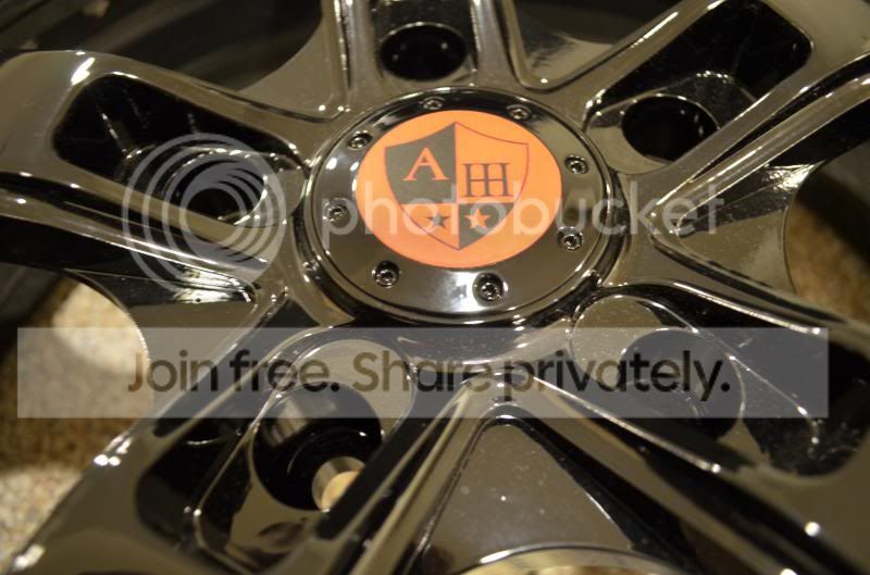

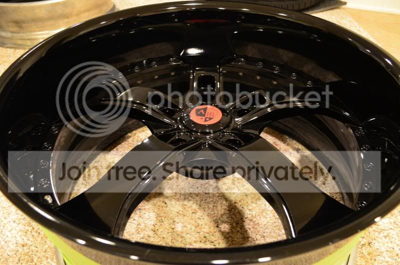

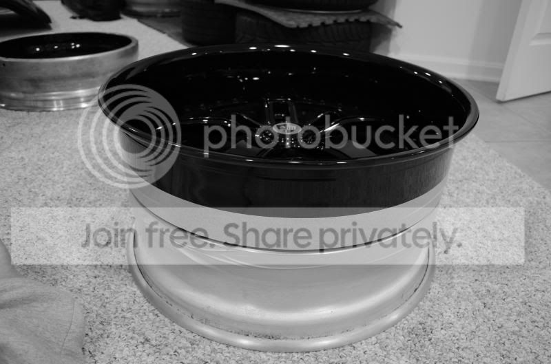

To cold to work in the garage so I finished up the front wheels I'm building for the truck. 3 Pc AM Forged Tributes 2.0 22x11
The rears I need to measure again from the leaf spring pack outboard. But there's plenty of room to go in and out with the proper offset. There rears will be between 12"-13.5"
