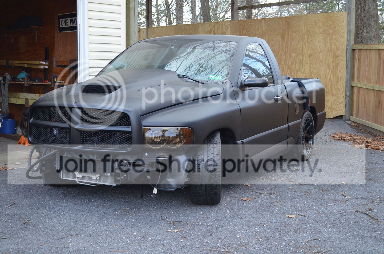

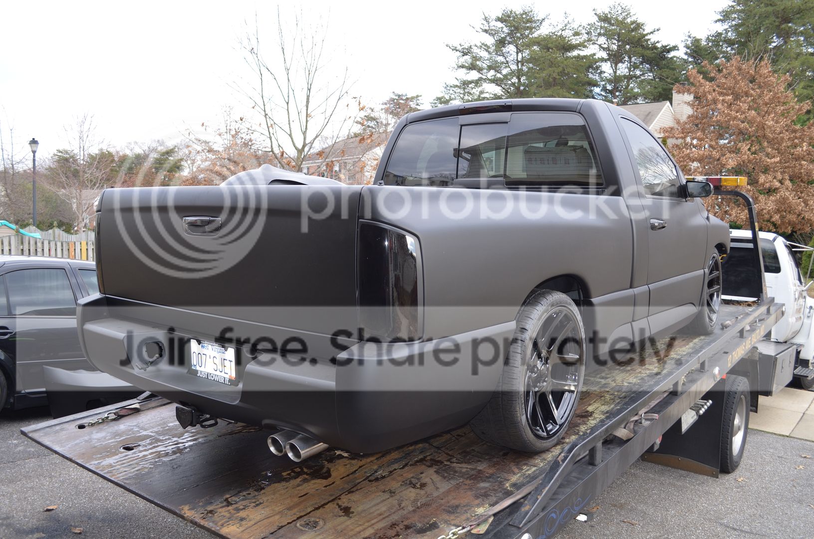

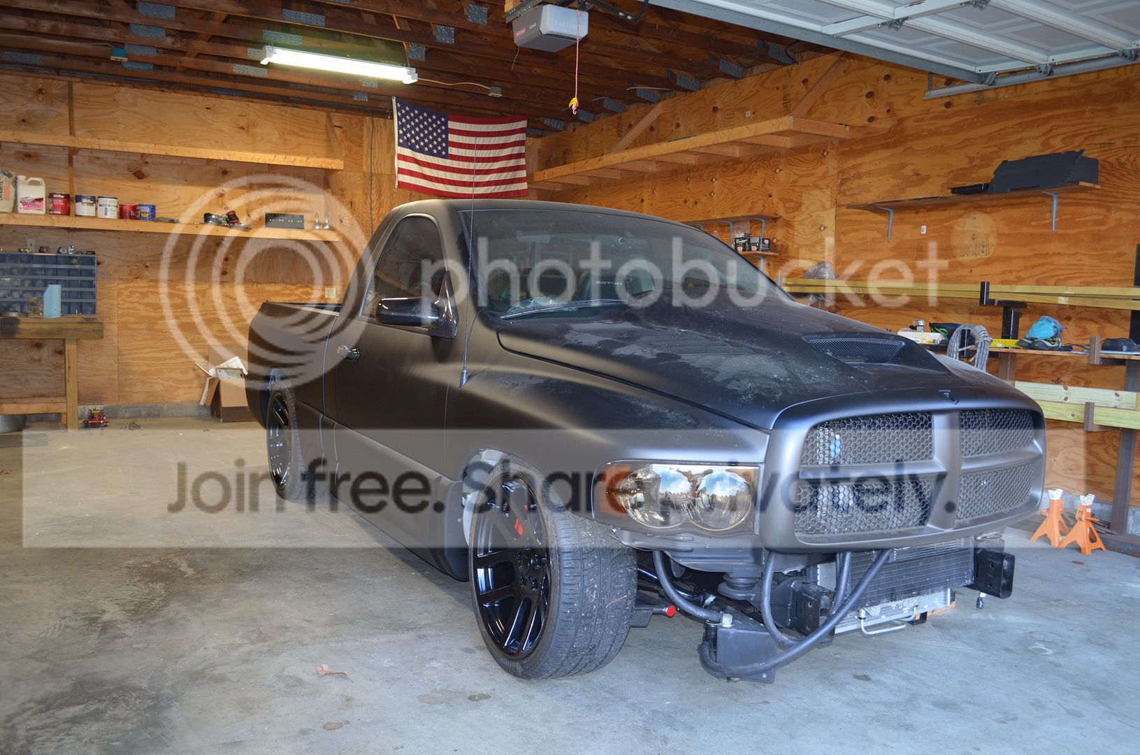

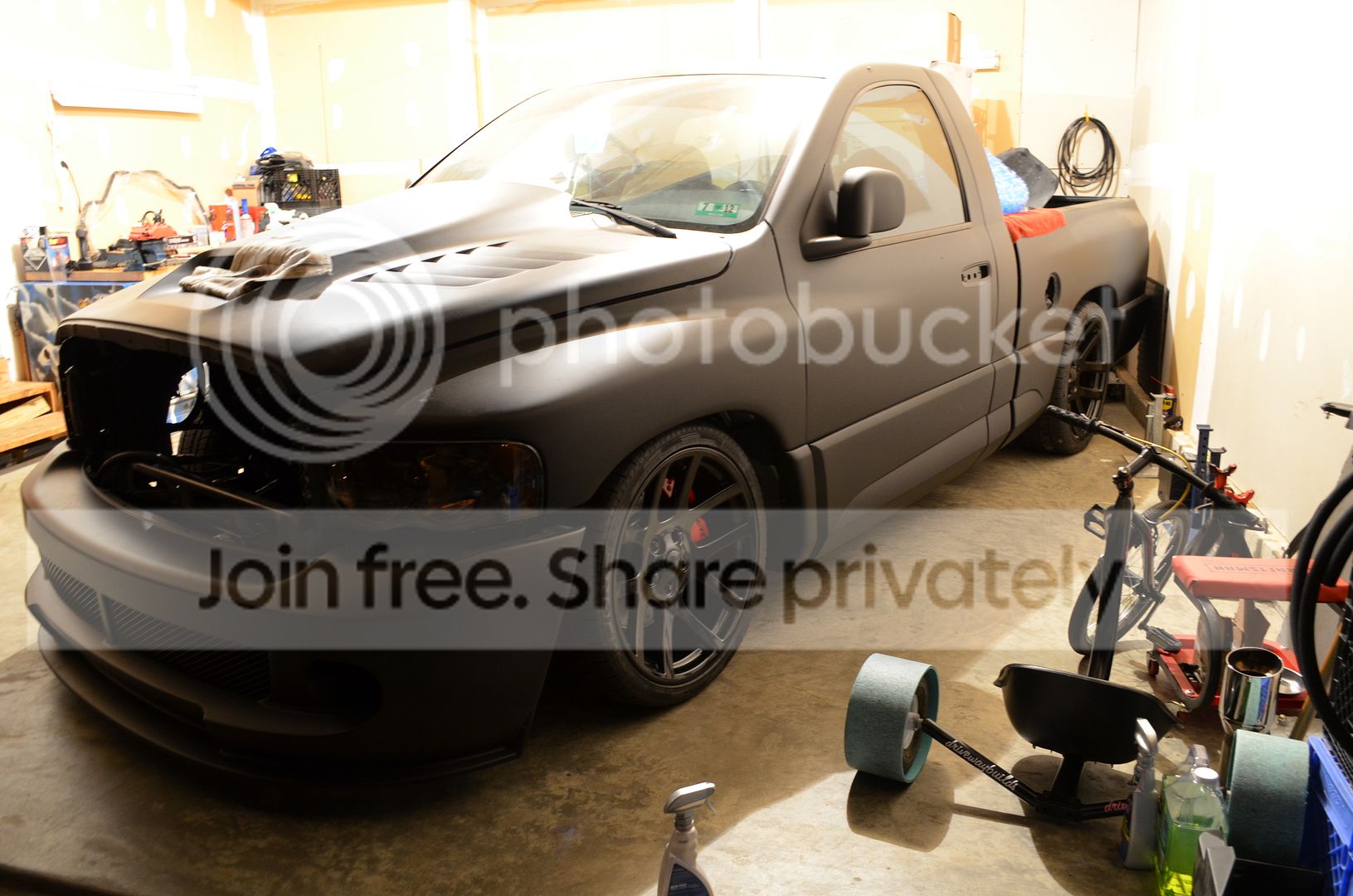

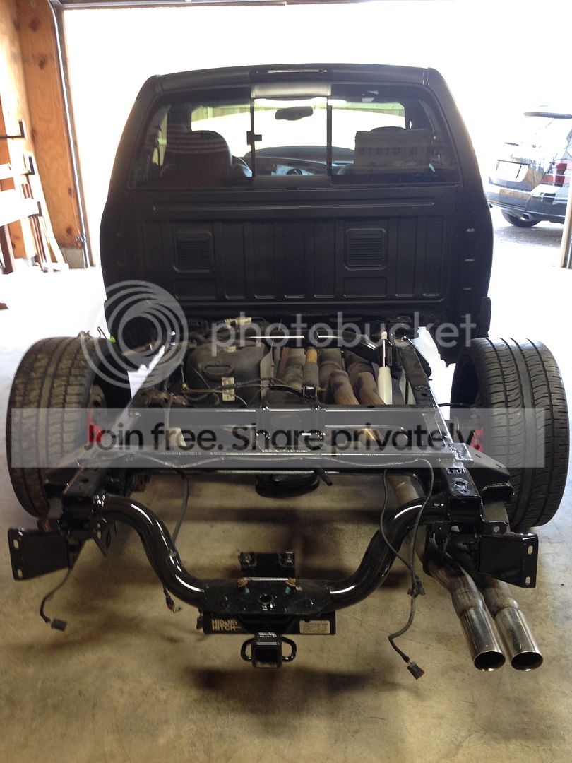

Alright gents I moved Hank over to a buddies place that has big shop area that he doesn't use and said I could use it and its already wired for 220 so I can get some welding done.

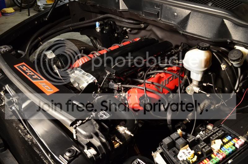

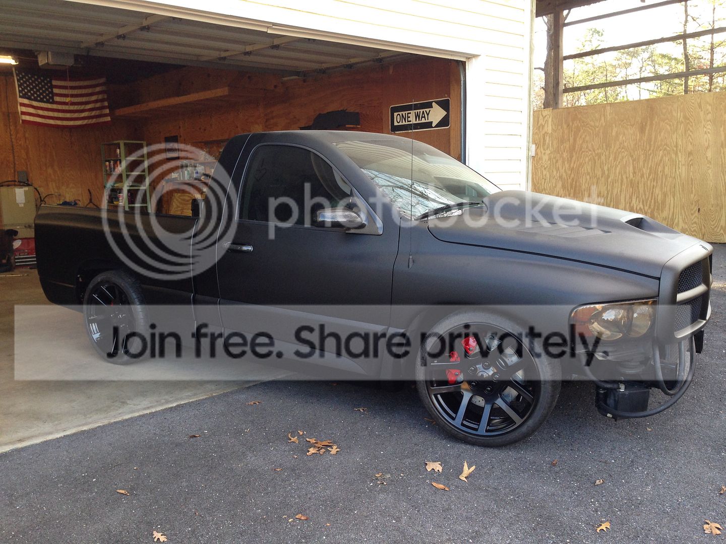

Hank before the move

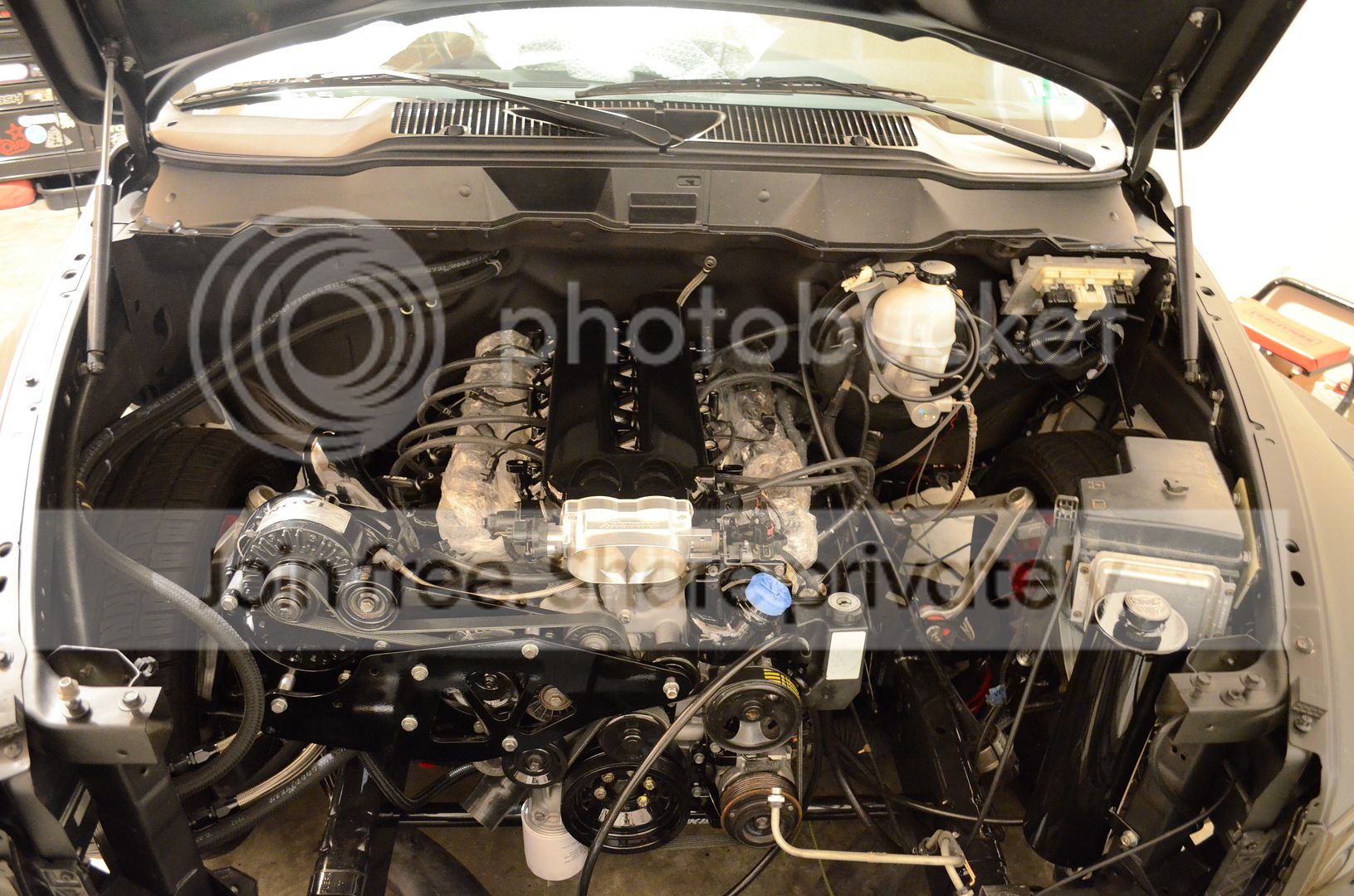

lookin good:rock::rock::rock:
progress:rock::rock::rock:

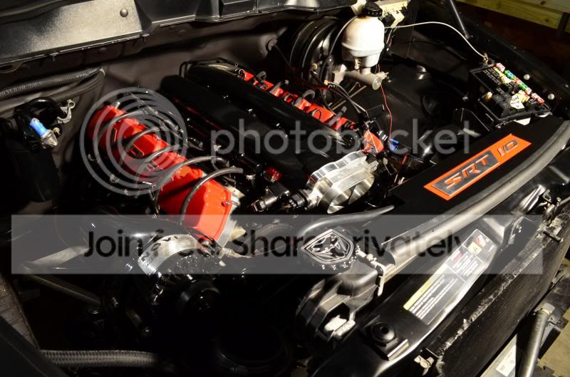

carbon bezels showed up

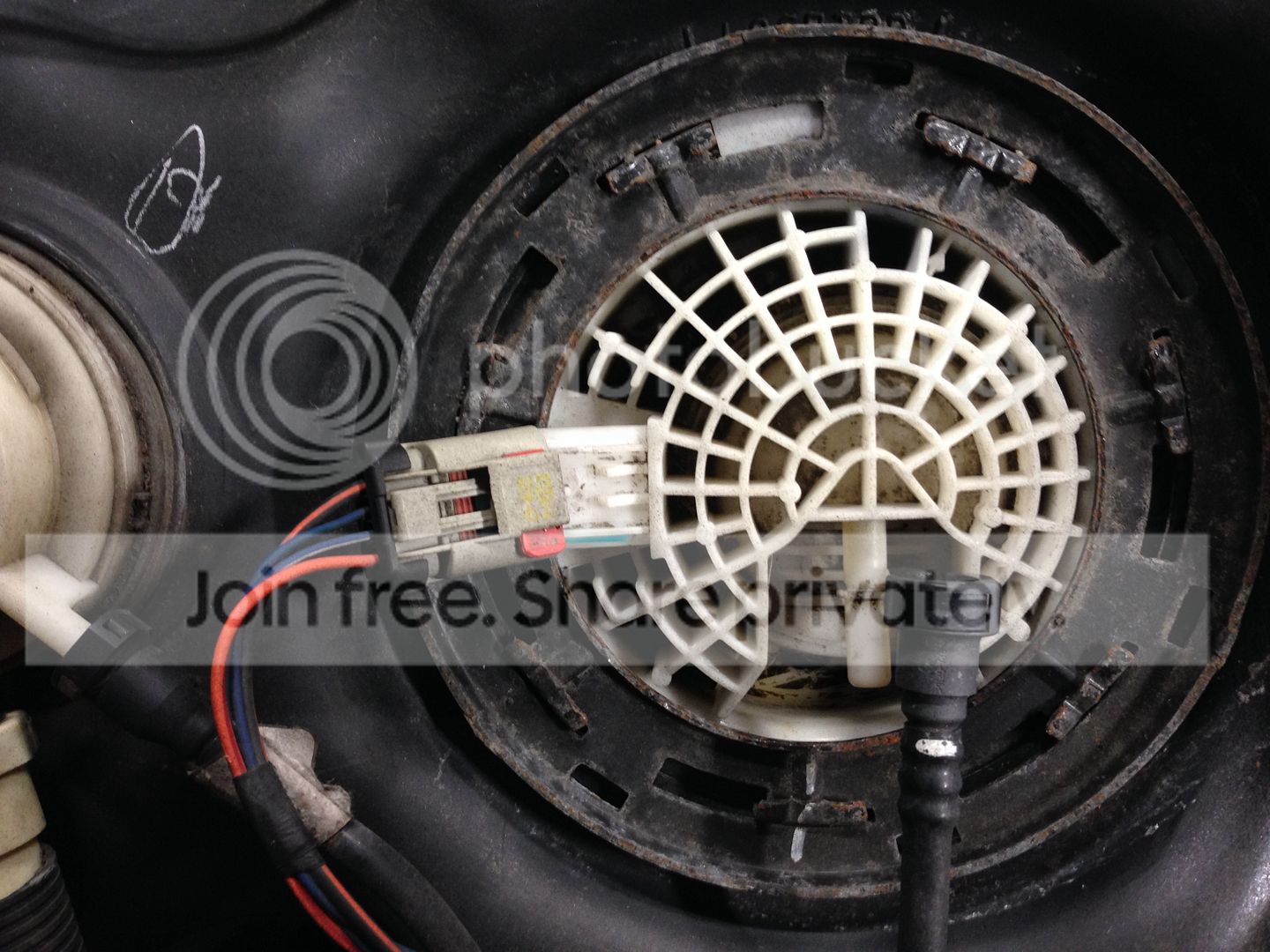

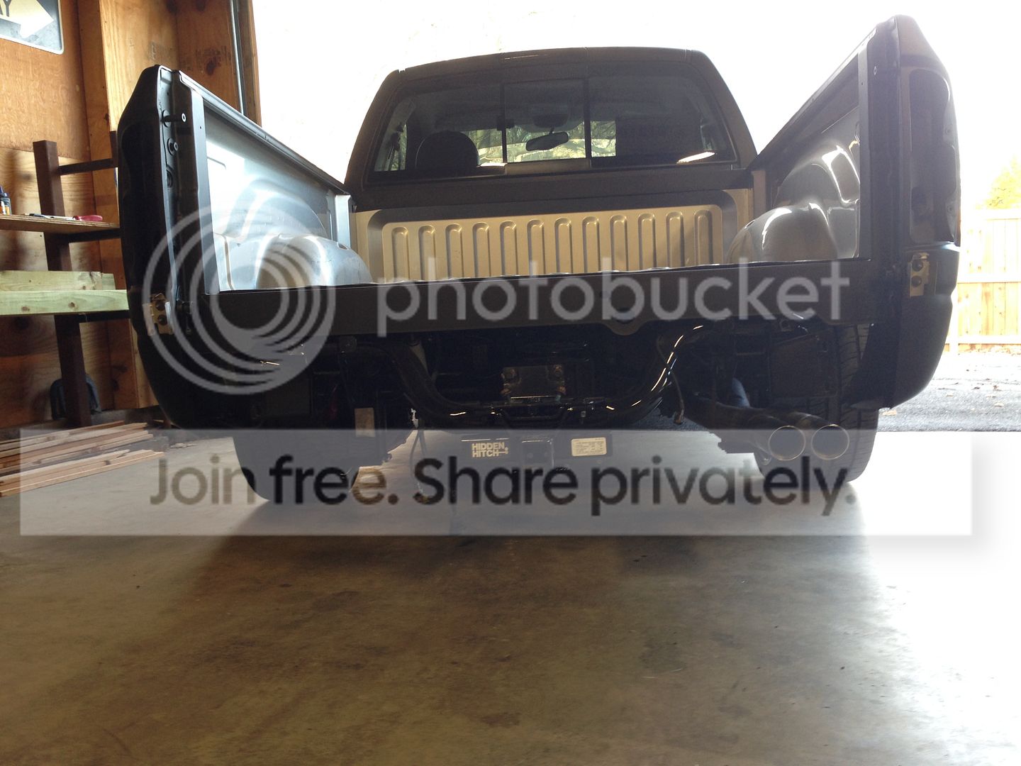

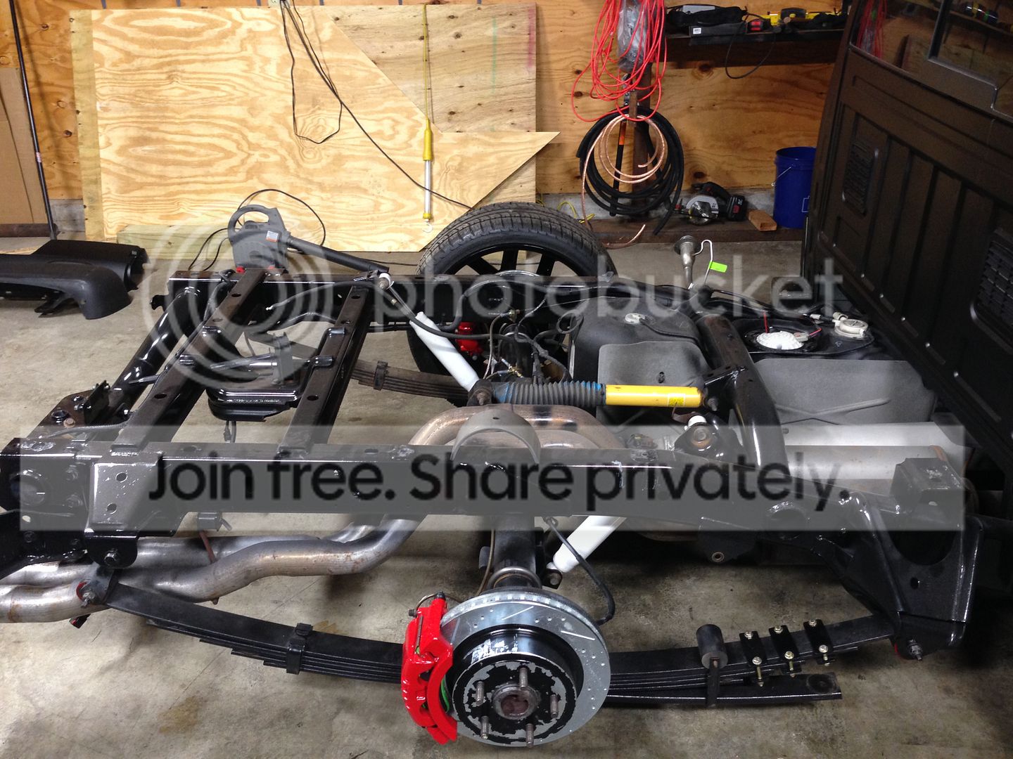

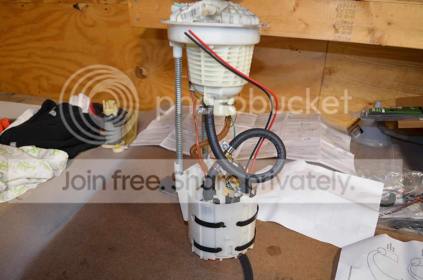

Took the bed off so I could up grade my fuel pump. I got the roe kit, finish the wiring to the battery since it got relocated(jmb kit) behind the passenger rear tire and know I have plenty of room to knock out the C notch.

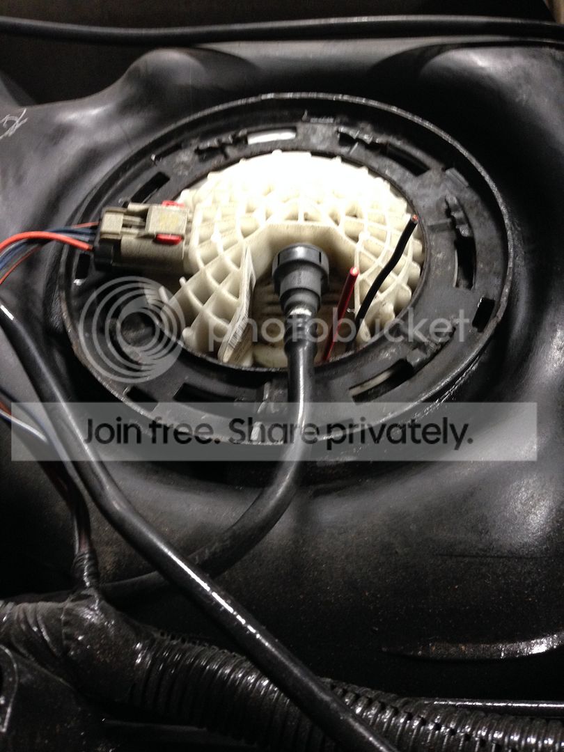

fuel pump connector and line

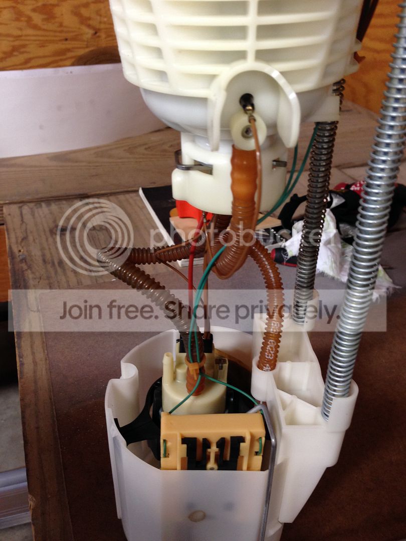

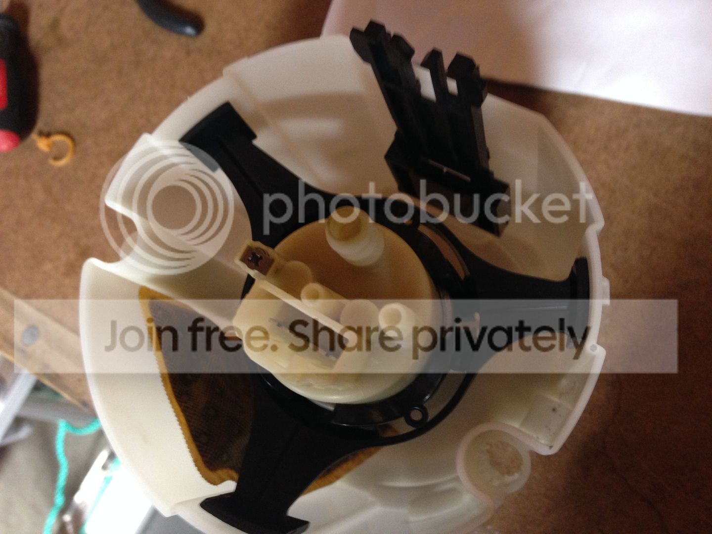

fuel pump assembly before the upgrade

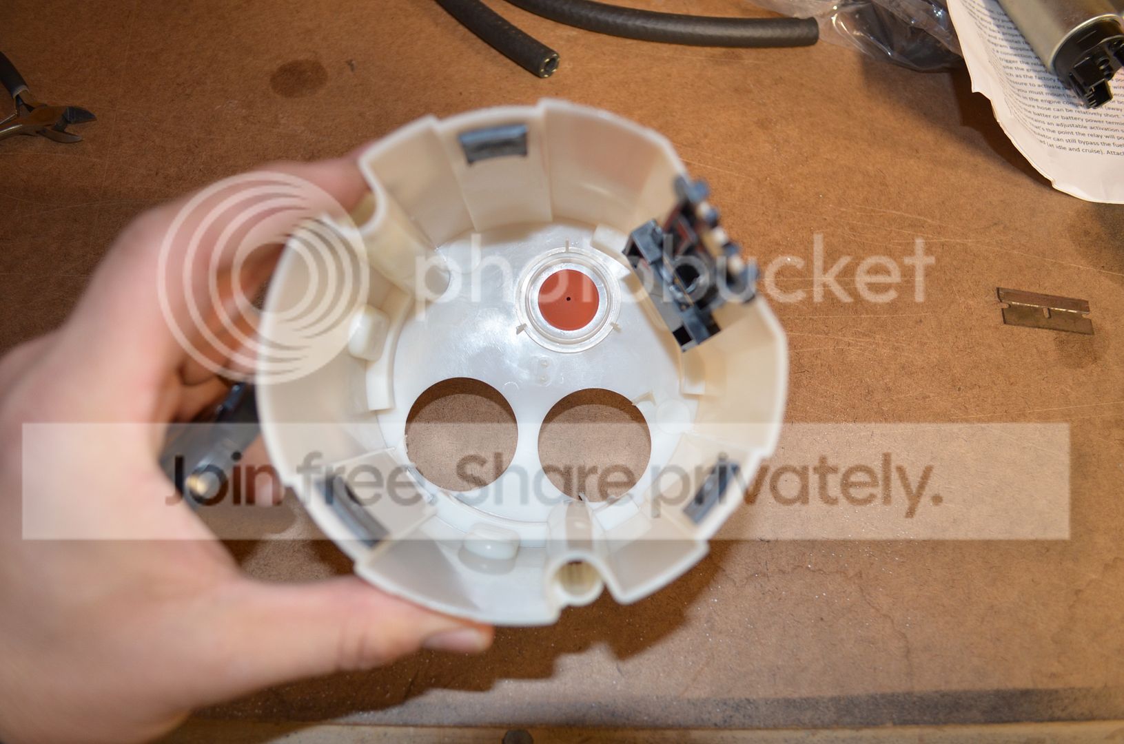

bottom half removed from the upper half of the fuel pump assembly
2 1-1/2" holes drilled in the bottom of the basket so the filters for the Walbro pumps will be on the bottom of the tank
this is how I did mine. I still need to drill to small hole on top to run my 2nd pumps wires through.

Drilled the 2 holes on top of the pump assembly for the 2nd pumps wires and reinstalled the pump in the tank now I just have to do the wiring.
