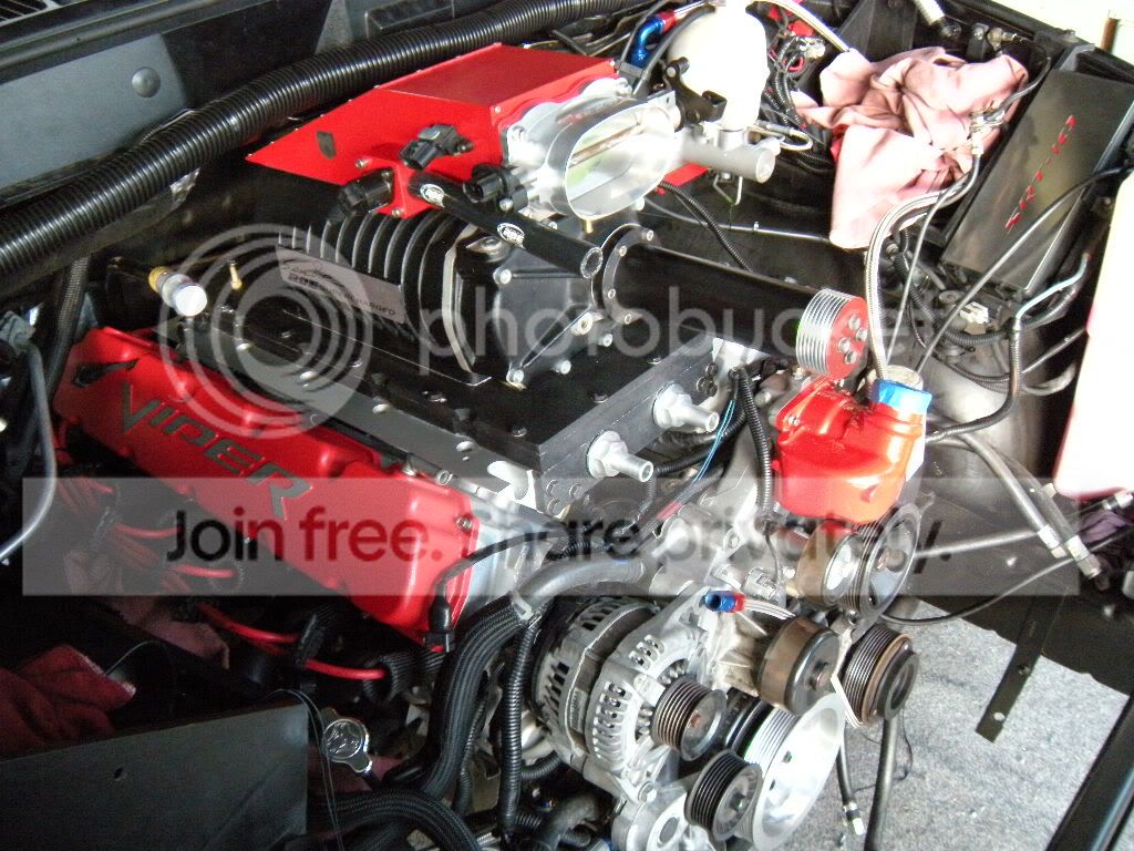

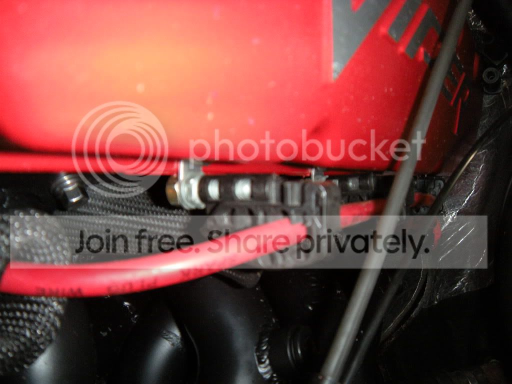

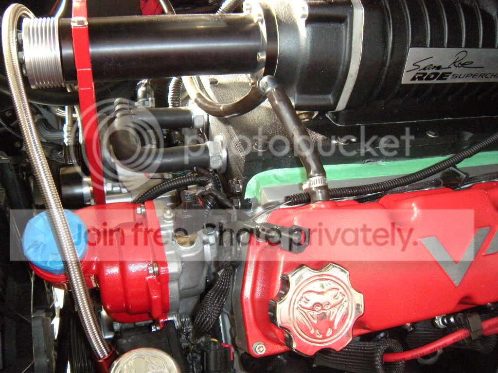

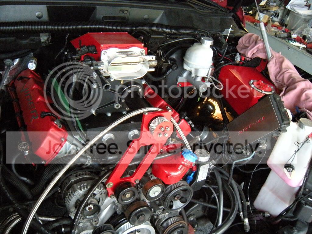

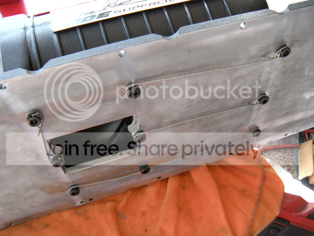

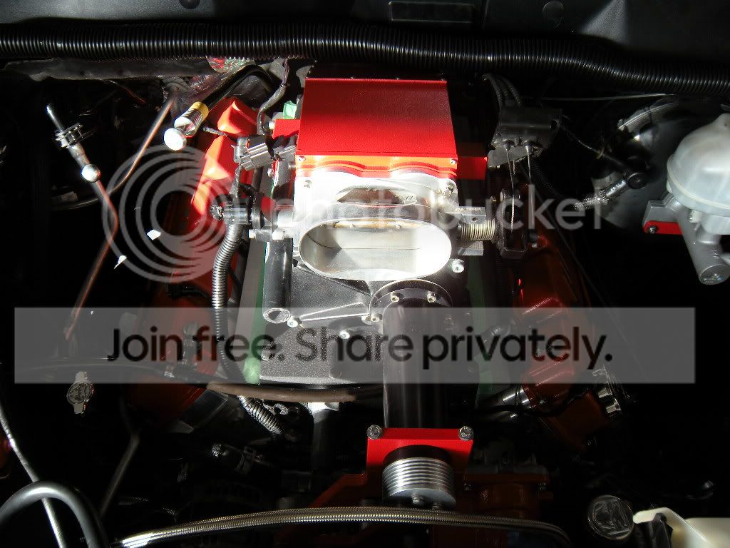

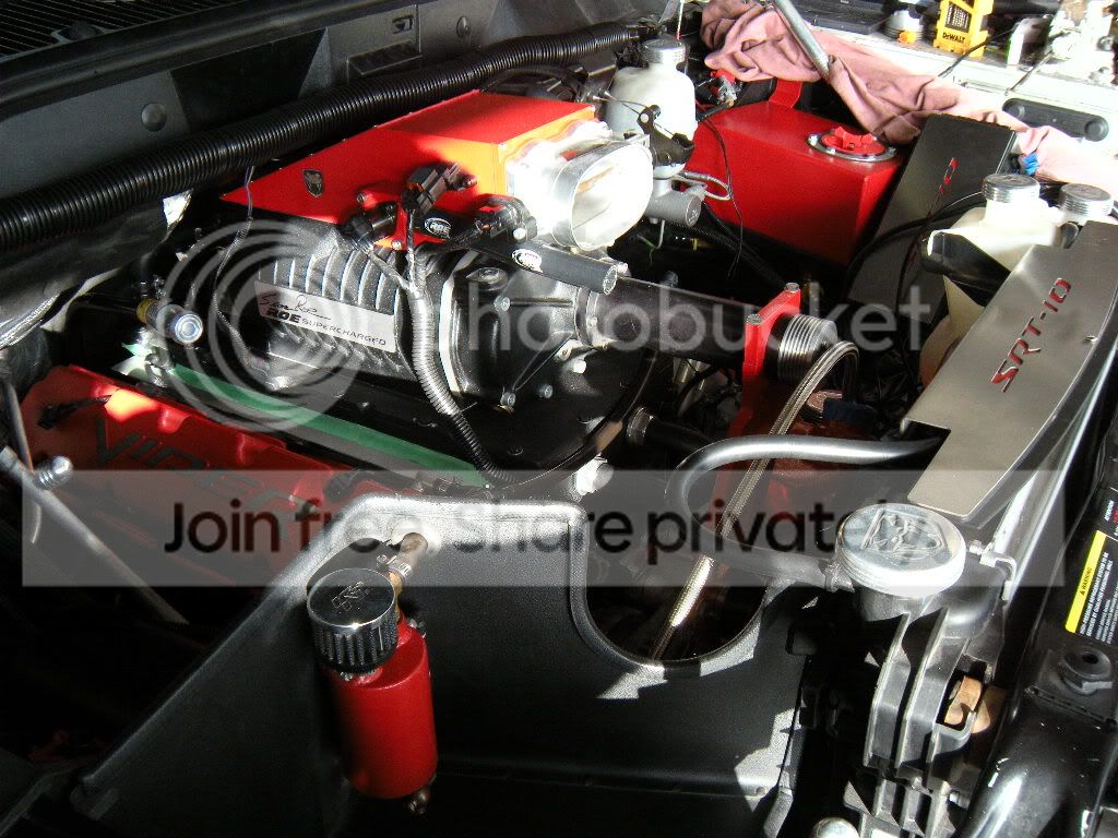

Pics of today's progress in no particular order.

I like the black/red color scheme George........2 questions...the 2 tubes coming out the front of the intake?.......the red box where the battery mounted?
:dito:
Looks great:rock:
Thanks Larry. The two tubes going into the intake are the water inlets to the intercooler. There is an identical piece behind the intake as well. The battery was relocated using Justin's kit and the red box is the reservoir for the heat exchanger/intercooler.
Figured the intercooler....thought the box might be a fuel cell for racing gas....;) ........are you going to have a way measure air temp in the intake and be able to compare to non-intercooled?...
I look forward to seeing the results! I hope to be able to progress some on mine soon as well.......
