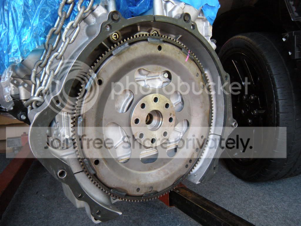

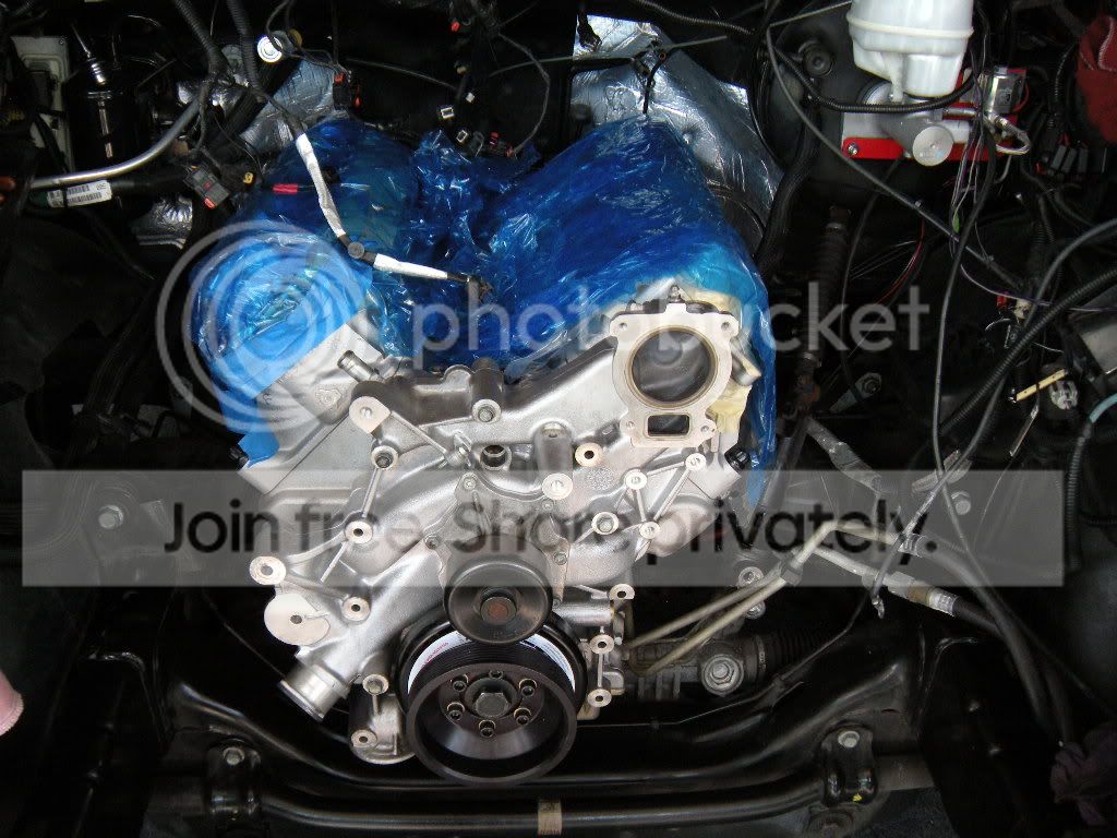

Here is the a pic of the motor arriving at 1qksrt's.

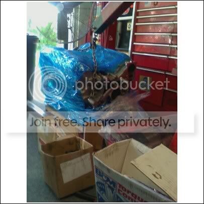

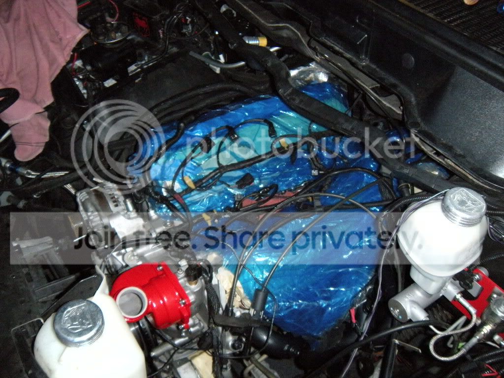

Here is another pic of the motor just waiting for tomorrow.
Looks great. I really like the way you had it made to allow air to pass through the ends as well. Great way to move as many cfm as possible through the aftercooler.
Thanks Robert.
Sooooo George,is the suspense killing you yet ??? :rock: :rock: :rock: :rock:
looks GREAT !!!! :rock: :rock: :rock: :rock: :rock: :rock: :rock:

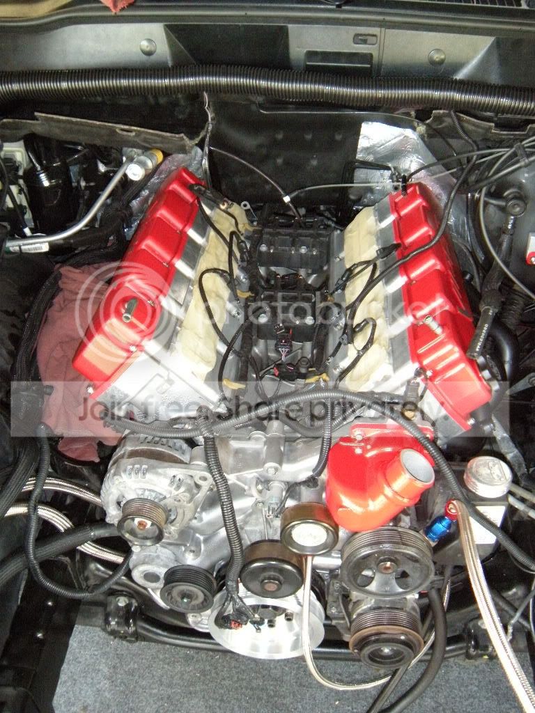

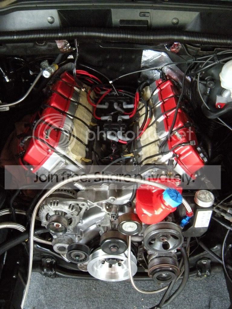

Looks like you got some work done on Sunday :rock:
Yeah. We definitely made progress on Sunday. I figure a couple of more weekends and the build will be wrappred up.
