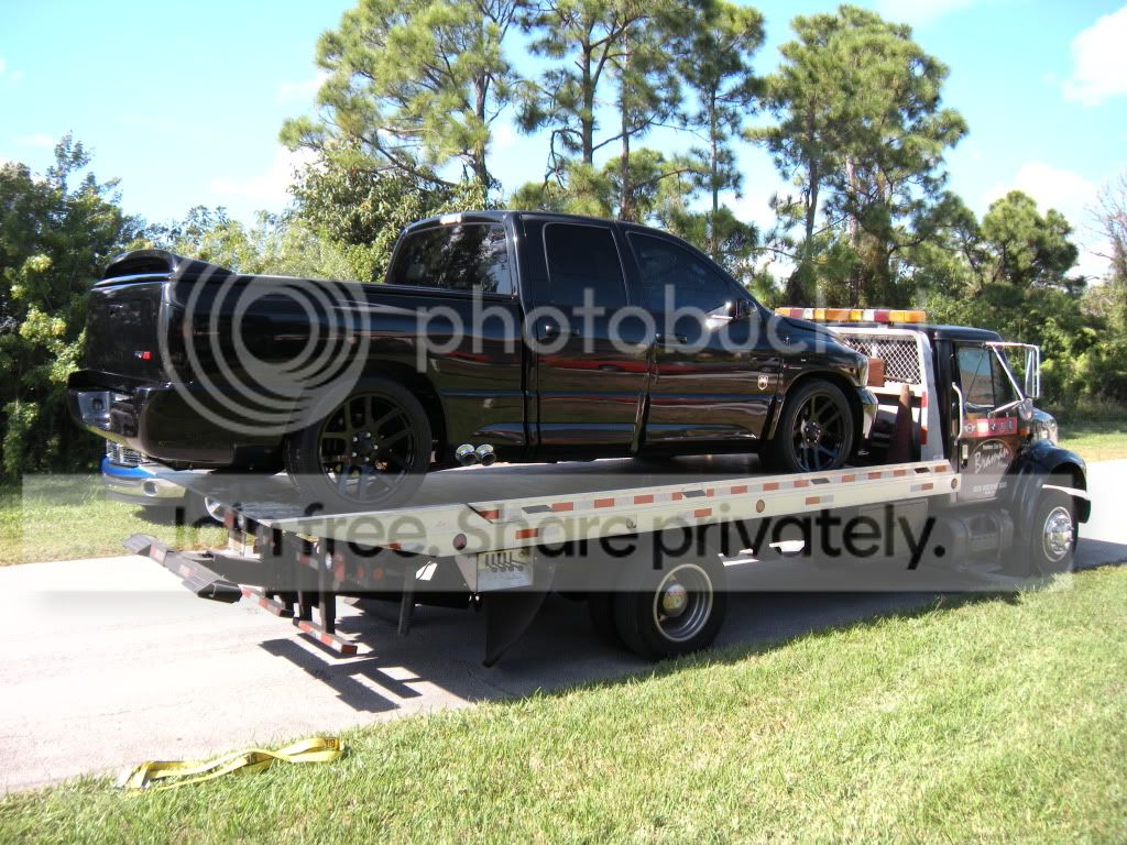

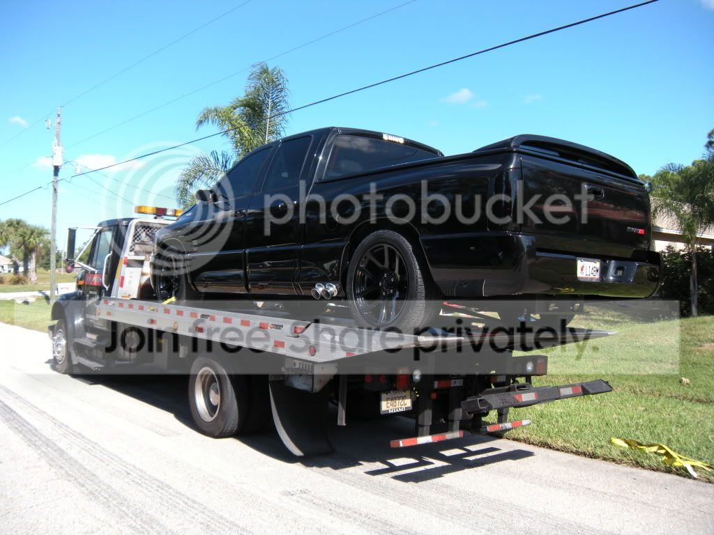

Here are some pics all loaded up and ready for the ride home. I have a few loose ends to finish up, including the tune and the Venom hood. Then it's done.
