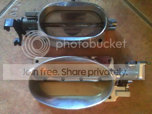

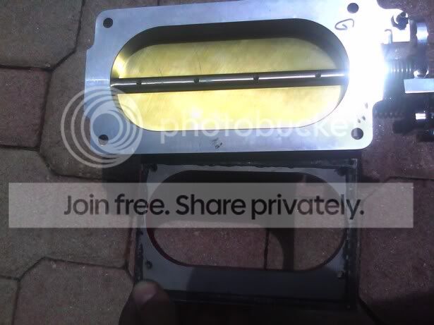

In any event, I've attached some pictures of both the X-Metal T/B and the new Accufab T/B side by side as well as the front plate of the original plenum and the back side of the new T/B for comparison. I'll be shipping everything to Justin tomorrow or Tuesday. The new plenum will be 8 inches wide vs. the original 6 inches to accommodate the massive T/B and the CAI intake tube will be made up of 4.5 inch diameter tubing vs. Justin's original 4 inch.
Hopefully, this will uncork the inlet restriction and make somewhere between 50 to 70 rwhp more. My calculations are based on the fact that each inch of vacuum on the air filter side of the T/B equates to about 25 to 35 rwhp. As 700hpodyssey previously posted, he measured 2 inches of vacuum on the air filter side of the T/B during his tuning session. What I can't confirm is the size of the pulley he was using. I don't think he attepted to spin the S/C as hard as I am but maybe he'll chime and clarify.

The inlet size of the blower is a bit smaller than the throttle body but not by much. My main concern is giving it all the air it can take rather than have it cavitate or create a vacuum out side the throttle body.
would the inlet size on the blower itself still be a bottle neck though?? or is it already larger than the TB
Here is some more information. I took the measurements this morning of the blower inlet and compared it to the new T/B's outlet and here is what I found. The blower inlet is 4 3/4 inches by 4 3/4 inches and the new T/B's outlet is 6 3/4 inches wide by 3 1/2 inches in height.
So now lets compare surface area.
The blower inlet measures 22.56 square inches vs. the T/B's outlet measurement of 23.63 inches. As you can see, they are pretty closely matched. Obviously, having the opening of the T/B outlet larger is always better.
