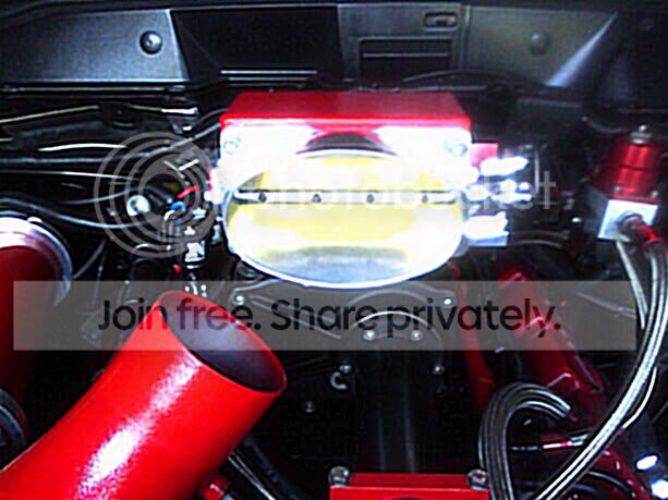

Here are some camera phone pics of today's progress. Some final tweaks tomorrow and it should be good to go.
Thanks. The firewall had to be modified a little. We also had to loosen the cab mount bolts in order to jack up the cab and start the the threads on the back bolts of the plenum. Then we cut down an allen key and tightened the rear bolts using a 1/4 wrench on the allen key. All in all, it went smother than expected.
