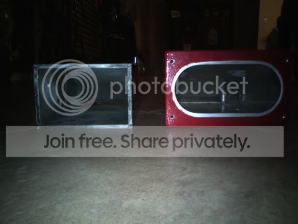

Here are some pics of the redesigned plenum that will fit the massive Accufab throttle body. There was one revision made after these pics were taken to reduce any turbulence. The recesses for the front bolts that secure the plenum to the S/C were removed and I will be using stainless steal pan head allen bolts to secure it from inside the enclosure.
No more vacuum on the filter side of the TB now. Looks like you are on the way to being the first build to unleash the Roe to achieve its greatest potential HP. Sean should be underwriting your R&D. :D

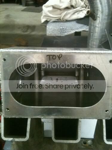

Got the plenum back from Justin. Here are a few pics.
