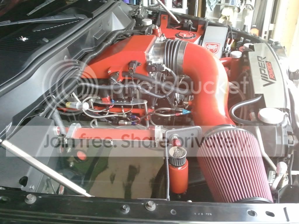

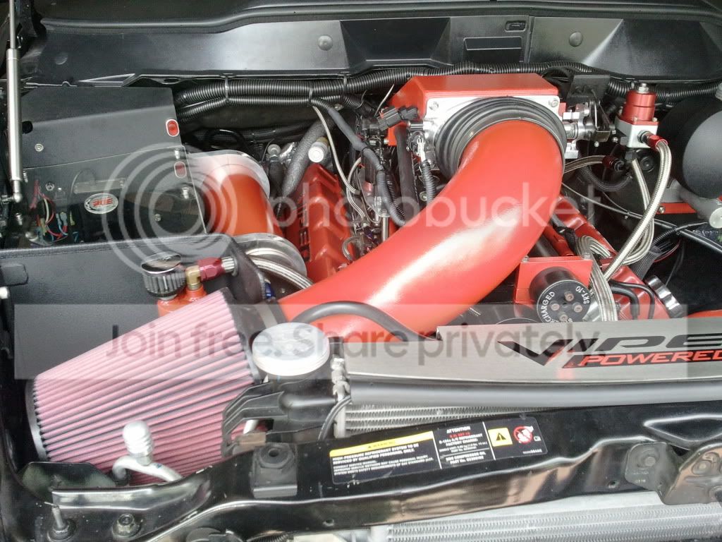

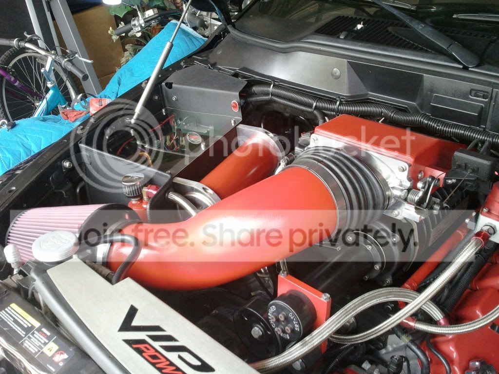

Funny you should ask. I just finished installing the massive 5 inch CAI today. It was made by Justin and the fit is second to none. Tomorrow I will have some race cats installed and then it's finally ready for the final tuning session. Here are a few pics from today's install.

I too hope it crackes the 700hp barrier. I'm actually expecting somewhere in the neighborhood of 800 to 850 rwhp plus the nitrous.

What's the orange tube mounted in the billet bracket on the passenger side?
It made 678 rwhp at 3700 rpms before the boost starting falling off. That's why I had a larger plenum made, went with a huge Accufab throttle body that flows 2100 cfms, and Justin made me a 5 inch CAI. The blower was choked. Everything is finished and installed. They only thing pending is to retune it.
