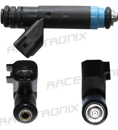

Siemens (Continental) Deka IV injectors
Flows:
95.6 lb/hr @ 58 psi
84.3 lb/hr @ 43.5 psi
Sold as 80 lb injectors
Scaled the injectors with the VEC 3. Started right up and no idle issues so far.
Item Code: FI114991 Weight: 43.00GM Brands: DEKA Manufacturers : Siemens (Continental) Stock: Yes Model: LU108 Categories: Fuel Injectors - High Impedance Retail P/N: 109991 Manufacturer P/N: FI114991 Static Flow lb/hr (n-Heptane): 80 Static Flow cc/min: 875 Dynamic Flow (mg/pulse): 18.6 Coil Resistance Ohms: 12.0 Spray Pattern: Pencil Series: DEKA 4 Connector Type: USCAR O-ring Type: Viton E85 Compatible: Yes Methanol Compatible: Yes Weight (non-shipping): 40.2 grams

Those injectors were a little under rated and should flow some fuel!!:rock: How much boost do you plan on running with them and are you adding NOS too?
13 psi.
Yes, NOS, already added.
I bought those same injectors :rock:
That's a lot of injector Bone. The good news is that you haven't lost idle quality. I'm using the 65lbs injectors rated at 43.5 psi with 2 fuel pumps and the fuel pressure set at 60psi. I haven't ran out of fuel yet. What are your plans?
