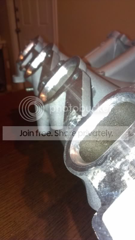

Cleaned up my pistons
i could of grinded the bump down some more, but felt it would make no difference
Slowly coming together
You will want to continue grinding up inside each of the Intake ports, a lot farther than that...:top:
If he doesn't grind further into the ports is it still an improvement over stock?
What you don't want to do is port a manifold so it becomes larger than the Intake Port of the head.
You want to make the manifold port the same size as the head's Intake Port, all the way up the runner.
I know what RamV10's application is in this case, so in answer to your question: NO, porting as shown in the photos would not be an improvement over stock.
It is my understanding he is working with a spare Intake Manifold so you would have to ask him what his final plans are as I believe it to be a work in progress..
Ronnie
