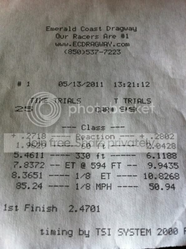

i'll post up details later... but a few grand for 5 tenths is not bad, IMO;) my previous best at this track was 8.86 with only maggie catback, rear cat delete and k/n intake...
this is full weight, street tires with full pressure...
