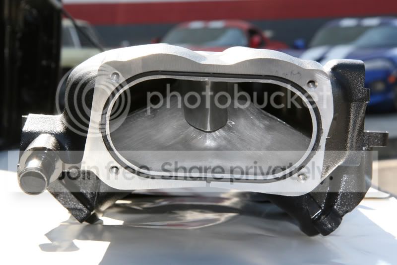

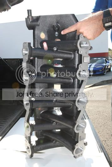

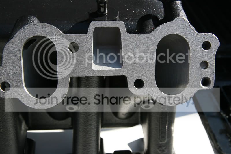

Here are photos of the comparison between the factory intake and the ported intake with a "diffuser " added. Also shown is the thermal coating on the mounting surface, which acts as a barrier to heat transfer.
This last photo shows the mounting bolt for the diffuser, bottom of intake.

This is Trainman speaking, but I am at SRTBrad's house and using his computer.
Form and Function Performance was going to extrude hone the intake, which is what I had asked for through Dan at DC Performance. After consideration about the extrude hone process Form and Function decided to do a full port job, plus some reforming and epoxy shaping inside. As far as I can tell the manifold was NOT cut open. The guy at Form and Function is really into this process and he expects some good gains so he did this porting to test the results for our trucks, Dan also suggested the diffuser and the guy at Form and function hand formed this original prototype....The results should be interesting. The diffuser was mounted by DC Performance. If this shows a good gain, the diffuser may be sold as a seperate piece which requires a mounting hole to be drilled from the bottom and is secured by a single bolt, see the last photo.
