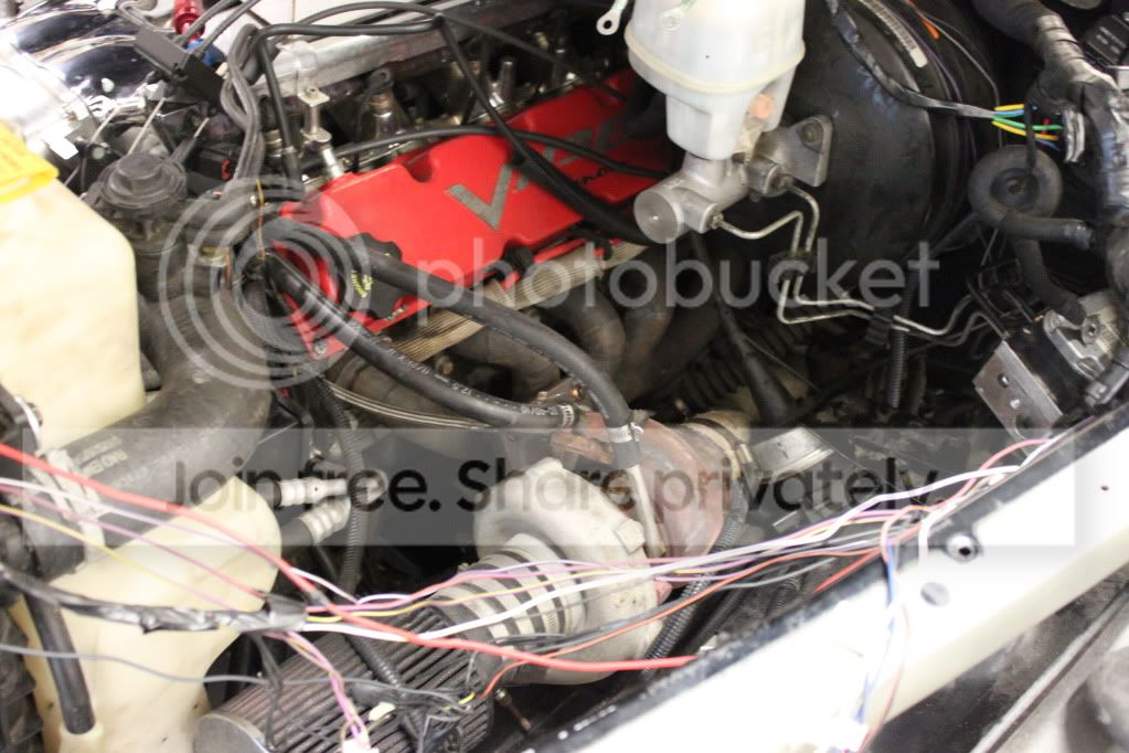

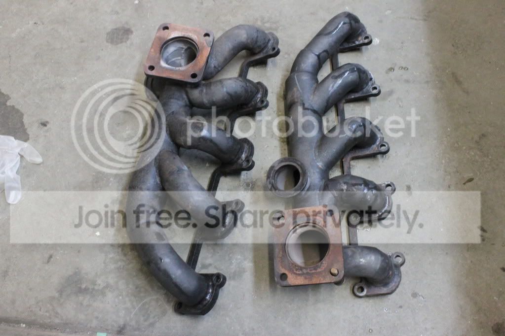

here all the AMAZING manifolds Hennessey made (Im not one to talk bad about other shops so ill let the pictures do the talking) i will say one thing though. (GARBAGE METAL MATERIAL) these things wont even make good paper weights. (keep in mind these pictures were taken after we removed most of the stuff inthe bay. imagine it before)

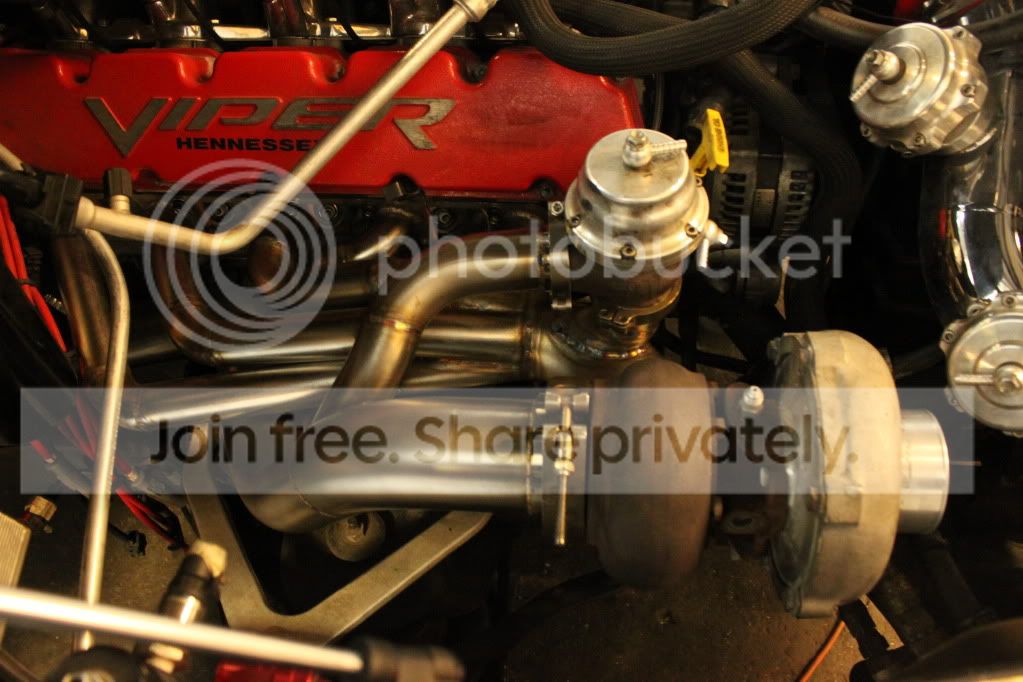

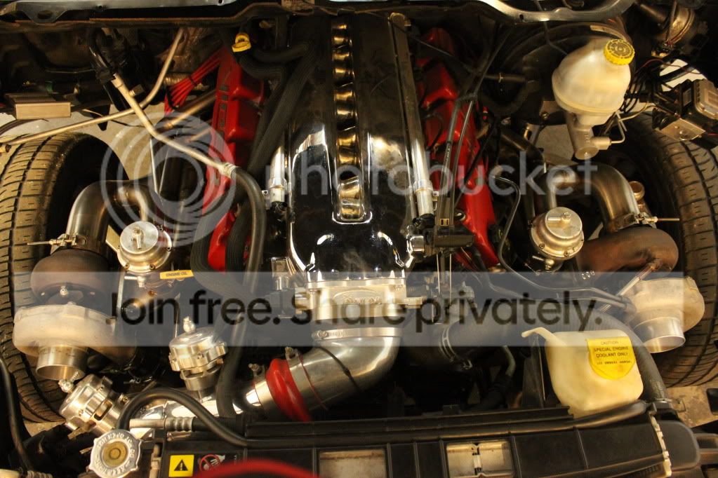

we decided to go with a side scroll style manifold, with 5-1 merge collectors and with turbos and wastegates mounted up high this truck wont only haul, but it will be stylish too. with all the trucks turbo gems up top and shiny. with everything assembled with ARP hardware and vbands for the wastegates!
The results:
This truck will no doubt make much more power, the power cure will be more linear, not only that but the customer wont have the same issues as he did before with the manifolds sagging and almost glowing red hot at idle!

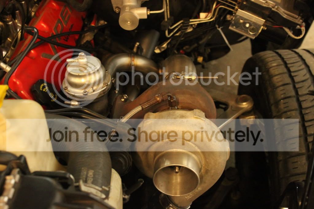

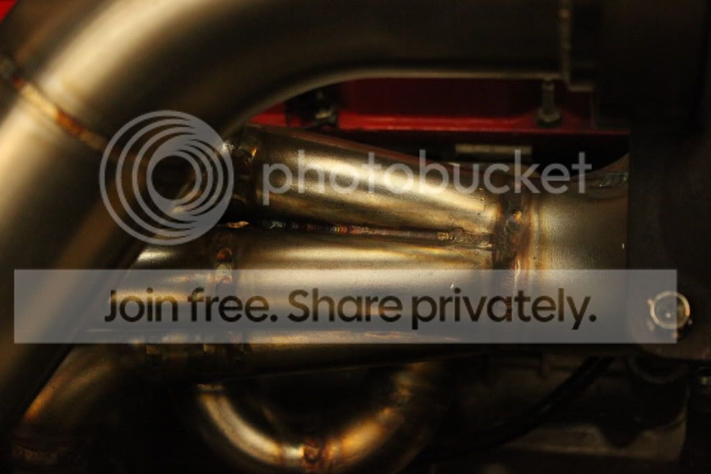

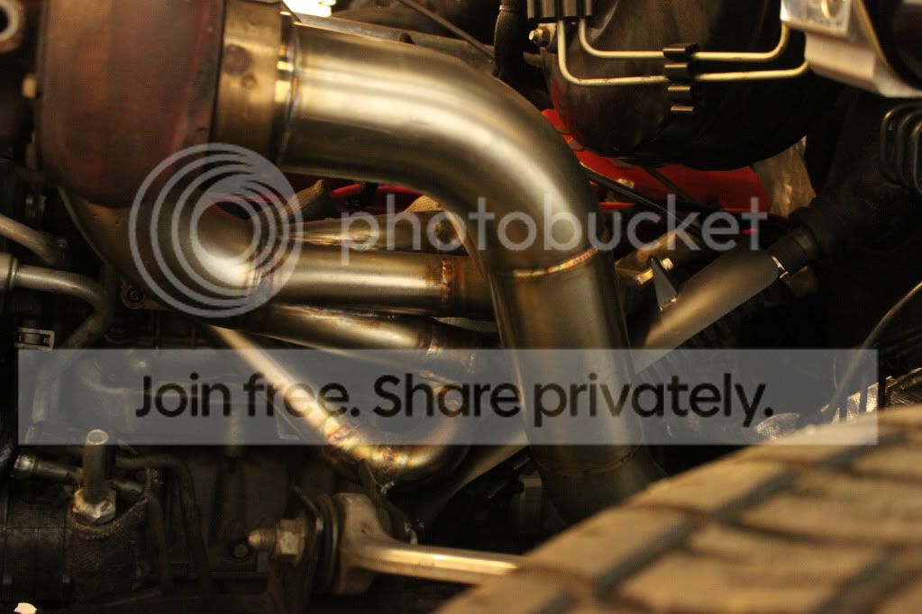

The 5-1 collectors

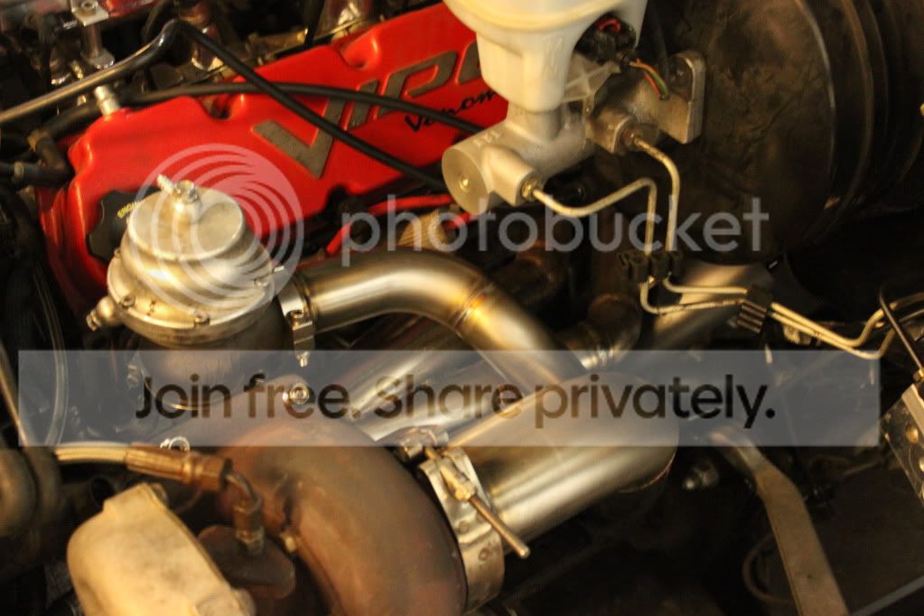

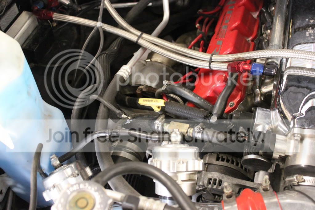

The new wastegate placment up high, and stylish (this will also keep running the vaccum lines much eaiser and out of the heat from the manifolds, as well as road grime, Which you can see these things will need to be plished up a bit due to there old placment (cough) Also have the wastegates recurculating back into the down pipes for that nice clean look and keep noises down.

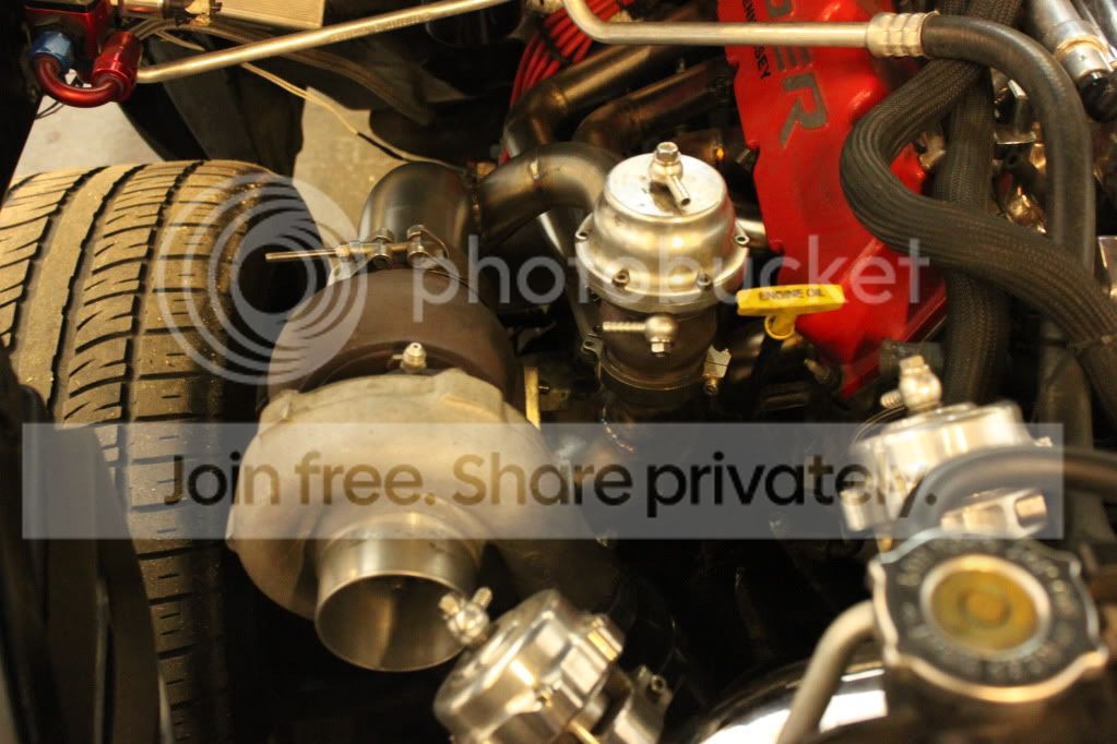

Turbo placment is now higher in the the bay like we talked about before. The intercooler piping, water lines, oil lines, will now be able to be routed with ease. it also keeps the turbos up and away from the residual heat coming from the Manifolds. as well as road grime and stuff of that nature.

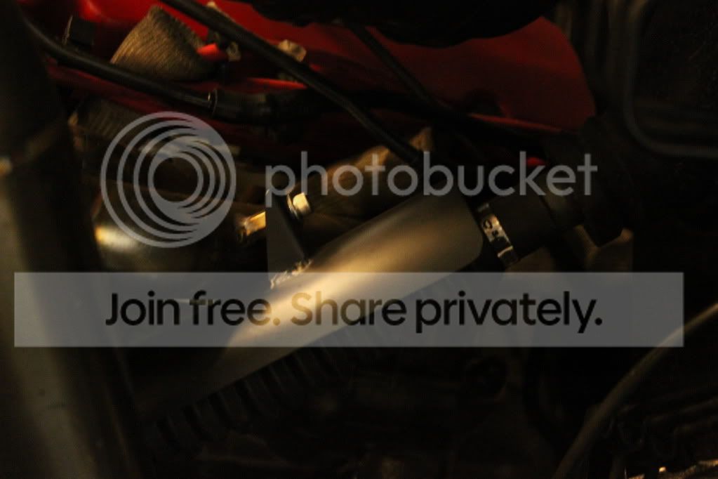

One small thing is heat sheild for the steering shaft, we dont want that to get to hot.

Nice clean look. When I bought mine I had the same exact set up from H but my wires ect did not look like your trucks when u first got it. Mine were tucked and neatly done. Looks like whoever owned your truck before really beat the crap out of it. Looks really good now. Looks almost exactly like mine after I re did it. Nice work
