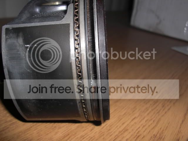

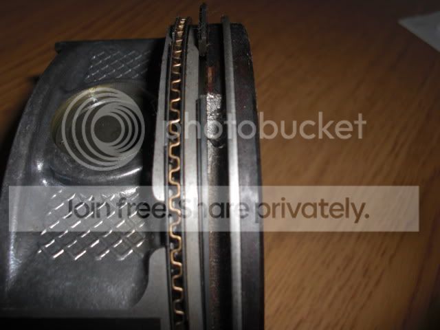

but mine at 5psi let go, now I know boost is supposed to be boost, but mine had 5k miles on it when we installed the turbos, and it never made the third pass on the dyno.
so myself, I want install a turbo system on a non forged engine, period, too much liability, can it be done? probably so, but i jsut dont suggest it, heck even some of the paxtons an roes have had probs with low boost, profs was brreaking up with very little boost , but he caught it in time.'

Prbolem with that is you may window the block and set yourself back another $3-4k for a used block

I aint saying it cant or you shouldnt scooby, but man I jsut dont want to see anyone go thru what I did, started out at 10k jsut for the system, after 20k more i got my truck back:argh:
ask nycsteve ask me ask anyone. you love your truck right, anything over 5psi without bein forged is asking for it. and if its 700hp your looking for you gonna have to do it,
