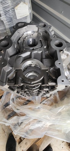

Any determination why this happened !
Are any other rods bent Or bearings wiped ?
Shit pistons. The rings are too close to the top and break out. Supposedly good at 650hp with a supercharger or 700hp for street use. Yeah na no way. I would say this is the second time it has happened in this truck.

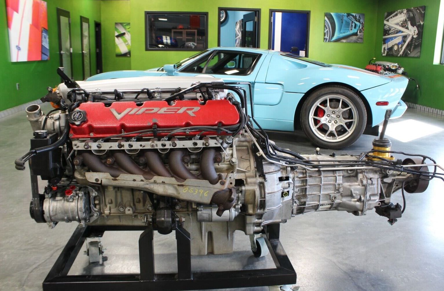

Gen IV Viper engines use (2) drive-by-wire throttle bodies (not compatible with your ECU), different Intake and Exhaust manifold spacing and the Gen IV Heads wont directly bolt onto a Gen III Block.
You CAN get just about anything to work with anything else, with enough time and money.
The Gen III engines have some minor differences. If you find a Gen III from a Quad-Cab (that used 2 Knock-Sensors under the Intake Manifold), that isn’t a deal breaker. The Crank-Position sensor is in a different place on the Quad-Cabs (with an automatic) than it is on a regular cab. That isn’t a deal breaker either.
The simplest/cheapest solution is a Gen III engine from a Regular Cab (high-miler’ or not) you can rebuild properly to last a LONG time.
A block and crank is all you really need but may be harder to source.
