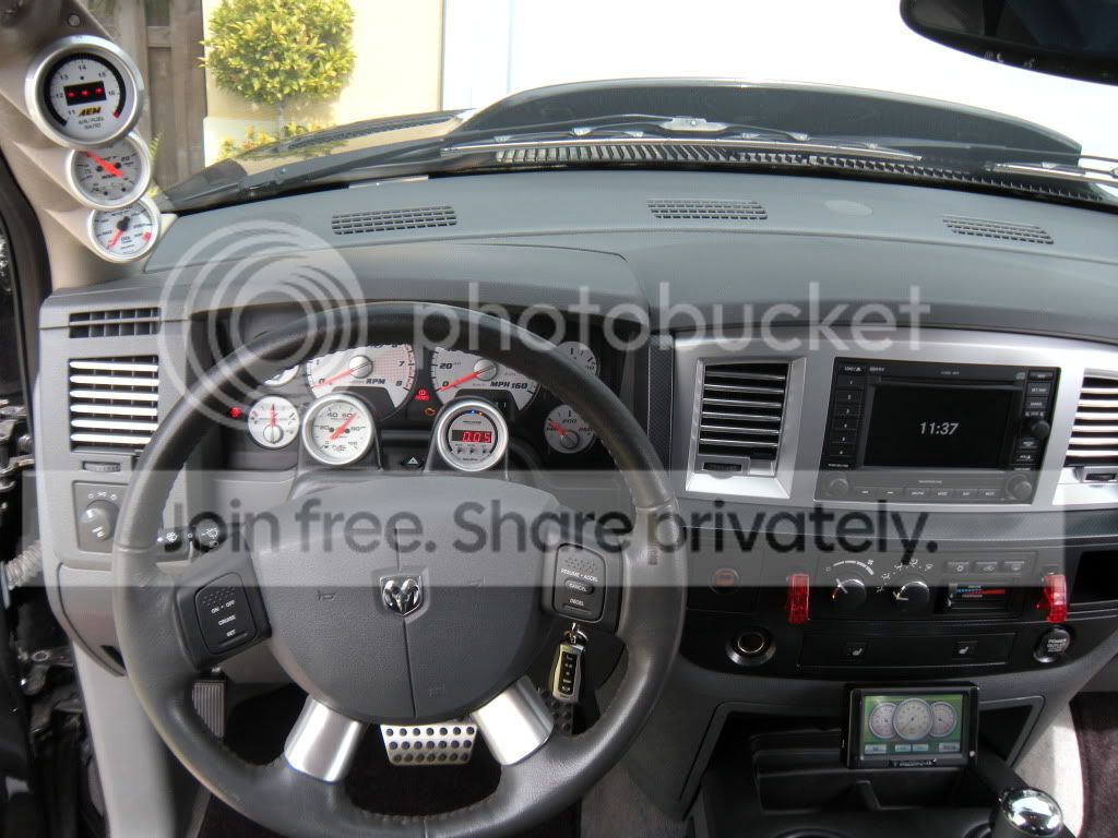

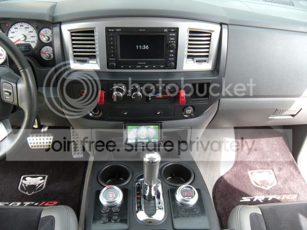

Here are the pics of the setup. Not quite done but you can get an idea. The 6 Innovate LC1s and 2 Autometer widebands will be hooked up to the Dashdaq. I will be moving the two gauges from the steering column pod and mounting the Autometer widebands there. My day got cut short so I will be finishing the install next weekend.

blackviper said:
It will log them but the stock O2s will only give you voltage as a measurement. They will not give you AFR.
Maybe I am mistaken, but isn't that what the AEM sends out on its logging wire? Voltage? (I just looked it up. The AEM has a white wire for voltage and a blue wire for seial.
Will the DashDaq not interpret the 0-5 volt signal?
Thanks for sharing this info with me. I am looking very hard at copying this part of your install.
After my research and all the questions I asked, the Dashdaq will not interpret the output of the stock O2s. I believe it's something to do with them being narrow bands. If it were possible, you would need the factory O2 scale to program it correctly. This is why I'm using the Autometer widebands to average out the banks. Autometer uses a 0 to 4 volt signal and they provide the scale to program the Dashdaq for its interpretation.

Is that shifter a detent shifter?
