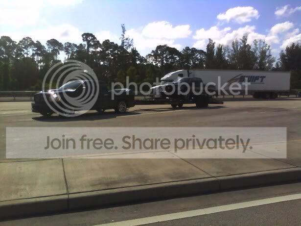

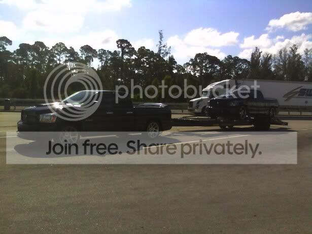

Here are some pics from last Saturday's dyno day. More to come this Wednesday.
