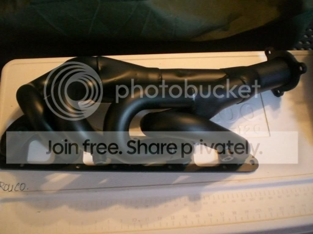

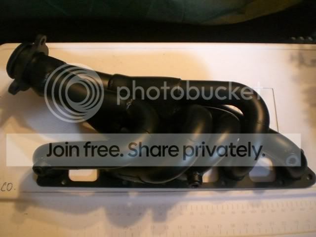

Here are some pics of the black ceramic coated bassani's with the wideband bungs installed on the first, middle and last cylinders. The install should start next week.
Alright! My mouth is starting to get a little dry, and I feel a twitch in the corner of my eye...this should be a great build...we have three or four underway...this could be an awesome spring with new thunder on the roads!
Black ceramic...Just what I was thinking about doing George!!:rock: :rock: ............can you eleborate on the mutiple bungs?...
The multiple bungs are to tune the each cylinder individually.
The bungs are located on the critical cylinders and the remaing ones can be averaged.
The bungs were placed on the critical cylinders, the rest can be averaged.
